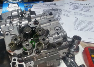

I had some success last week with repairing the solenoids on the AW 55-50SN gearbox as fitted to the 2002 AWD S60.
To say it was a nerve racking experience is an understatement. TOTAL concentration is required and no interruptions while working if this isn’t your forte and you’re a first timer. The car was at my MILs and she was away at the time so I had uninterrupted time on the project.
Dropping the subframe wasn’t that difficult. I used the procedure from the repair database on Matthews. Hardest part was refitting one bolt for the trans line and dipstick which would have been a cinch if I’d removed the clamp on the hose going to the intercooler from the throttle body.
2002 S60 AWD AW 55-50SN Solenoid refurb-it worked
