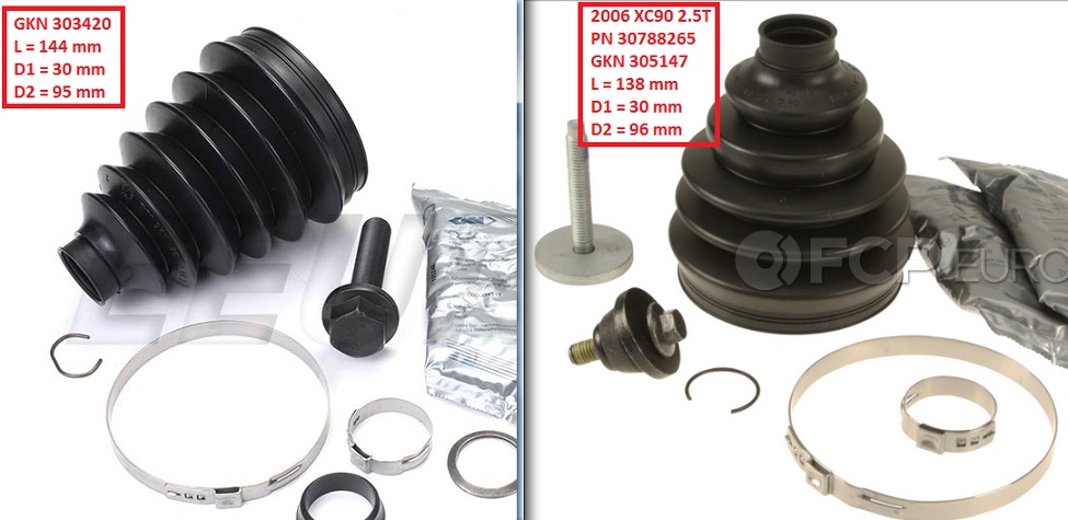

Just looked at GKN 31256231 or 303420, the dimensions are:
- Total of 6 ridges
- L = 144 mm
- Small end diameter = 30 mm
- Large end diameter = 95 mm
The plastic thingy scares me b/c the larger diameter lip (96 mm) has a little ridge, and being plastic, it can be "slippery". Now I understand that if people don't apply the Oetiker clamp tight enough, it comes out spilling grease! The jury is still out for plastic.
If you find another GKN (for another car such as VW or Audi) with similar dimensions and is rubber, please post.

I was looking at 2004-2006 XC90 2.5T Outer CV Boot, from what I researched:
- It is still made from rubber.
- The dimensions for XC90 (right in the photo, dimensions are not certain, I got the dimensions from some websites...) are very close to the S60, V70 (left in the photo).
I personally think XC90 CV Rubber Boot should fit the S60/V70.
- Can someone call FCP to see if they can get one of each and physically measure them for us, and post their measurements?
