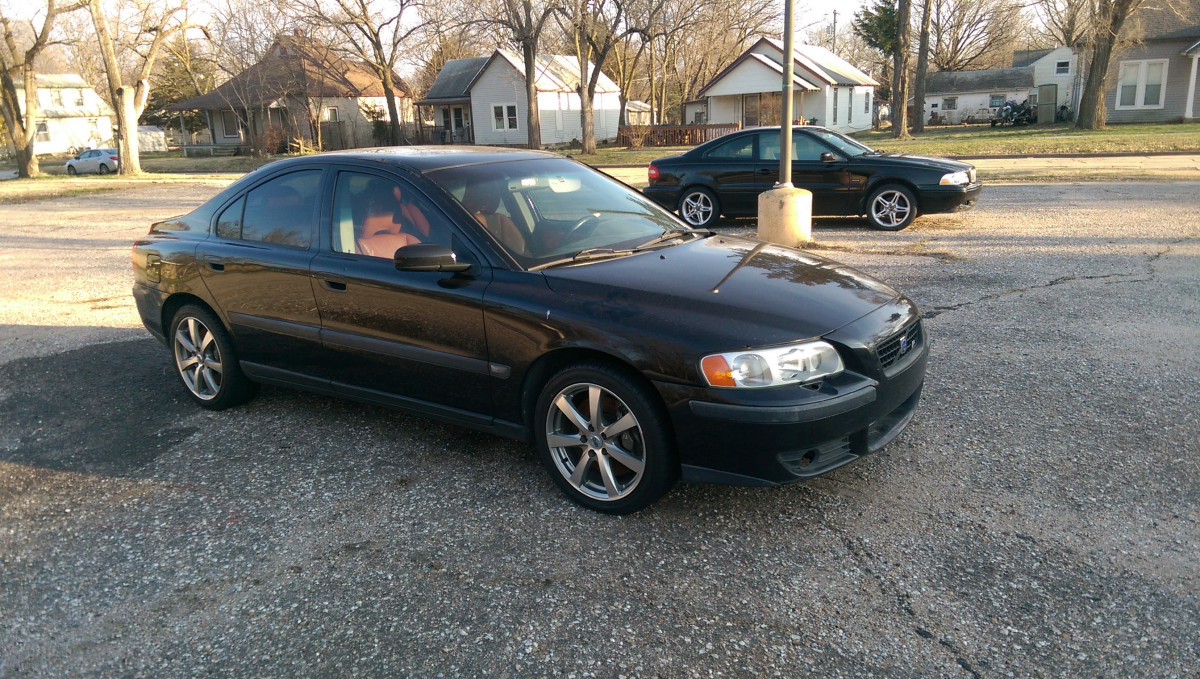

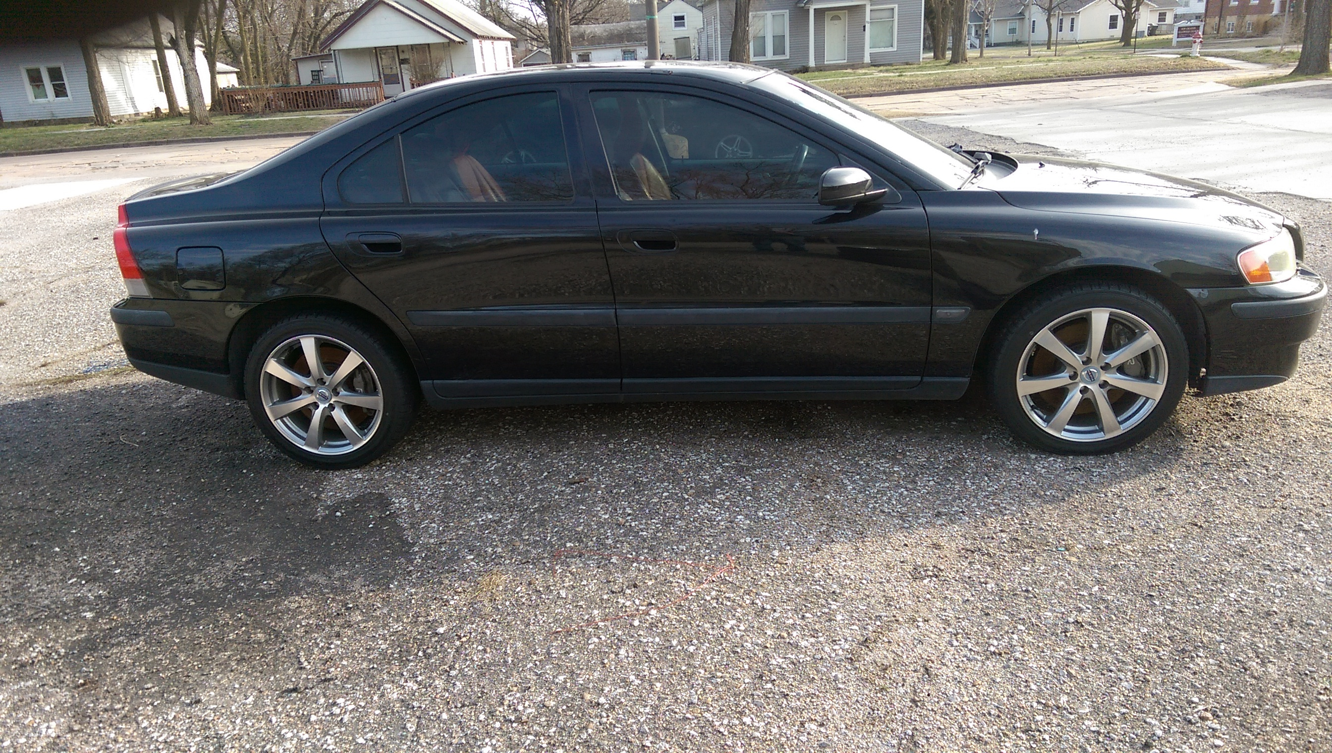

Found me a $250.00 solution on Craigslist ... Full set of tires and wheels.
Wheels: Kosei E3 Sports Edition. Alloy wheels
Tires: Falken Ziex ZE950 225/45R17 94W.
Clearance between wheel spokes and top of caliper ~10MM.
Side of caliper clearance 20 - 25mm.
