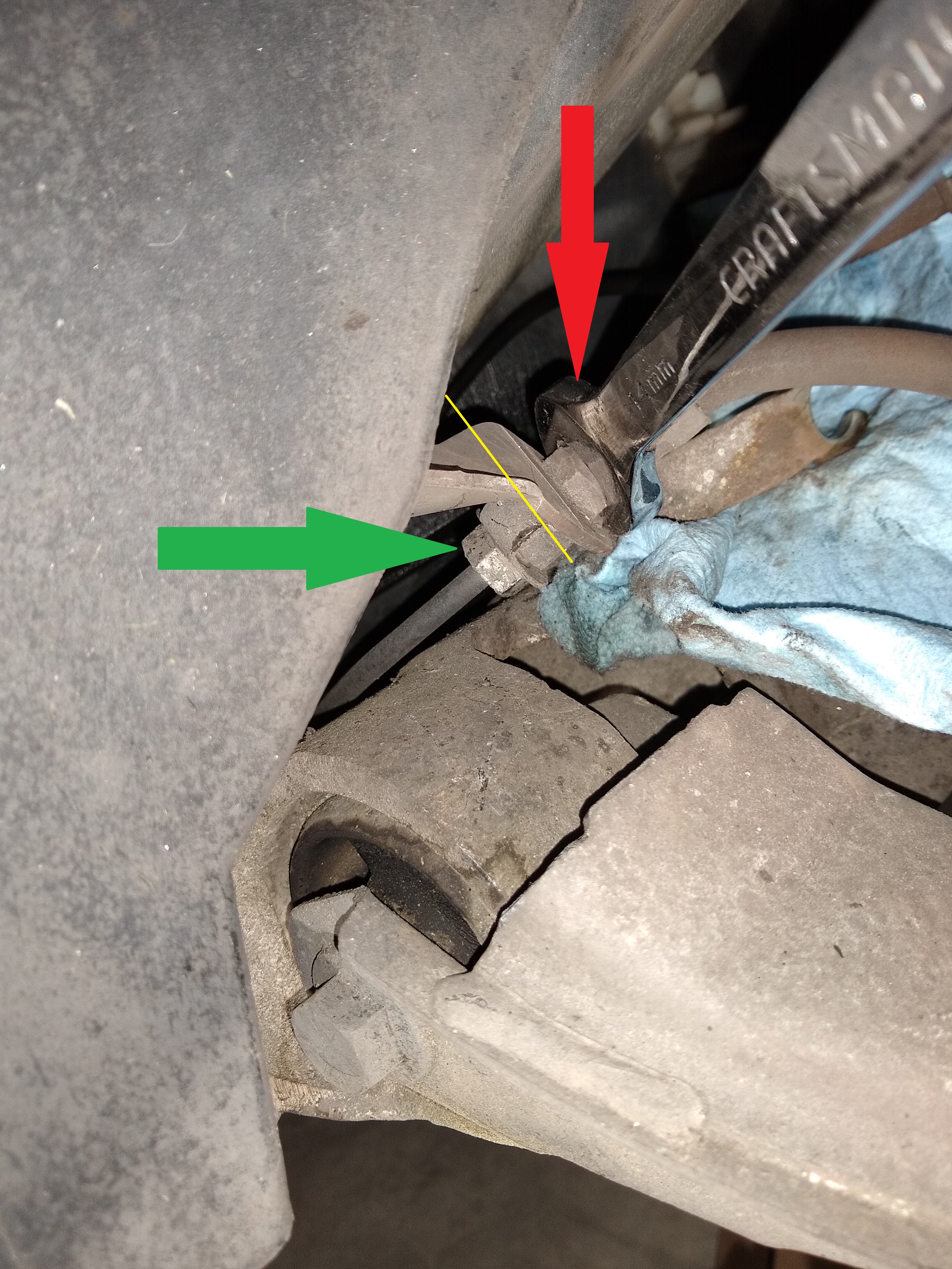

Georgeandkira wrote: 07 Apr 2020, 09:05 What made the rears difficult? Is there room for tools?

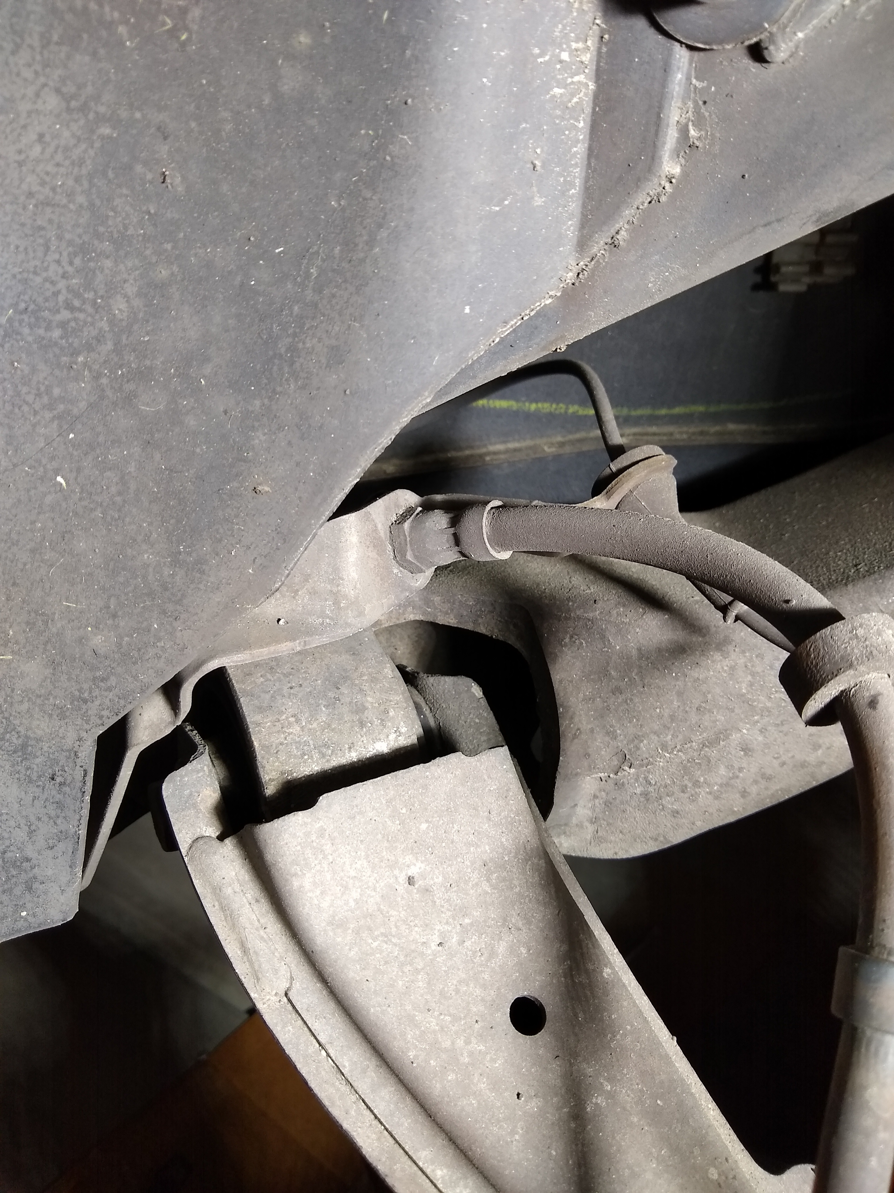

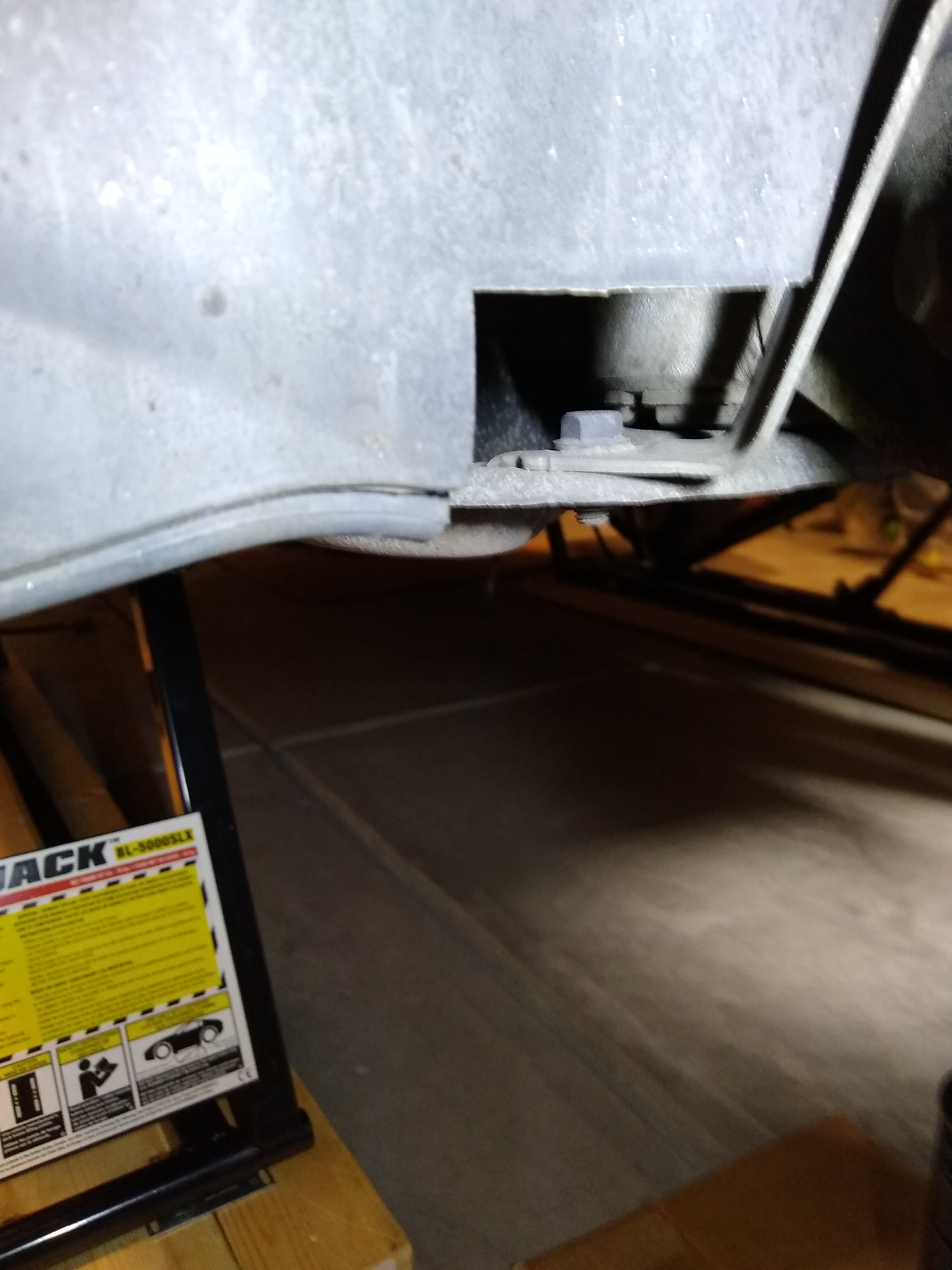

Barely any room and you'll need to remove the bracket bolt to provide more room. The (Yellow Line) is the space you have to work with. You'll need to flip over your open end wrench after each small turn on the fine threaded nut. Use a Crowfoot to loosen nut (Green Arrow) on brake line while holding the brake hose end (Red Arrow).
(TIP) If you are sure you have the right hoses cut at each end and hold it with a pair of ViseGrips while loosening the brake line's nut. Use the rubber Bleeder Screw Cap and put over the Brake Line End after disconnecting it. I was going to bleed the entire system so thought I just let it drain.
1) Image of Passenger Rear Hose
2) Image of Passenger Rear Hose Bracket Bolt
3) Red Arrow - Hose end does not turn

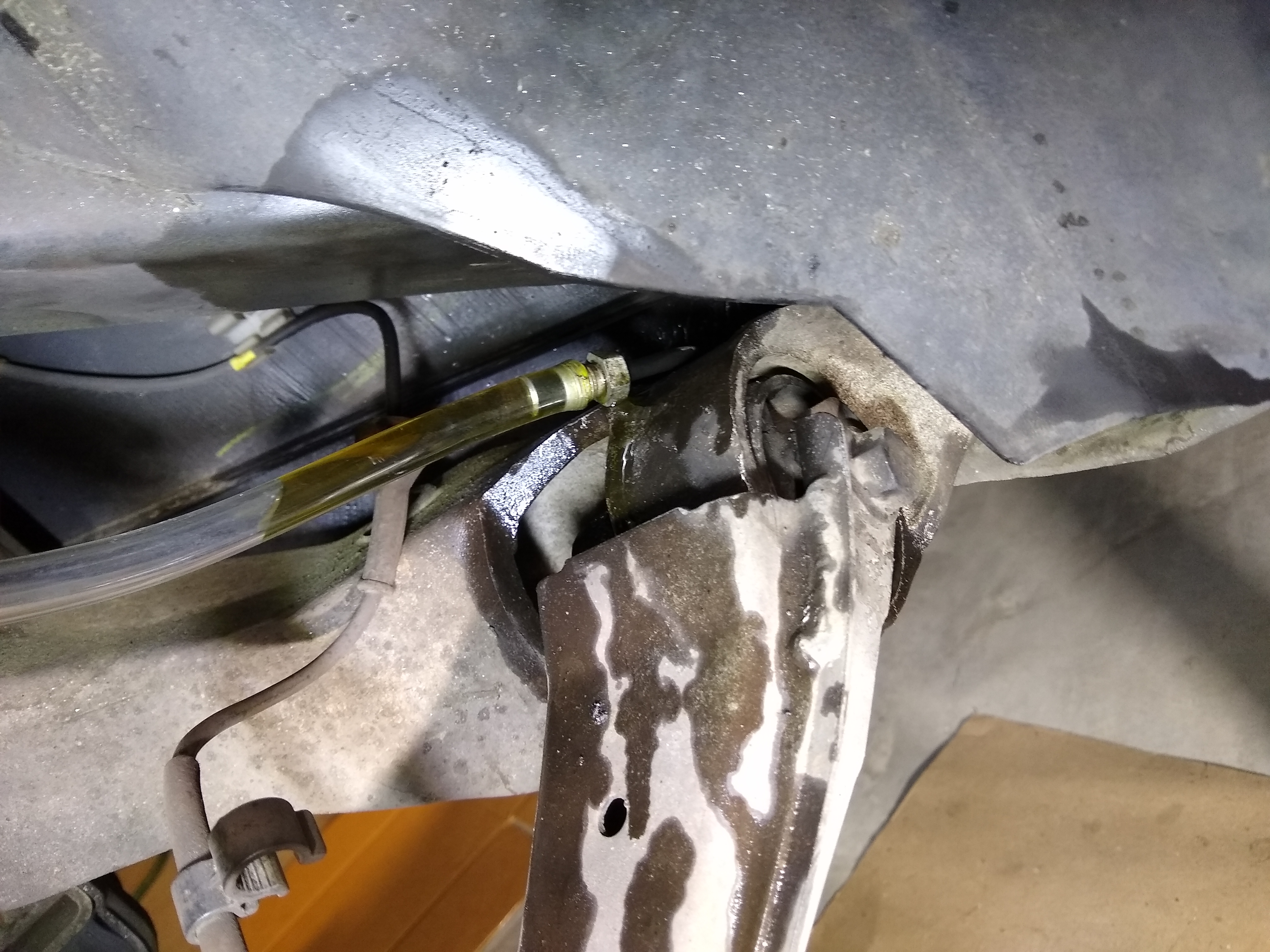

4) Image of Driver Side Rear Hose Leaking During Disconnection

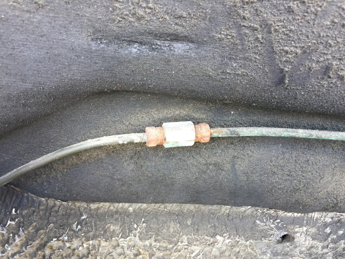

It’s fine to splice brake lines, just add an inspection protocol to your car maintenance.
Daily for a week.
Weekly for a month
Then every six months
You can also simply monitor the brake fluid reservoir for loss. There should be none.

abscate wrote: 08 Apr 2020, 04:57 It’s fine to splice brake lines, just add an inspection protocol to your car maintenance.
I have to disagree with brake line spicing. Perhaps you were joking.
Posts: 35320
Has thanked: 1507 times
Been thanked: 3824 times
Errrrr....
Maximum working pressure of an auto brake system is under 2000psi
An SAE union will have a working rating of 5000 psi, and a minimum burst of 20,000 psi
All fine as long as workmanship is to standard.
