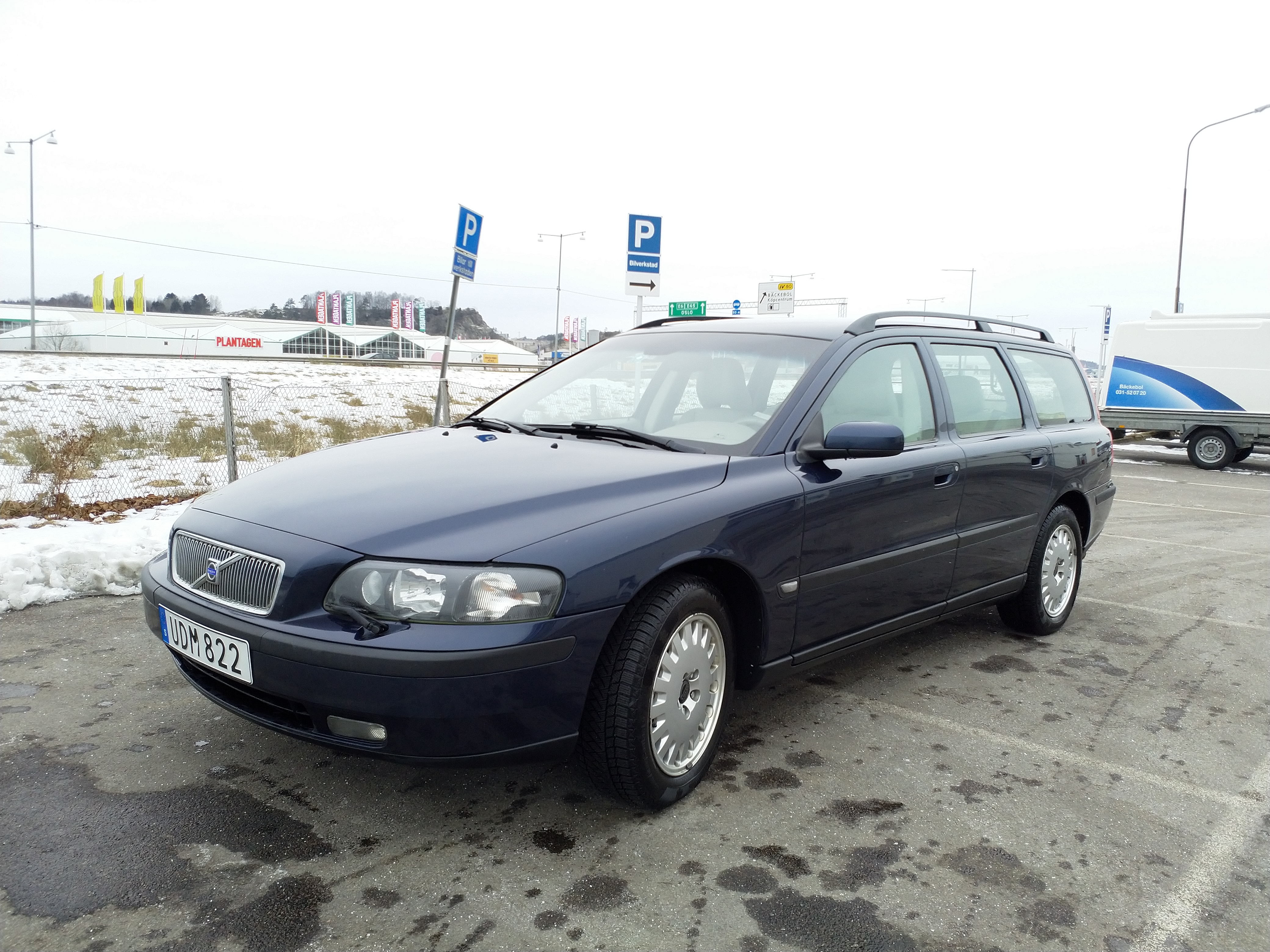

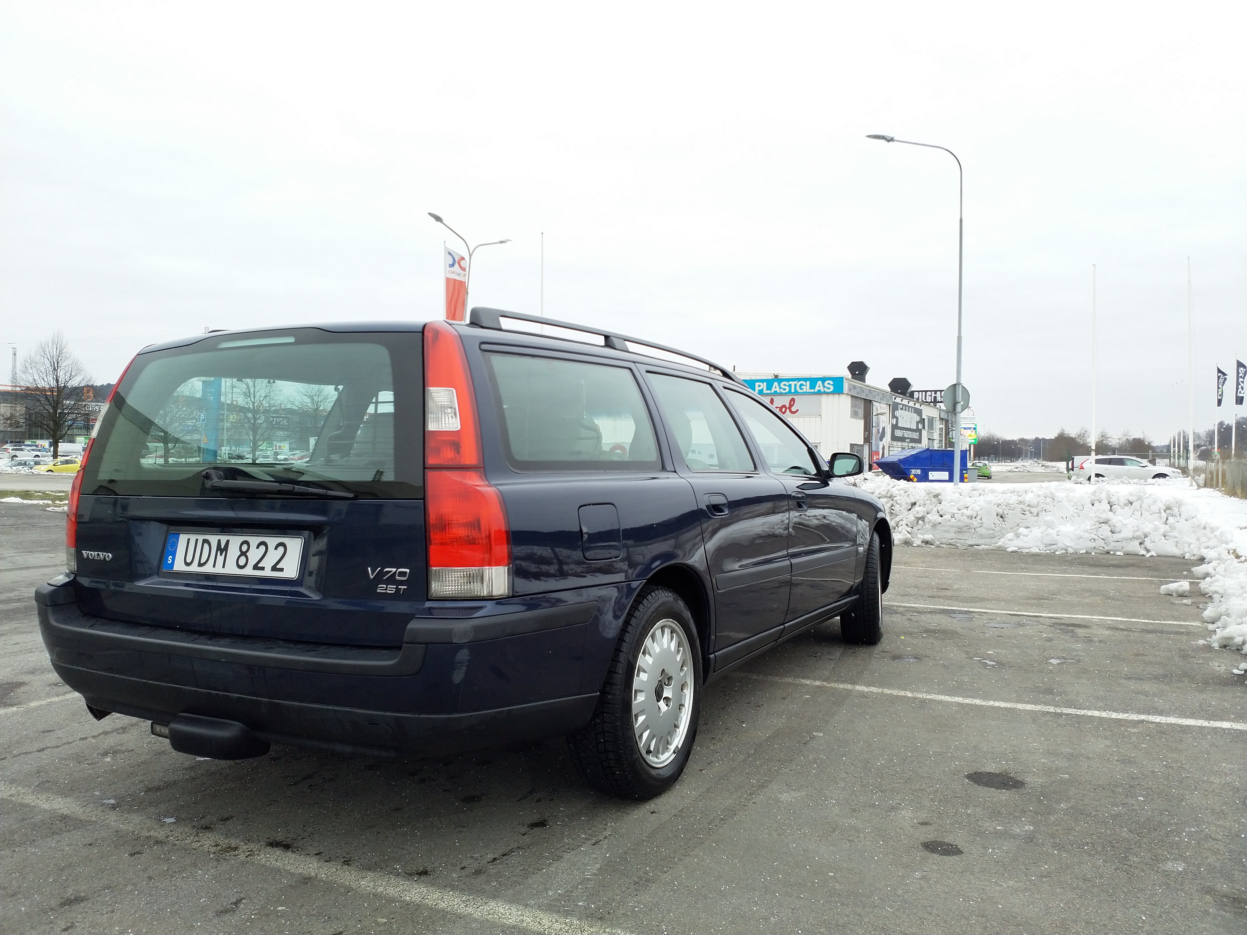

LOVE the wheels on Rattnalle's car....he is about to post pictures.

Washed it and added some Carpro Hydr02. Very impressed with how effective and shiny it is for so little work. Before the car looked like it had been down a salt mine.. Hopefully it stays cold and dry for a little while longer
