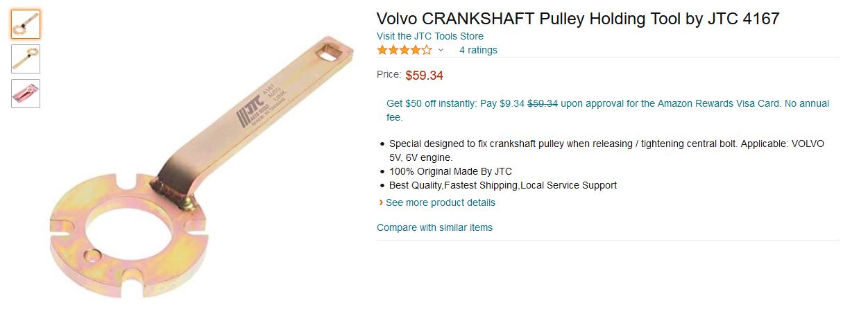

To hold the crank pulley while tightening use a tool like this. https://www.amazon.com/CRANKSHAFT-PULLE ... B06ZYJ1VGL
I made a tool from angle iron that fit over two of the crank bolts.

Funny thing is , I have all the tools to fabricate a fancy $60 counter hold tool, plasma cutter, tig welder etc.
Can't be bothered.

volvolugnut wrote: 06 May 2021, 10:26 To hold the crank pulley while tightening use a tool like this. https://www.amazon.com/CRANKSHAFT-PULLE ... B06ZYJ1VGL
I've got one on the way from FCP for reassembly. I was able to get it off with an impact gun, and I was able to time it back in from scratch (thankfully, I didn't need to loosen the VVT hubs.)
