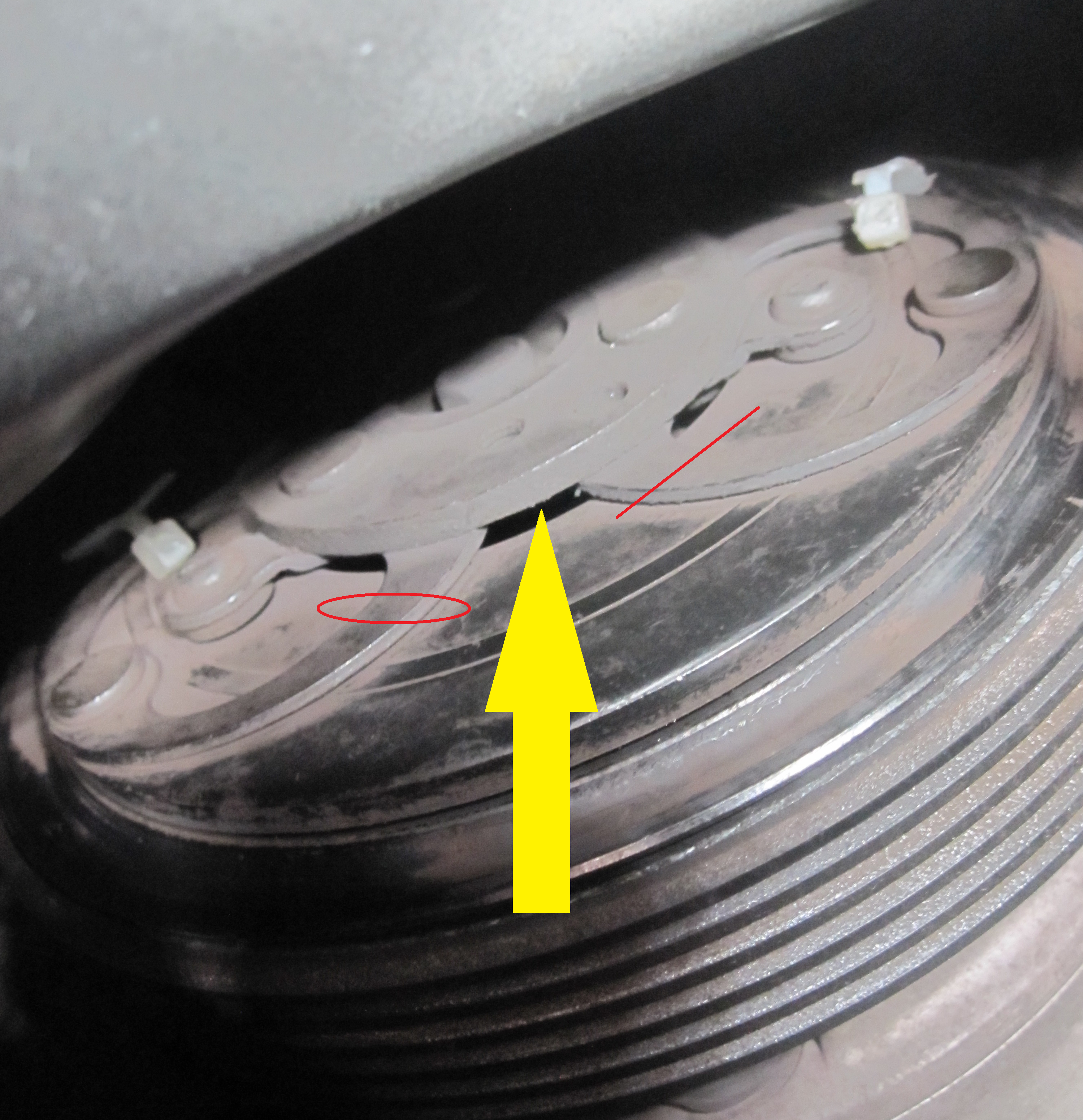

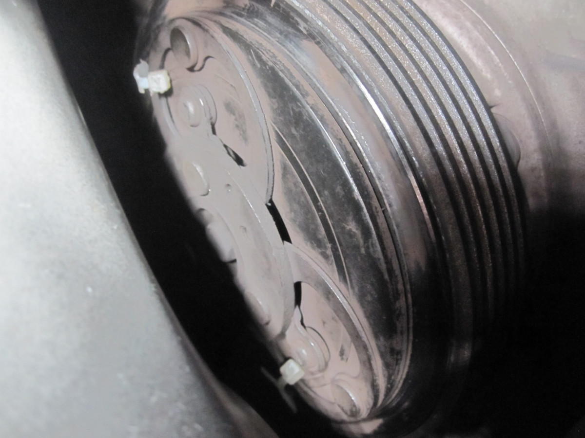

Well, I finally did the zip-tie shim. I only used two ties, as close to 180 degrees apart as possible. Compressor works fine now. My slight concern is that the gap is not quite as even all the way around as I would like. It's about .3mm in places, but a bit over .5mm on about 1/4 the diameter of the clutch. I suppose I could add another 4 ties to make 6 total. Not quite sure how much of a difference that would make.
One tip I'll add...don't freak out if after you put on the first tie, then measure the gap and find that it's completely closed. When you shim the other side the first area will open up a bit, and the gaps will even out. Yes, I suppose this is common sense, but it did not occur to me right away.

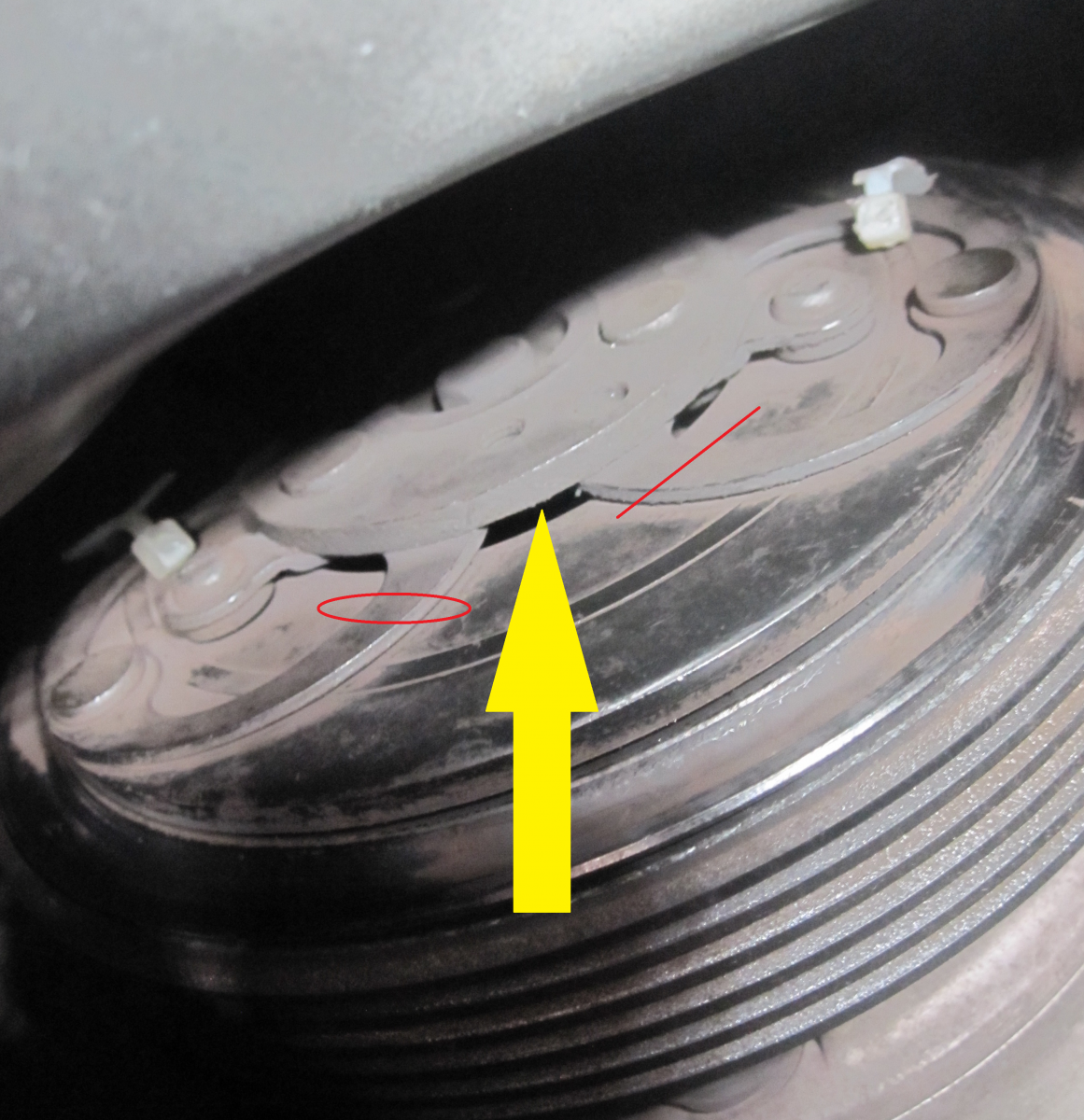

Installed 6 on the C30 today. I didn't like the idea of distorting the circular springs with just 3 so used 6 instead. Had a choice of 3 ties and 2 colors. Decided on the small black ones. Using your picture, I installed them where the red line and circle is rather than up higher. I used a flat head (yellow arrow) and turn 90 degrees to open the gap for the zip ties.

FWIW, I did go back and apply a zip tie to every other semicircle. So I did end up using 3 zip ties total.
