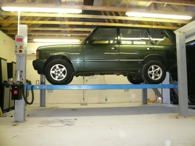

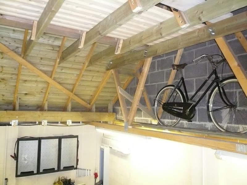

When I built my garage the plan was to build a pit into the floor, however once I excavated the hole for the pit it soon filled with water which indicated I was below the water table level so I backfilled the pit and spoke to my architect. After a bit of head sctatching we decided I could fit a lift once the build was completed (plans were already approved and changing them mid way through would be a major headache and hold the build up for months). This meant fitting extra roof trusses in the roof space where I intended cutting into for the extra height. I fitted extra trusses and once the build completed and passes by planning I went to work bolting in extra timbers that would allow me to remove the bottom stings from the trusses. A tense nerve racking time was had in the roof space with saw in hand cutting my trusses waiting for the roof to crash to the ground. It's been like that now for 12 years and no problems.
Maximum lift height before cutting trusses
Truss strings before cutting
Extra timbers bolted in and strings cut away
XC90 on the ramp and too high for me to reach

P80GLT wrote: 08 Apr 2023, 23:44
Is your ceiling modified to accommodate the car lift?
