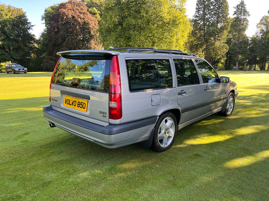

P80GLT wrote: 26 Aug 2023, 12:24 Gave the 850 a quick wash early this morning before heading out to Lesmahagow and the Auchlochan Car Show
I'm very jealous ! :) It seems like you get to participate in a car show every week or two. And on a nice lawn as well.
Nothing like that around here.
Your baby looks beautiful !

Sveedy wrote: 26 Aug 2023, 13:36 I'm very jealous ! :) It seems like you get to participate in a car show every week or two. And on a nice lawn as well.
Thank you Sveedy, I guess I lucked out when I bought it, I doubt there's a more original 850 left in the UK now in the same condition.
I've been to very few shows this year as I fractured my back in May which put me out the game for a while, just trying to make up for lost time now before the shows finish.
Yes that lawn was amazing, but not as good as it was last year when we were there, I think the wet weather from the last couple of weeks hasn't helped

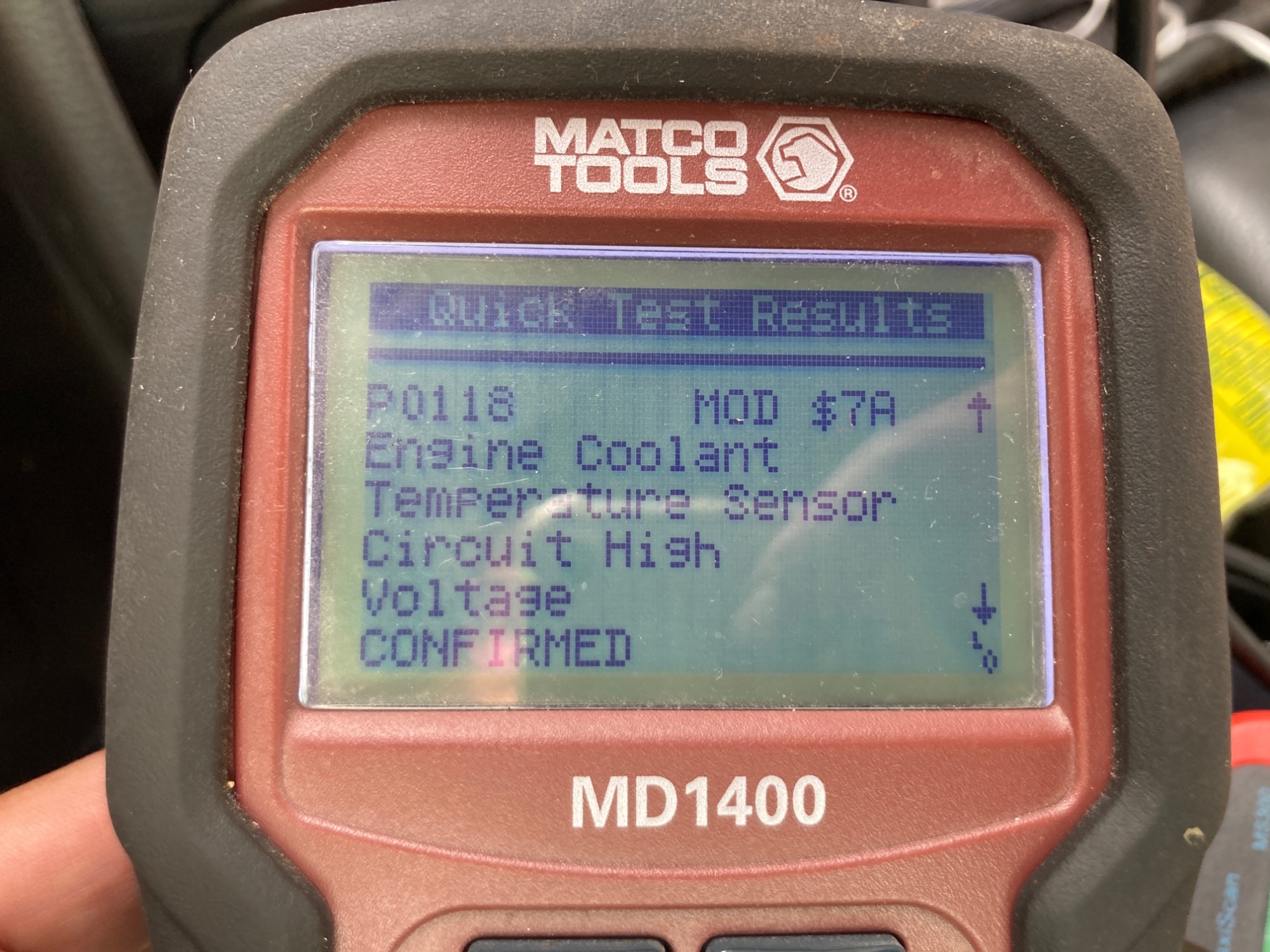

I crossed my fingers and gingerly turned the key, and it ran slowly up to about 2,500 RPM, the settled down to about 1,500 RPM, fluctuating a bit back up to 2,500 and down again a few times. I ordered a new MAF sensor in the meantime.
I did get a new code, P0118, and noticed that my temperature gauge didn’t move even though I ran the engine for a few minutes. In the winter, I’ve noticed that it took a longer than my other P80s time to get the heat going full blast. I’ll order an OE sensor, too.
