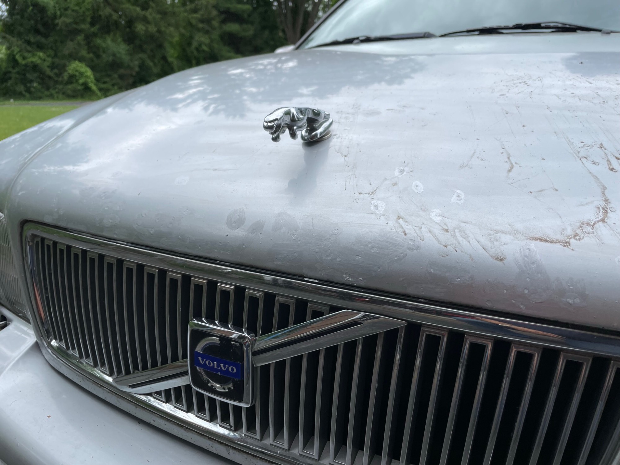

Ouch! Drilling a hole in the hood?

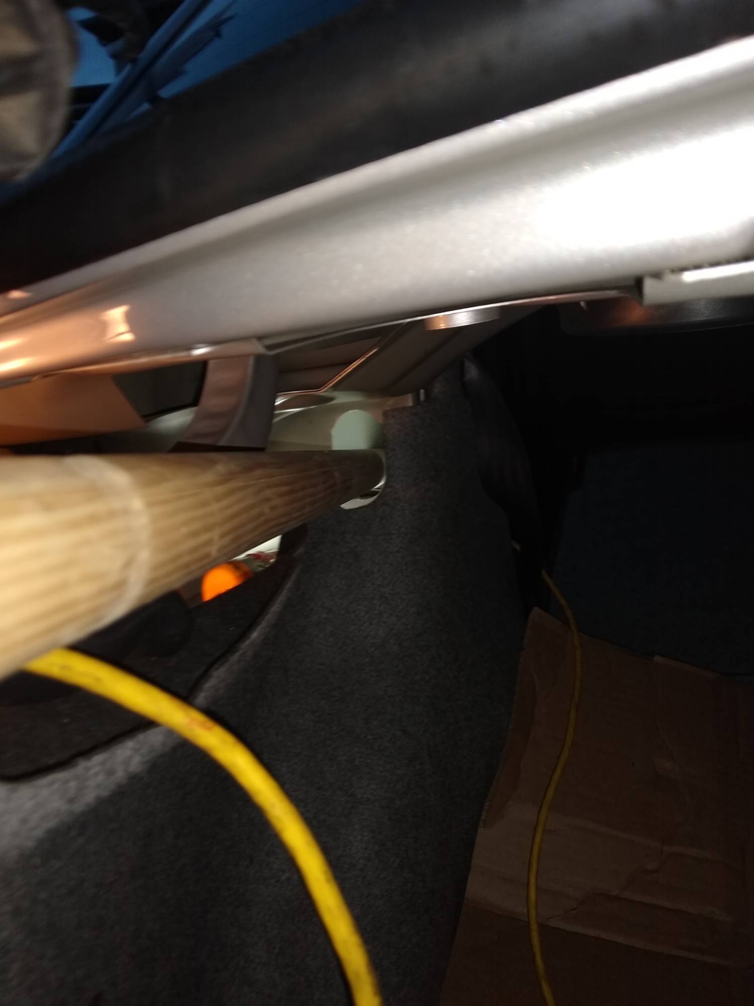

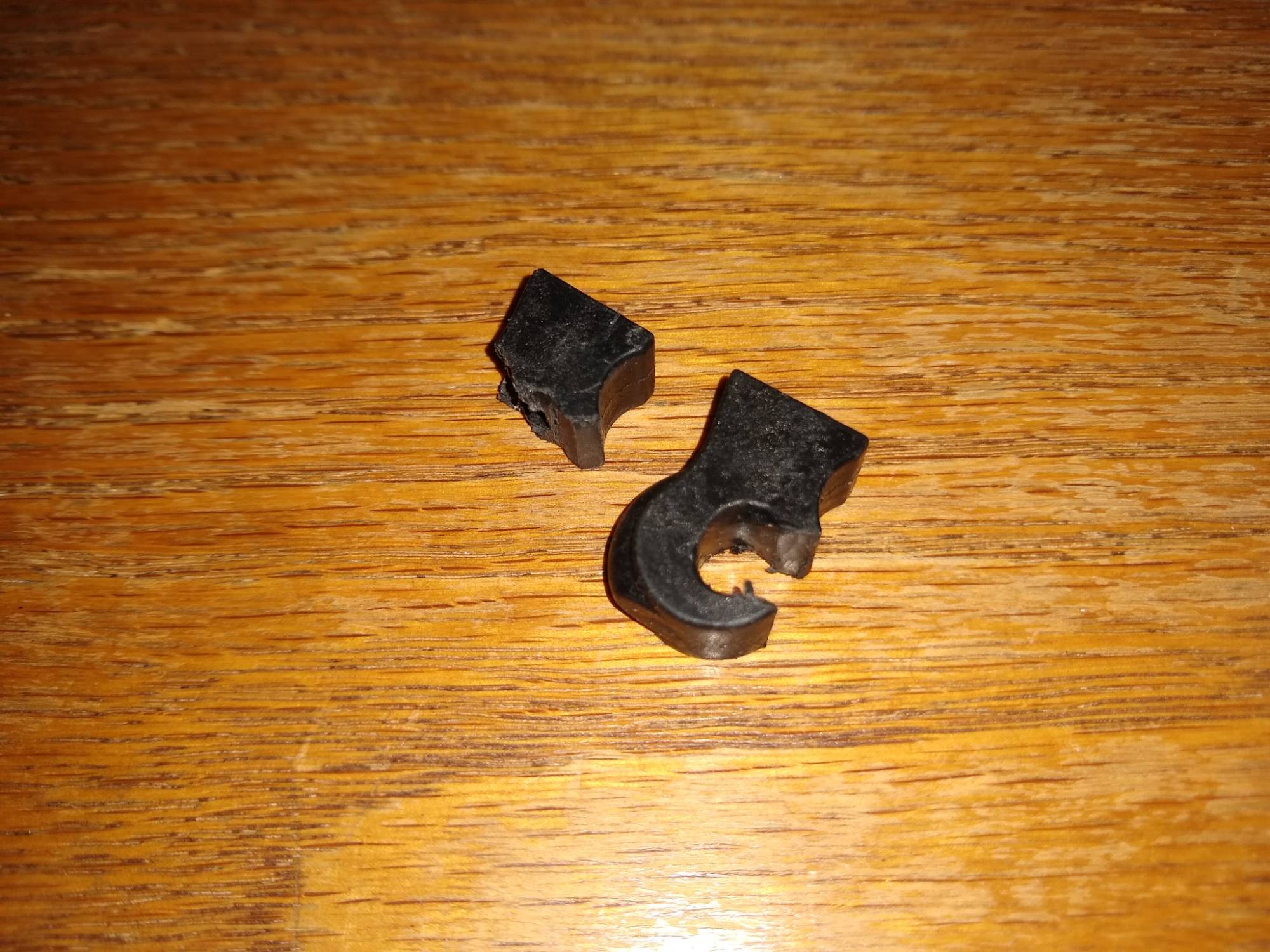

Purchased a set of TRW rear trunk struts from eBay.
https://www.ebay.com/itm/404330259006
Struggled to installed them as the hook was too small. Not one to waste shipping on the seller's dime we agreed to a refund of half the price and I would try to make it work by enlarging the hook, to which he did not recommend. Smart of him to cover his bases.
After trying and trying and method after method I finally snapped the hook in the center. Remembering the hook was a twist on I thought perhaps the Volvo one would also. The Volvo hook is hard but not brittle like the TRW from the feel of it. Of course the Volvo would have course thread while the TRW very fine. The difficult part was threading the TRW to the Volvo clip otherwise it snapped right in without tools. It took 2.5 hours to break one and about 20 minutes to install the other and that's due to the threading of the hook.
Don't have to be cautious and can use the trunk again while parked on a grade. BTW - The Volvo OEM strut is made by Stabilus which FCP carries.
The OE were installed with the clip opening pointing upwards so I have to use a closet rod for leverage to push the old ones down. It was easier to push up to hand push upwards to reinstall. I broke the TRW trying to install it.
