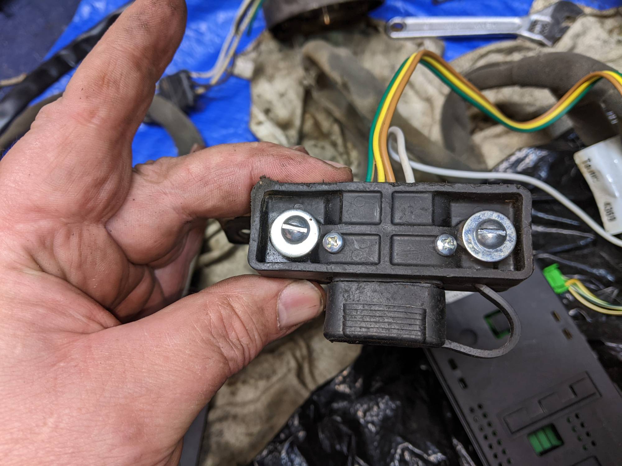

A buddy pulled a trailer hitch from an 06 XC70 for his car, but as he is only using it for a bicycle hitch, he did not need the harness. He gave that to me at the yard but I did not look at it. When I got it home, 2 of the wires were severed at the plug at the hitch end. One was fixable, but the other was pulled and broken at the molded plug. By chance I have a similar 4 pin plug that I have modified to use the plug cover from the original as well making a simple mod that allows the new plug to stay locked in the mount the plug sits in (the original is molded to fit into the molded bracket.
Wire colors are similar for 2/4 wires but I plan to solder the repair and heat shrink the cables so they should be inside the car.
Before I do this, while I do not use a hitch and won't on any of our AWD Volvo's (due to angle gear sympathy), does anyone use any other type of plug on their Volvo. I'm assuming as this as the Volvo harness controller unit you cannot use any other connector like the 5/7 way type some vehicles use. If this is the case I will go ahead and solder repair this cable as planned with the 4 pin cable as originally used.
I have no use for this but again hate to see something that can be repaired and someone may find a use for.
Broken original hitch harness
Replacement plug fitted
Even modified the original plug cover to re-use it as the replacement did not come with one.
When I disassembled the original plug holder (it is a clamshell with a hinge one end) it was full of dirt and allows dirt to fill up in there. I am thinking of filling the void with black silicon to A) further prevent the plug from possibly being pushed through the retaining clamp and B) to keep the crap out and prevent/reduce the chance of moisture entering the back of the plug. Good or bad idea?

The white wire is the ground. You can see it has a slight nick in the white wire sleeve near the plug. Weird thing is I have trimmed it back 2-3" from there and the wire is totally corroded!! I have traced it back up to a join maybe 18-24" in where it meet the main ground wire. I am thinking of removing the wire all the way up to there and running a new wire all the way to the plug.
Posts: 14899
Joined: 5 April 2010
Year and Model: 2000 V70 R
Has thanked: 1853 times
Been thanked: 1714 times
Post by scot850 »
I removed about 18" of the ground wire and the wire was then 95% clean. Connected and heat shrunk all the wires and used large glue lined heat shrink tubes to overlap the cable harness. Now much better protected than originally made.
All wire buzz out nicely. The cable assembly is ready for a new home. Good thing this is the basis you need if you want 7 or 13 cable outlets which can be bought from Volvo separately and attached to the correct connector.
All is now good and I also understand how this is sold and the variants available.
