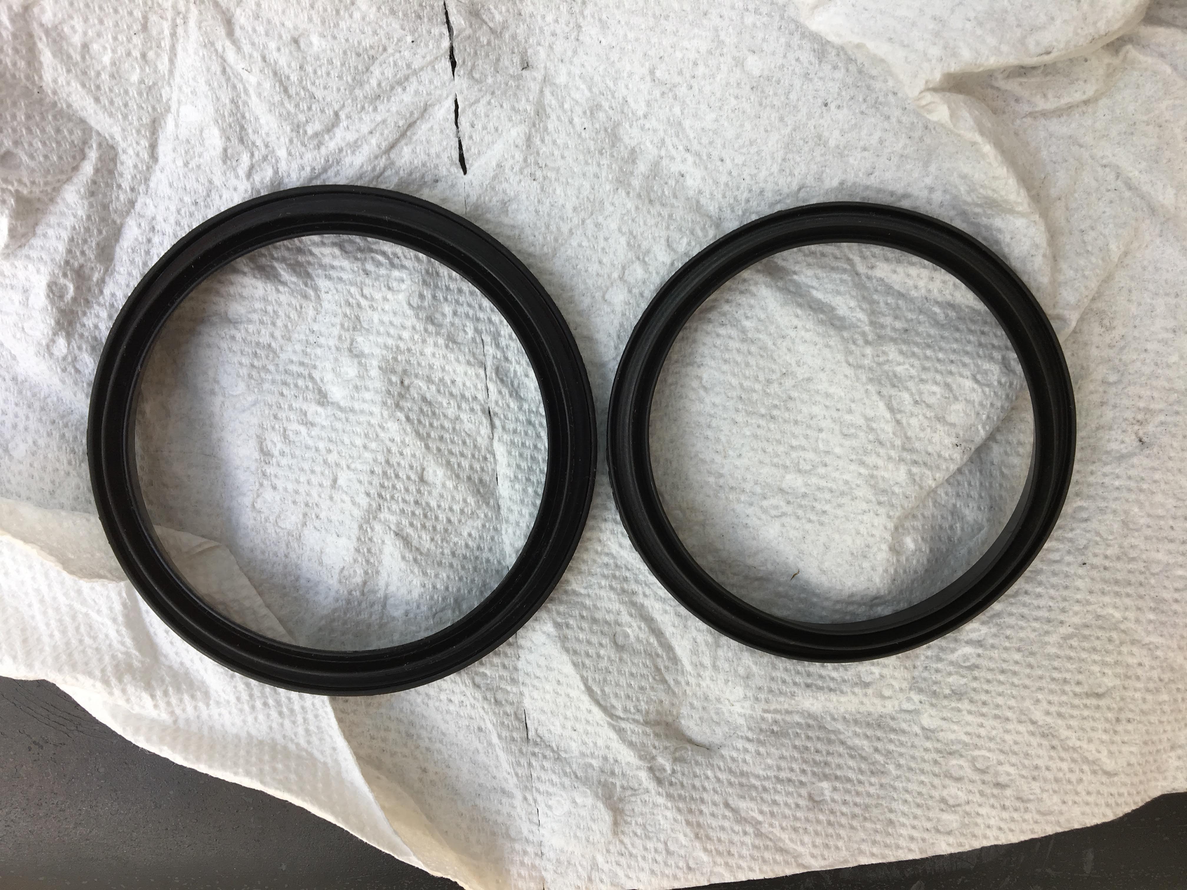

Pulled my fuel pump AGAIN to check the seal. Lightly coated it with Vaseline and carefully put it back together. It also looks like the gas fumes have really gotten to the neck... it's slightly oblong now.
I also found interesting the size difference from the original seal (right) to the current/third seal (left). Maybe it's because it's gotten dry from sitting on the shelf for almost a year, but that seems weird.
