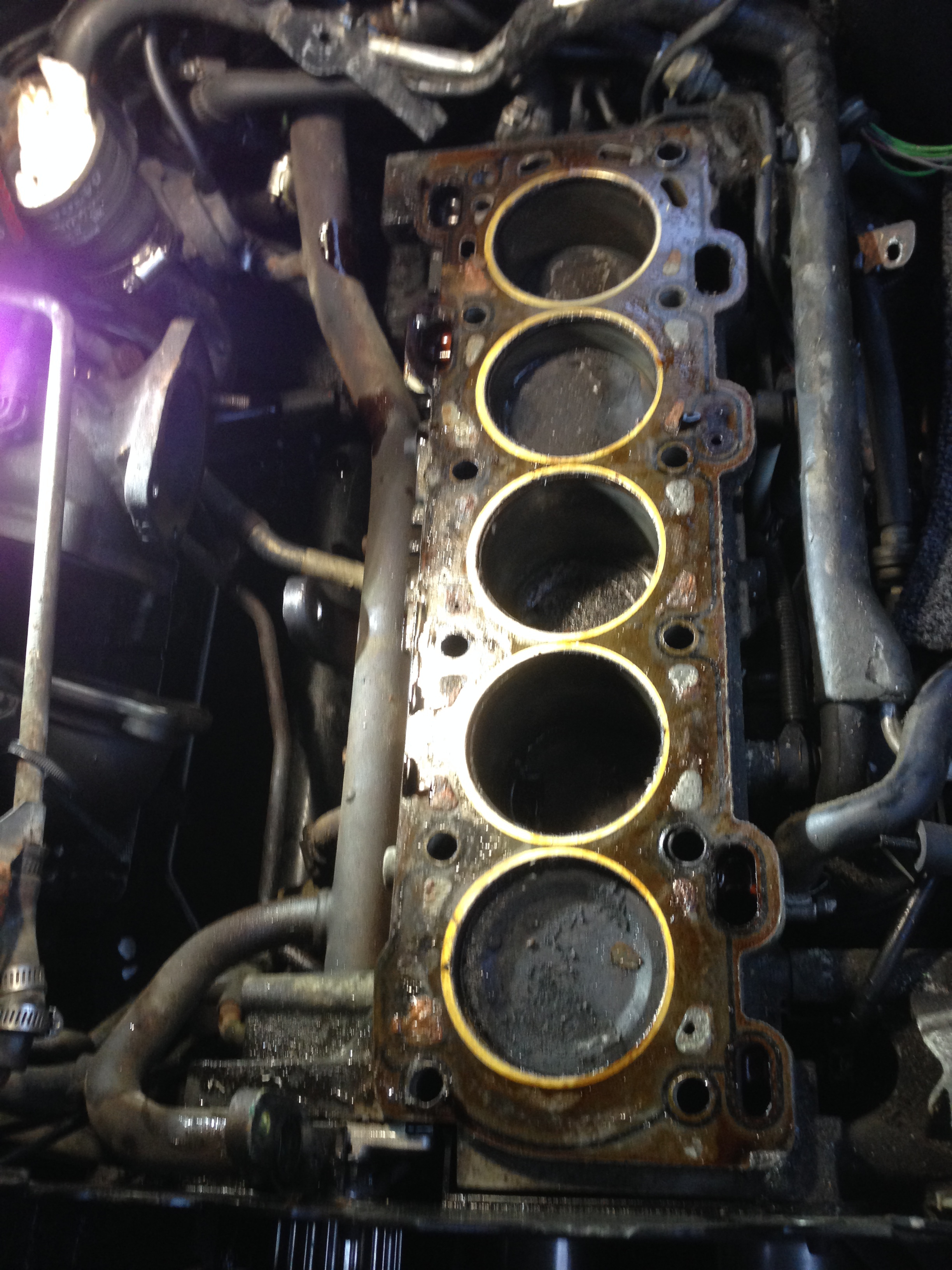

Deep chill Coming , 4 days of 0-10F plus wind

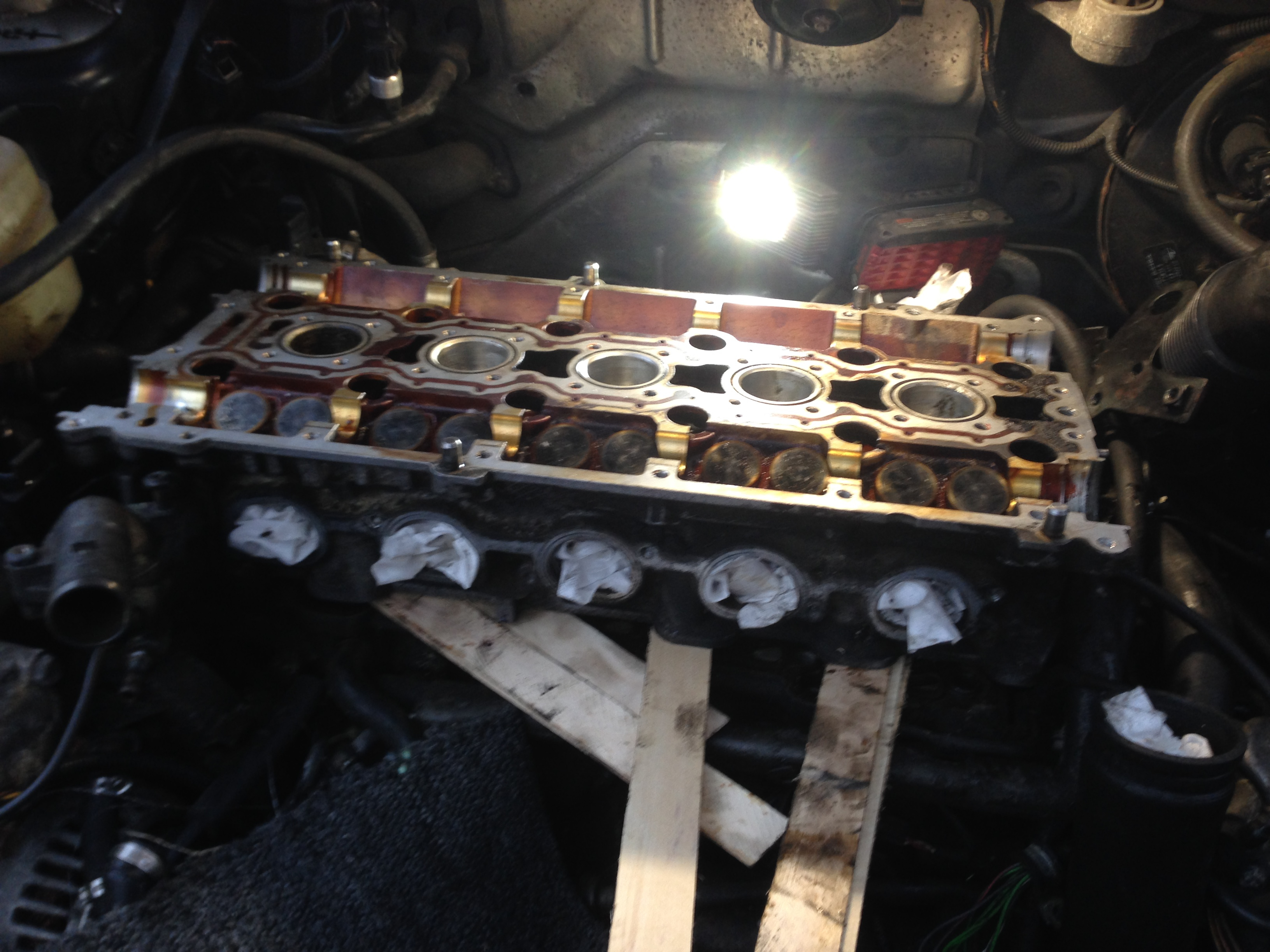

Really wanted to get head into shop but it was cold and nasty, struggled but got the deed done

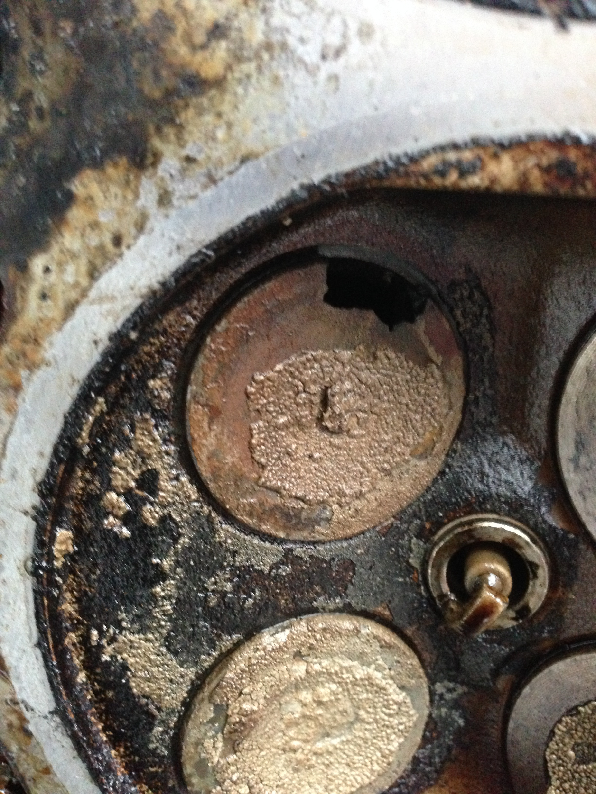

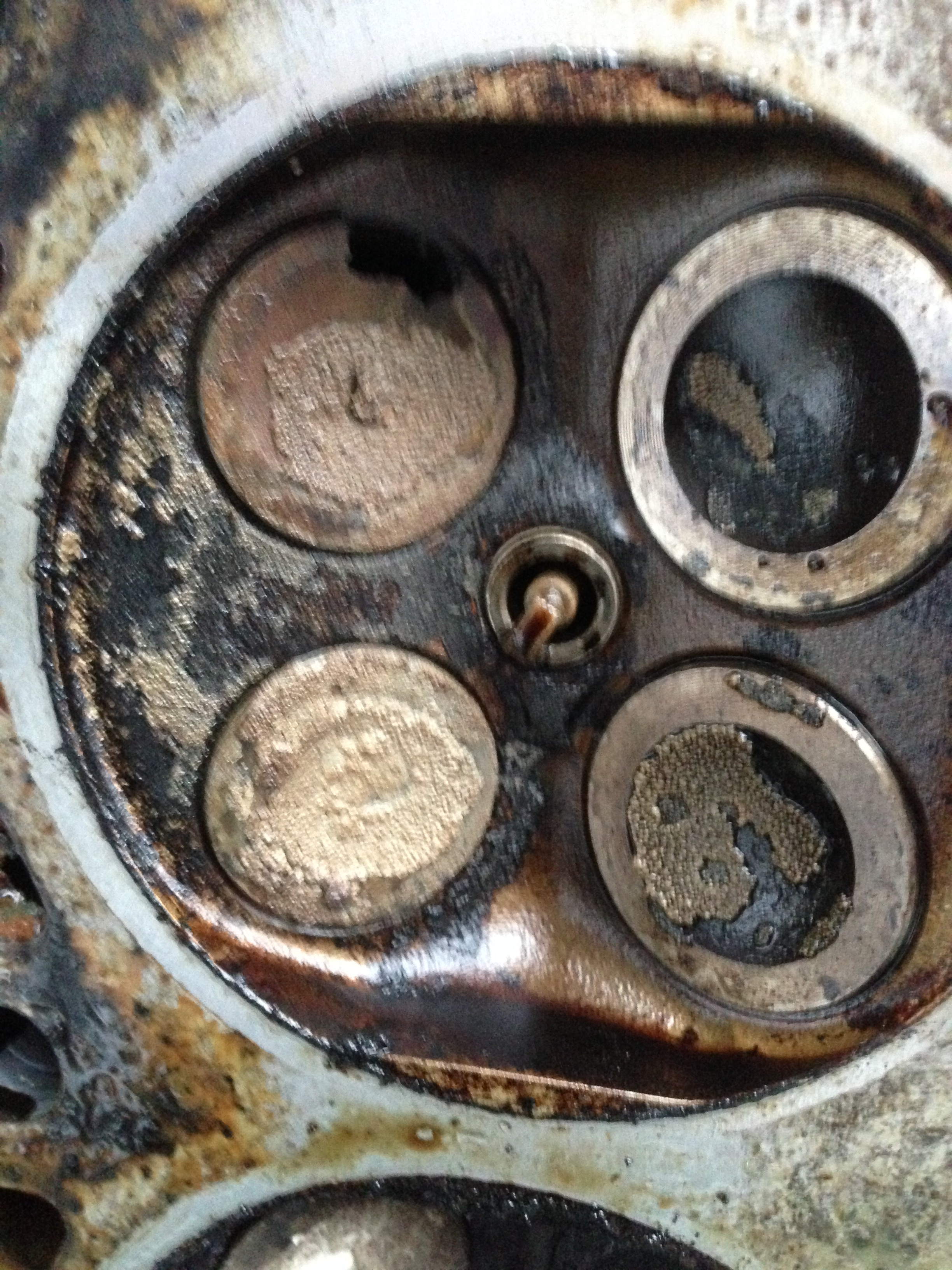

And the diagnosis on Number 3

Well done!

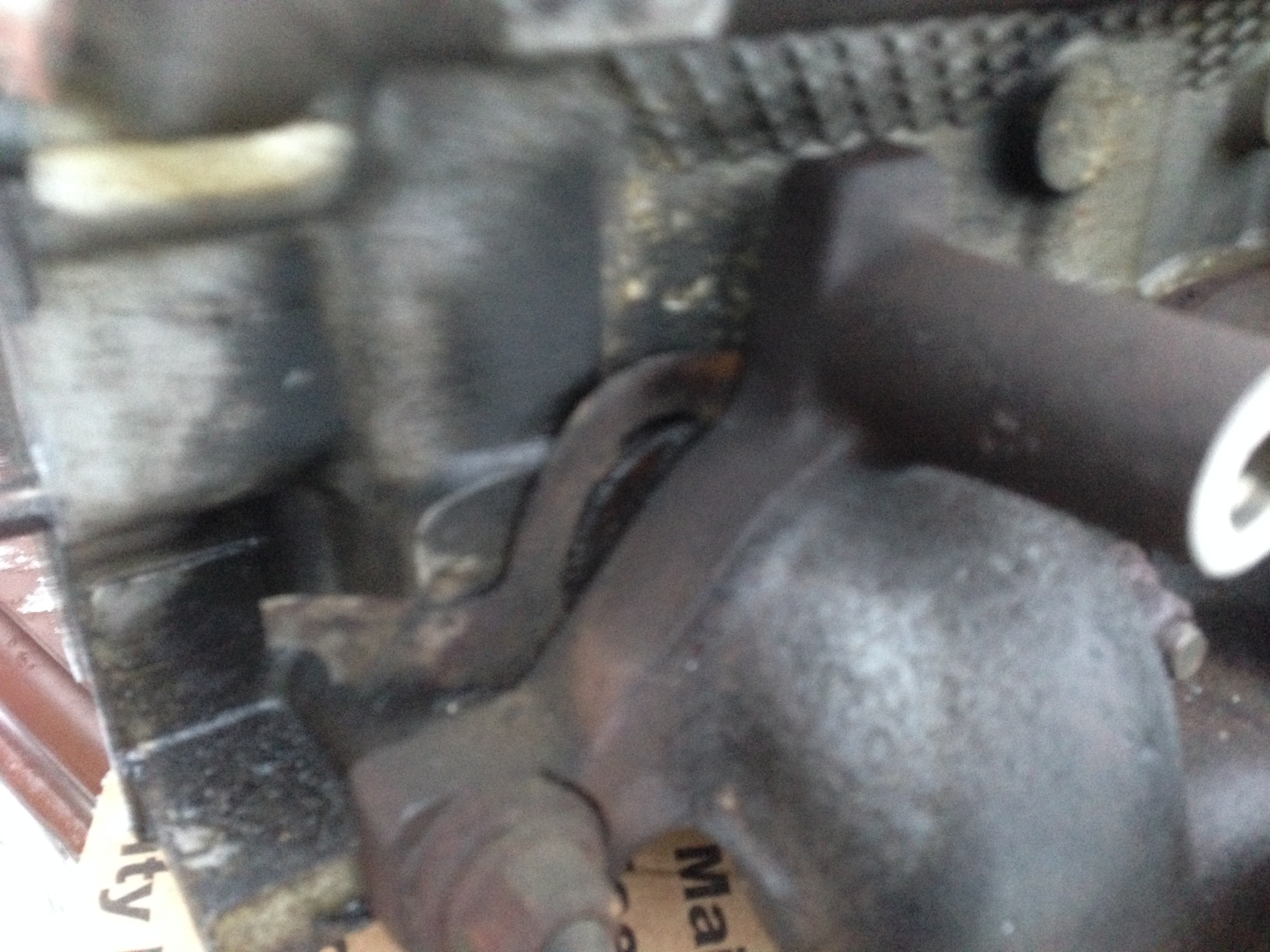

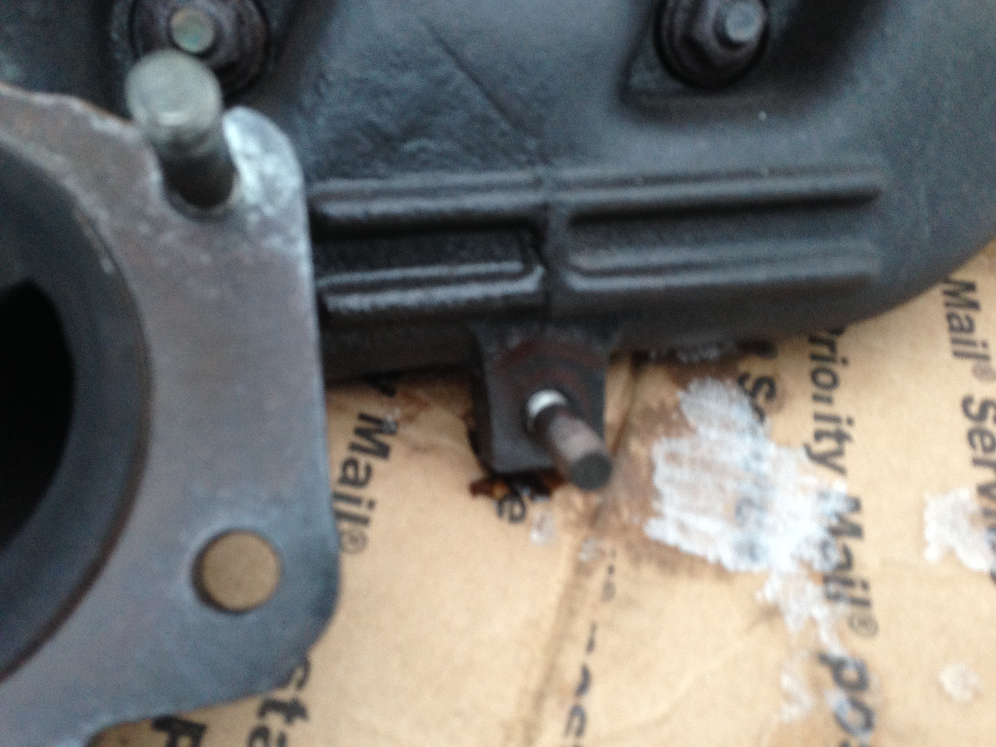

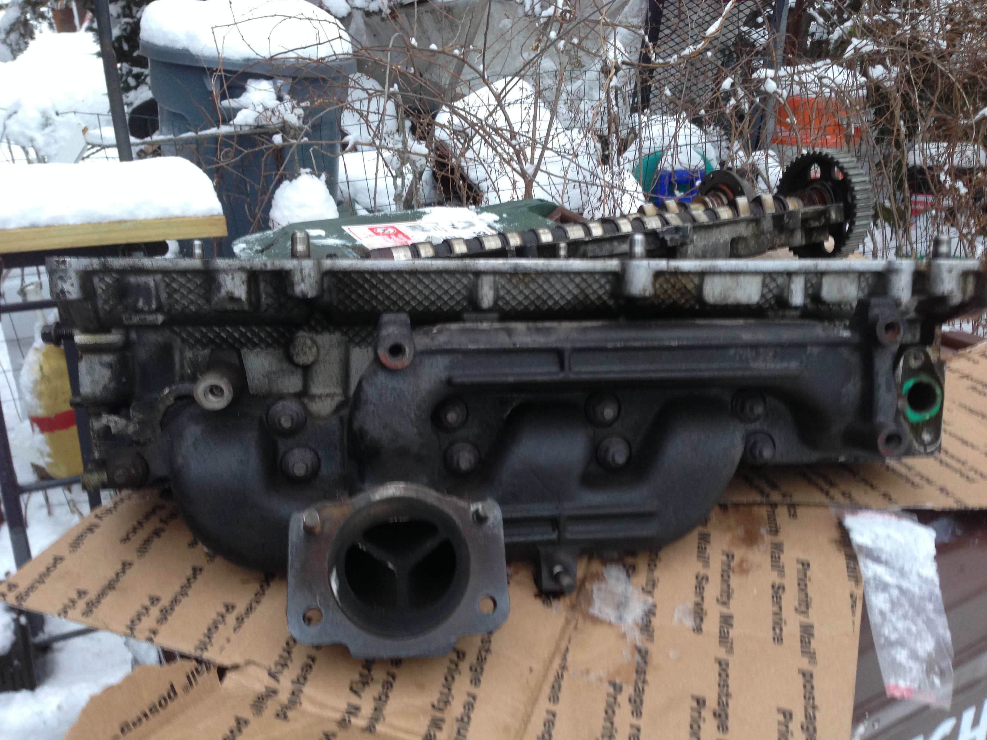

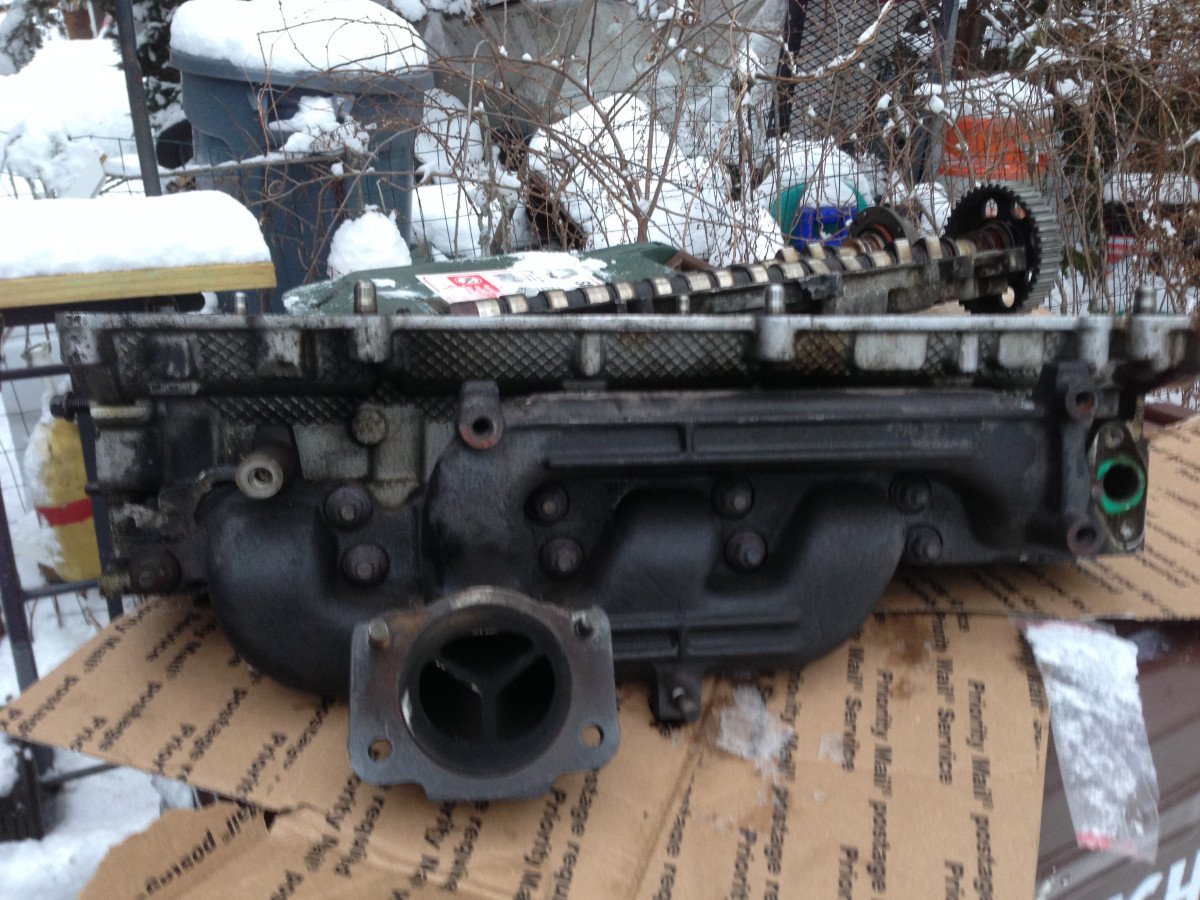

So what was the winning way to separate exhaust/turbo for removal ? Kind of looks like you removed a couple of studs to get it out.

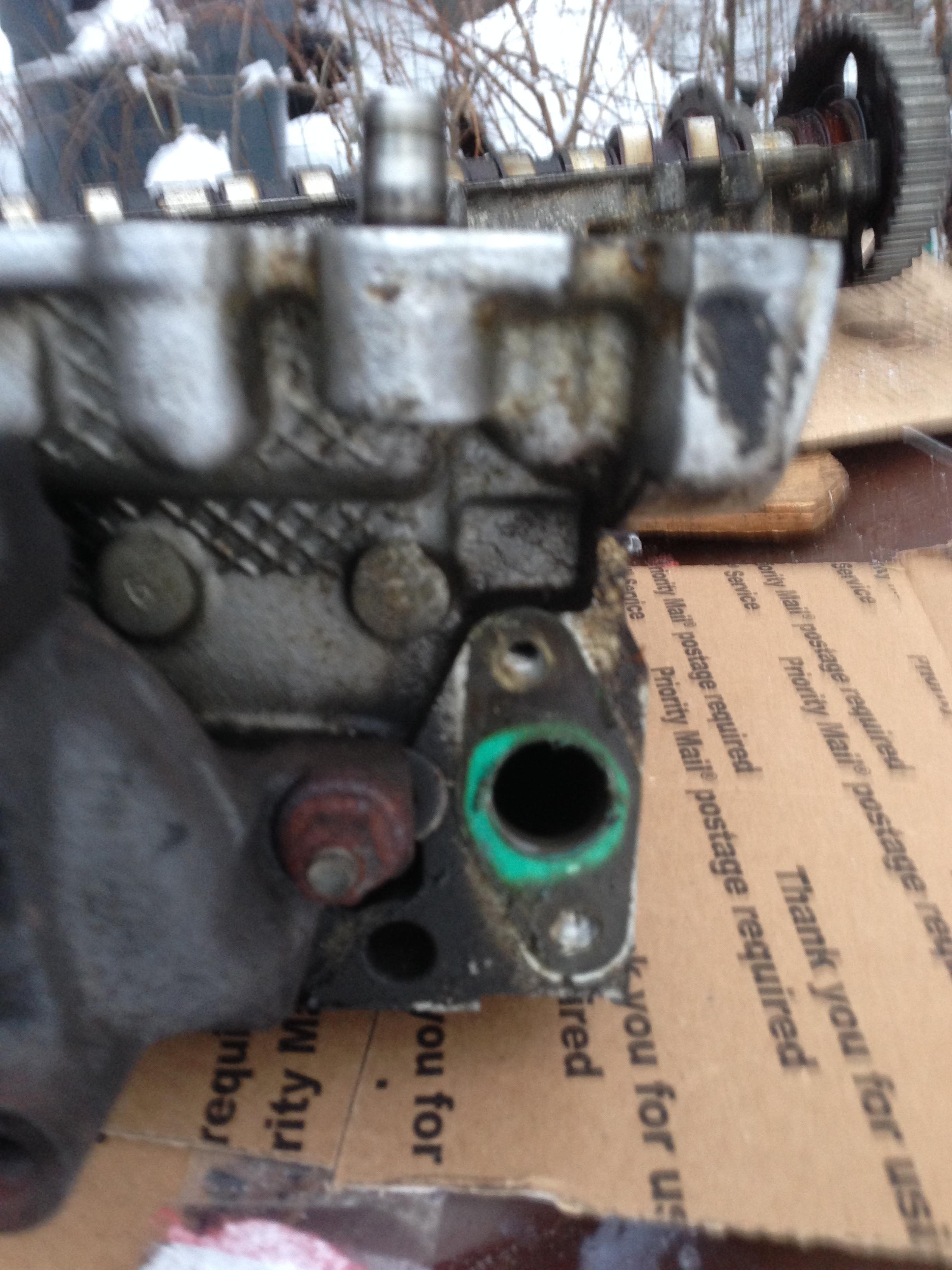

Short version
I had to break the down pipe connection first. It's three M8 13mm hex nuts. I had to Dremel off the bottom one.
Once the firm pipe eased sideways towards the passenger side, the turbo rocked back off the manifold studs.
I also noticed I have blown exhaust on 1 and 5 cylinders.

Good work, might be just in the nick of time. Weather down here is gonna get snotty, dunno about up north.
Couldn't tell from the pics, how does the top of the piston look ?
- Posts: 35272
- Has thanked: 1497 times
- Been thanked: 3810 times
Looks ok, I’ll clean up of course.
