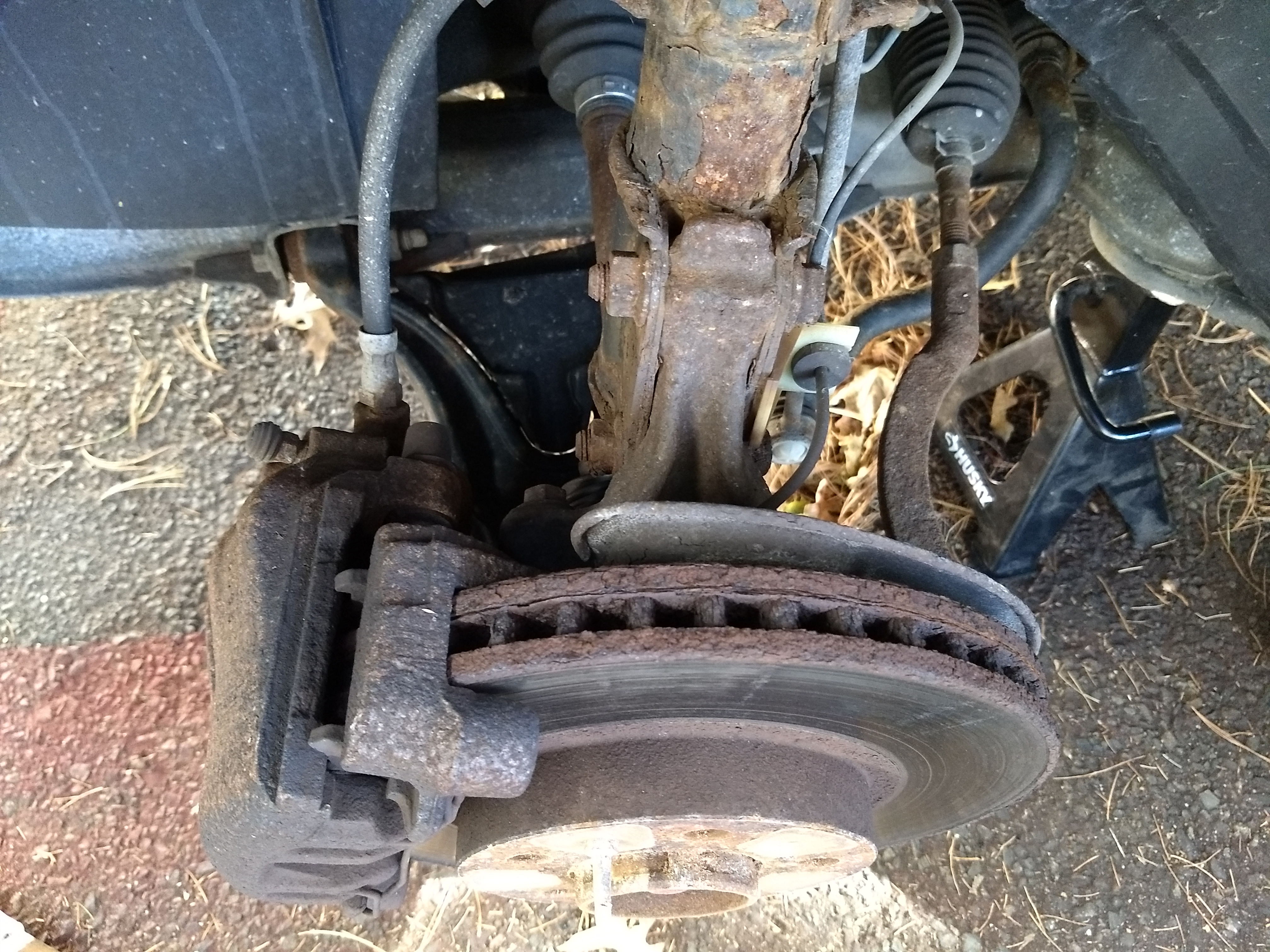

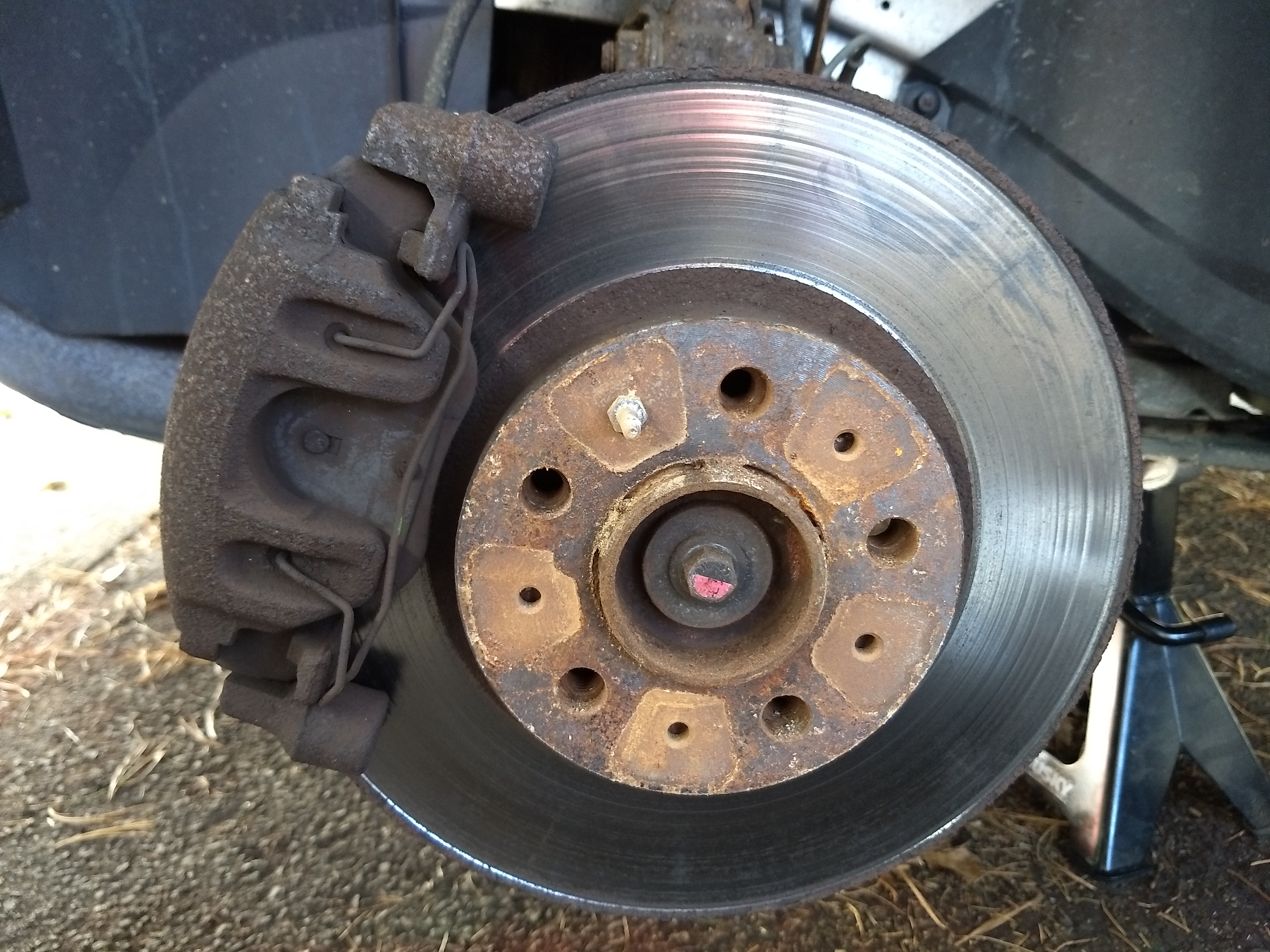

Tackled the front brakes today, with a couple of hitches. First, the left outer brake pad wouldn't fit in the bracket, as if the tolerance was off. I put the original back on, with about 50 percent of the pad let.
Then the right side guide pin was seized, and it snapped off when trying to remove it. I never understood how much that tiny screw helps align things. (I know, duh!) I gave the caliper bracket a good scrubbing and got it pretty clean. I used the outer brake pad that didn't fit in the left side, and it fit perfectly.
The brakes felt great as I started the test drive, then there was a strange groaning/clunking when not accelerating.
It was getting dark by the time I got back, so I'll go back in there tomorrow. Any ideas what might cause such a sound?

Probably the brake backing plate / metal shield touching something it shouldn't
Just bend it away until the noise stops

Taking the lip off those rotors may also improve the noise. Until the new pads bed-in they tend to ride on places not previously ridden on. This leads to all kinds of noises you've never had before, and after a while, may not ever have again.

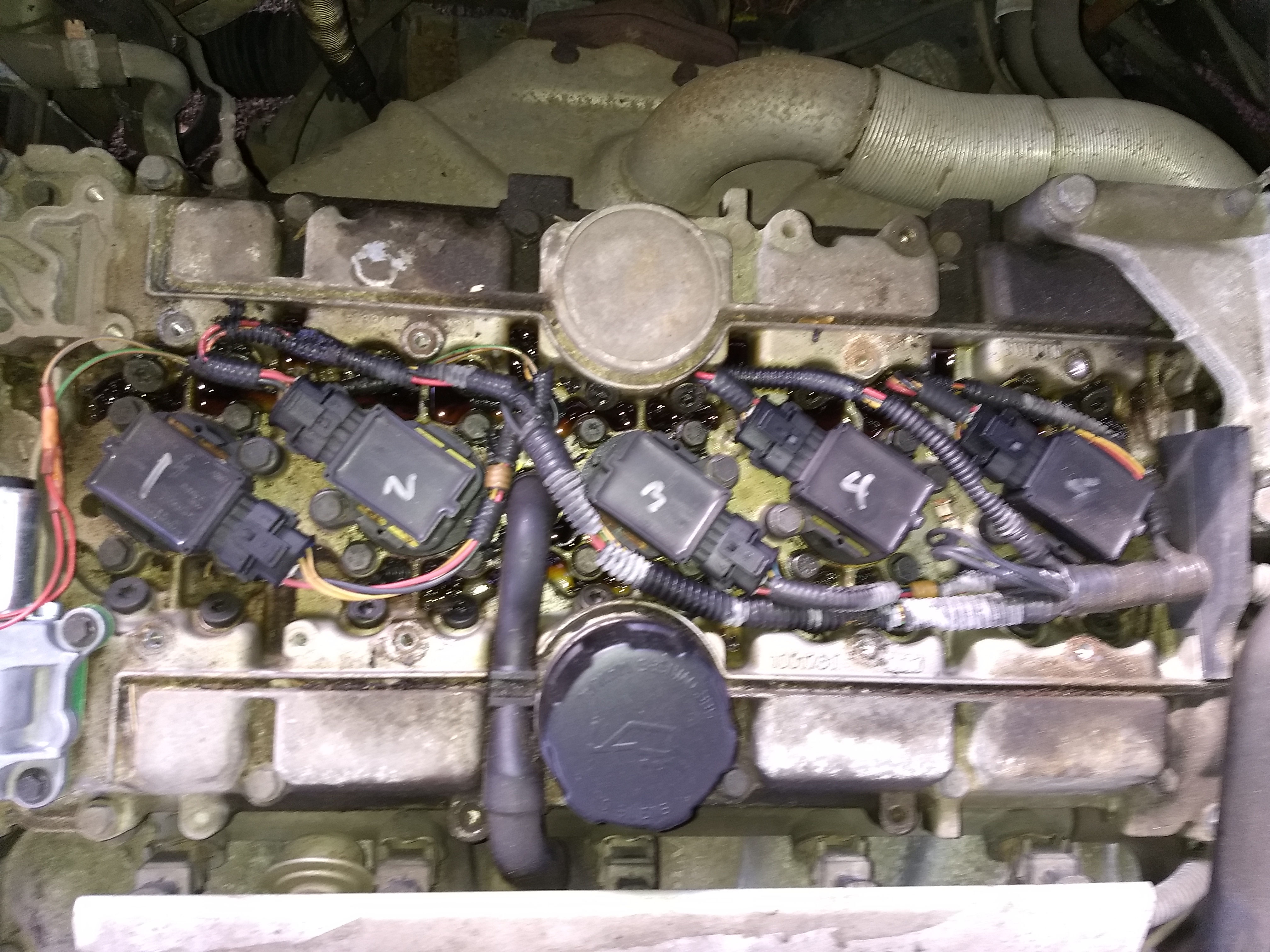

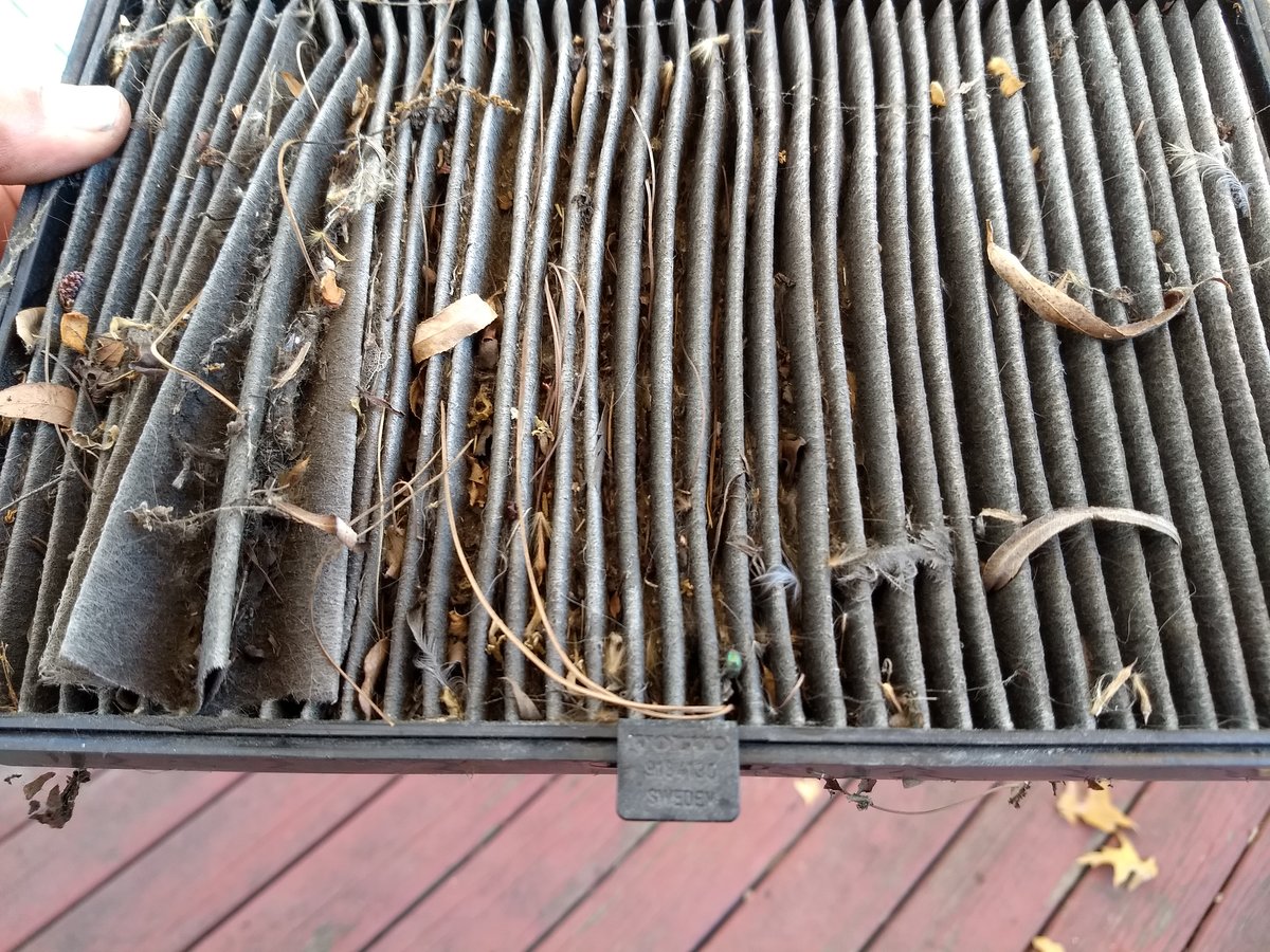

]I didn't have time to redo the brakes yet, as I had to keep an eye on the kids, so I replaced the cabin air filter, the engine air filter and the spark plugs, as well as replaced the main window switch on the new-to-me '00 V70, 182k miles.
The cabin air filter was OE and had tabs to hold it in place. The sticker said it was last replaced in May 2001 at 15k miles. It looked like a raccoon nest.
The top of the engine had tiny pools of oil, which means a PCV replacement soon is in order. Yay!

Try a new gasket on that oil filler cap first, B

+1 on replacing the oil filler cap gasket. Then clean the oil off and see if it re-appears.
Check the PCV system pressure with the glove over the oil filler hole and see if it inflates either at tick-over or when rev'd.
If it inflates only when rev'd you have some time on the PCV clean.

Yes, do the glove test first. If it passes, go ahead and replace that oil cap gasket.

Not saying you should do it, but I managed to get my car to a self-service car wash, remove the covers and pressure wash a cold engine's cam covers to remove the oil. Make sure you let the engine cool rather well (it's been below freezing here often) and you shouldn't have any issues provided everything is in rather good condition.
+1 on both PCV glove test and that oil cap seal. The oil cap seal first becomes like leather, then becomes like stone. Tends to leak so little that it doesn't get on the plastic covers usually but rather seeps slowly under them by going down the filler tube's side - unless you have a gusher.
