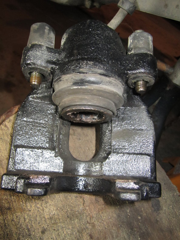

Just so we are all on the same page, Blockpartie is correct in that to 2000 MY V70R had a 1 year rear caliper option. It looks like the front calipers we all know and love on our Volvos with a single piston and 2 slider pins. One brake pad is clipped into the piston with 3 spring clips.

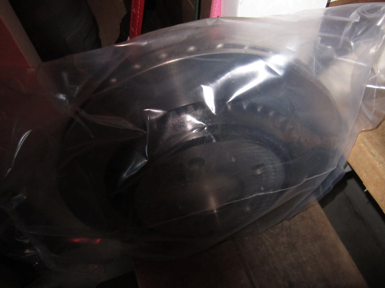

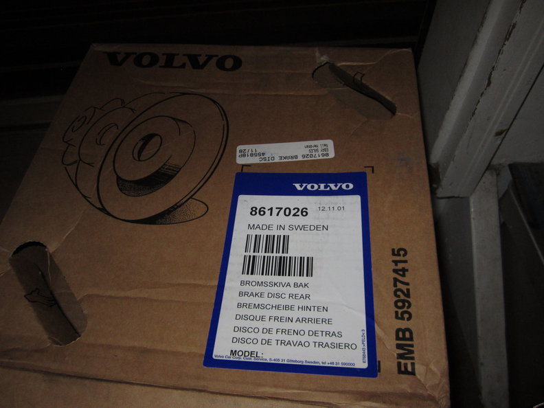

This rear brake uses a vented rear rotor which I have shown before, but here we are again:
Rear rotor part # 8617026
I thought I had done the hard part and then came the caliper. Like you all suggested, the re-man'd route was looked into and again as yet I can't find any. Tried Centric who even list a suitable rotor and they were a no.
I am currently in contact with ATE in Germany (OEM) to see if they can identify a generic or other vehicle brand who may use the same caliper, or even have a source for an overhaul kit.

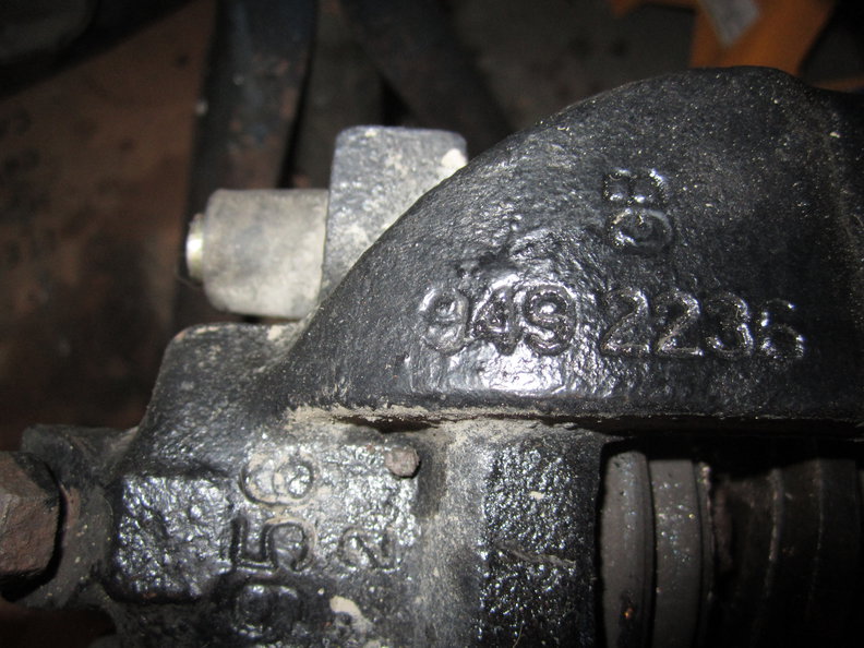

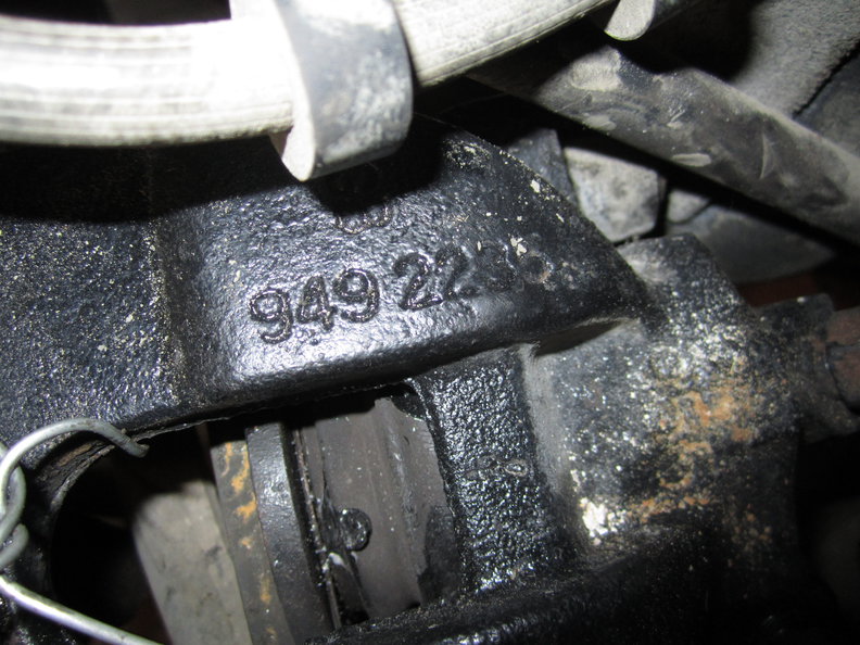

When I look at Vida, it does not even show this part number for the rear calipers as stamped on them:
LH - 9492235 Also numbers 955 2 and 9BS
RH - 9492236 Also numbers 956 2 and 9CG
I think I read somewhere that the Volvo work around involved back-dating the rear brakes to regular AWD, but again my copy of Vida is of no help here. I will talk to by friends at the dealer and see if they can find out what that is all about. Perhaps the Volvo part numbers were upgraded. I know there was a right up on V70R or Volvospeed for fitting rear rotors from a S60R/V70R but they need to be modified. I'm all for good brakes, but I haven't yet had a Volvo with poor rear brakes. Biggest issue I've had is they don't work hard enough and tend to seize!

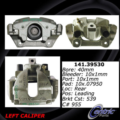

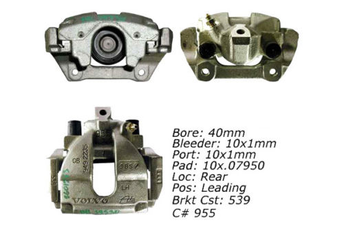

Bunch on Ebay
http://www.ebay.com/itm/Centric-Parts-1 ... 1274623263
http://www.ebay.com/itm/Centric-141-395 ... ef&vxp=mtr
- rear caliper on ebay.JPG (26.61 KiB) Viewed 3272 times
- rear v70 caliper on ebay.JPG (49.85 KiB) Viewed 3272 times

Many thanks John! I used your info with my local parts store here in Calgary, and they came up with another option for refurb's units from a Canadian company called Ultram, Their part numbers are: RFC22-9337L or R. They are $100 ea + $100 ea core charge (and that is CDN$ or $80 US). I plan to go and order a pair tomorrow and confirm they are correct and post back. At that price, as I am having to pull them anyway, it makes sense to replace them. If these don't work out, then I'll look into the US options from Centric, but that adds about $40 shipping each onto the part price, plus the return shipping for the cores. I will need to check how that would stack up against dealer prices for the replacement parts.
