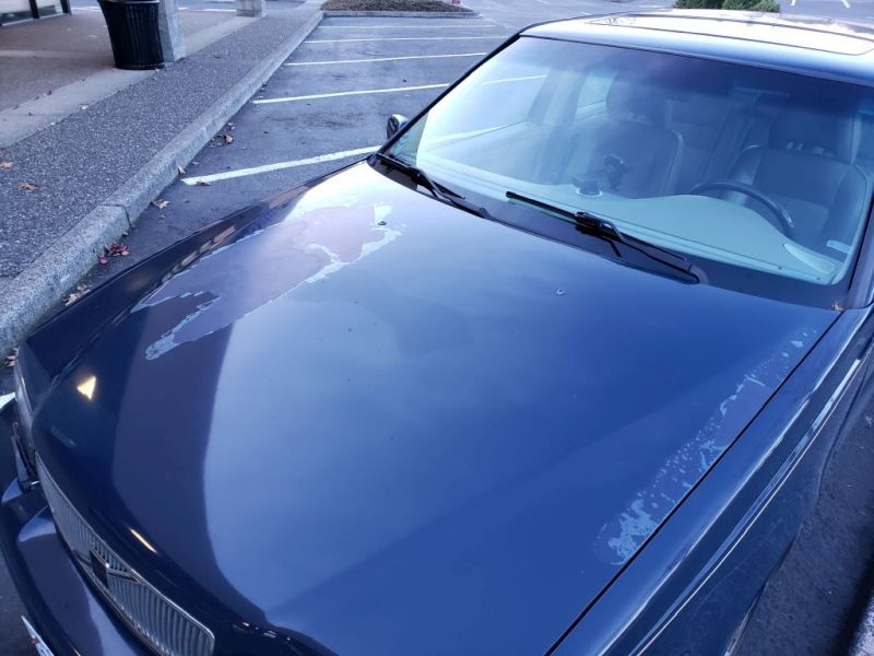

patcal
Posts: 141
Joined: 12 July 2020
Year and Model: 1998 S70 GLT
Location: Gresham, OR.
Has thanked: 99 times
Been thanked: 10 times
Post by patcal »
Does it look like this?

Clemens
Posts: 1932
Joined: 3 September 2015
Location: Austria
Has thanked: 473 times
Been thanked: 219 times
Post by Clemens »
clearcoat peeling. no cure known other than repaint.
the sad thing is usually it starts on the hood or trunklid and then spreads across the whole car within a few years.

BlackBart
Posts: 6492
Joined: 10 December 2016
Has thanked: 927 times
Been thanked: 884 times
Post by BlackBart »
In Pat's case, can you carefully sand off the clear without digging into the color layer, and re-clear it? Does the color layer want to be baby smooth, or have some tooth in it for the clear to adhere to?
