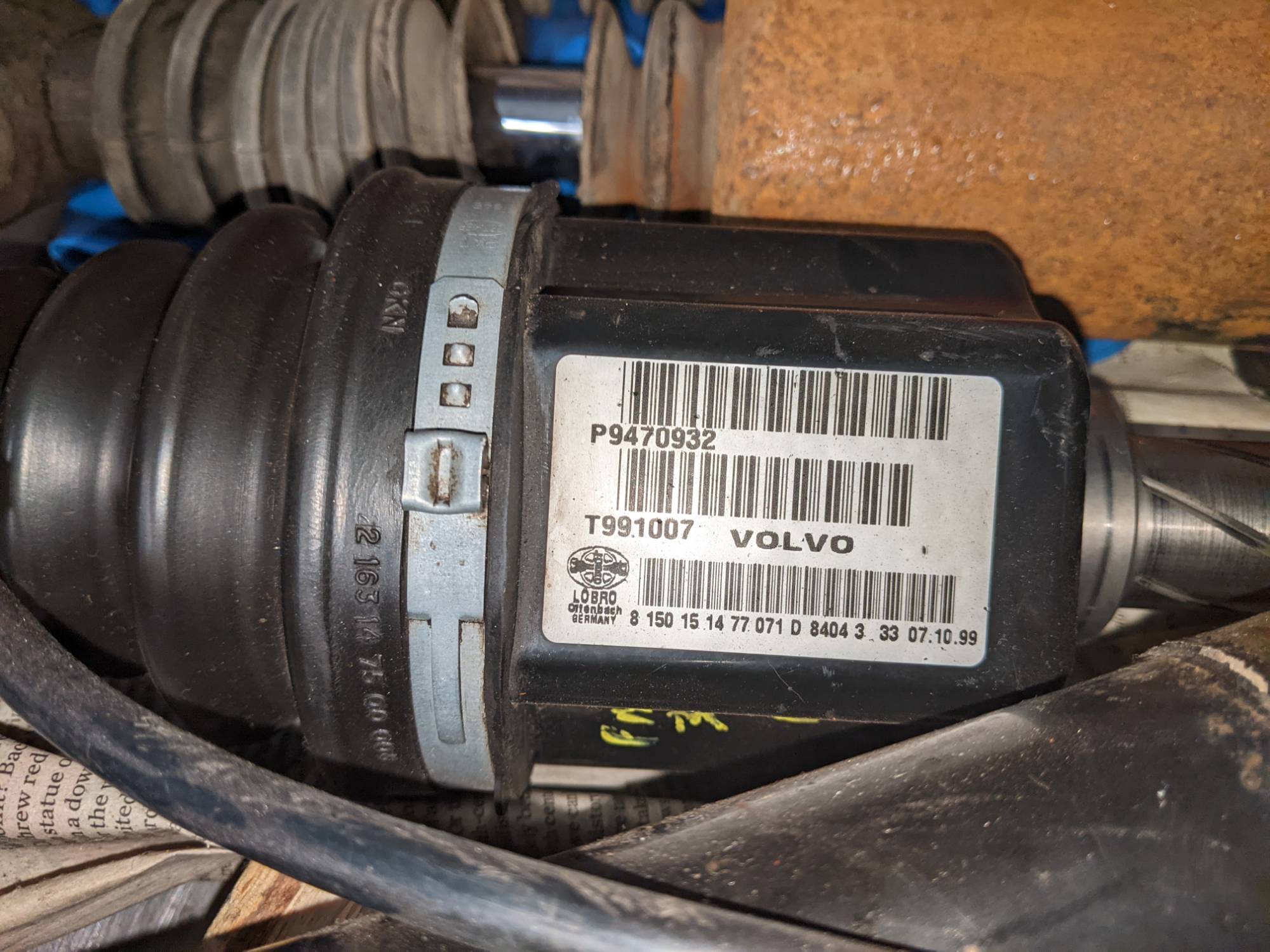

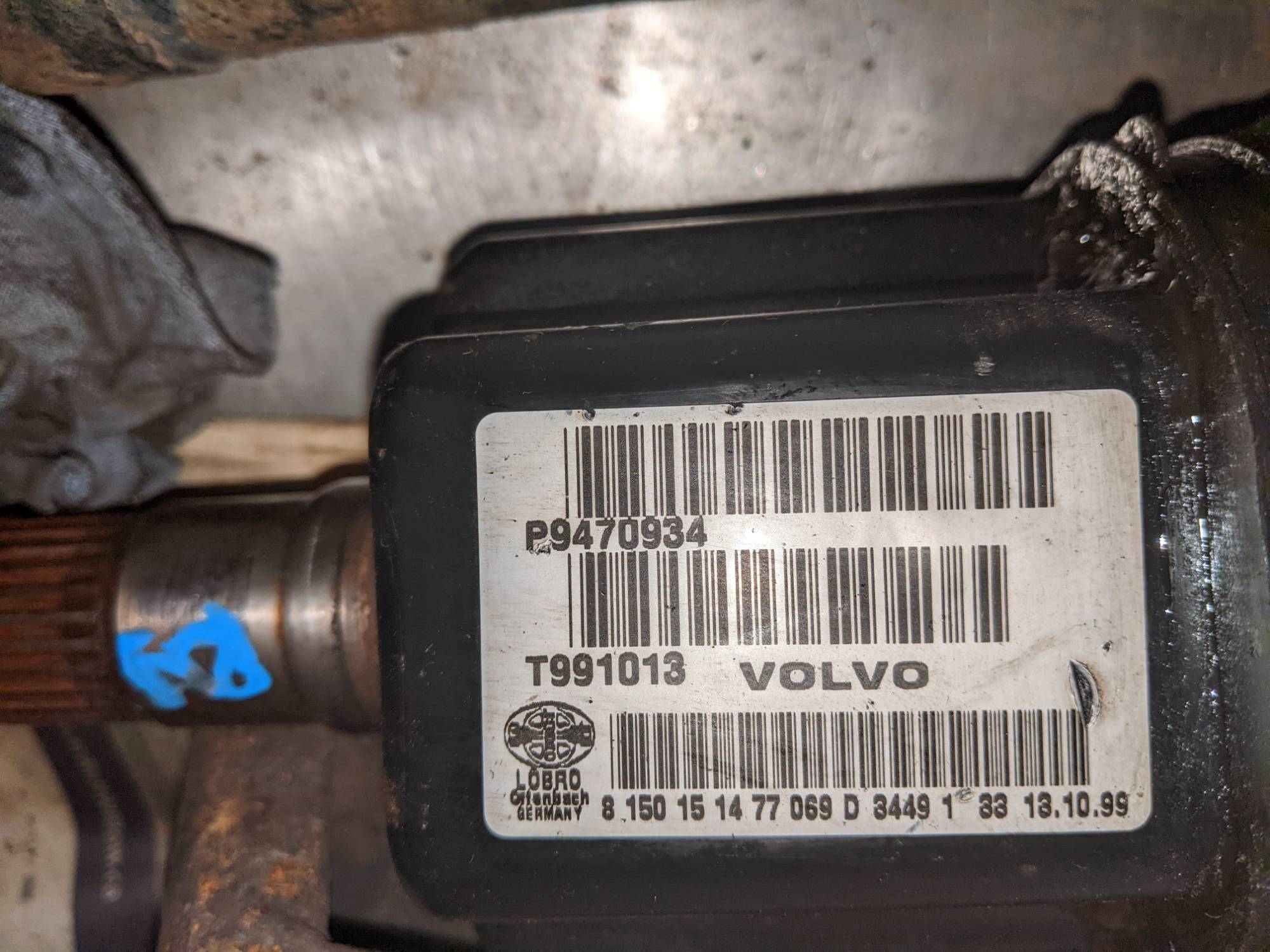

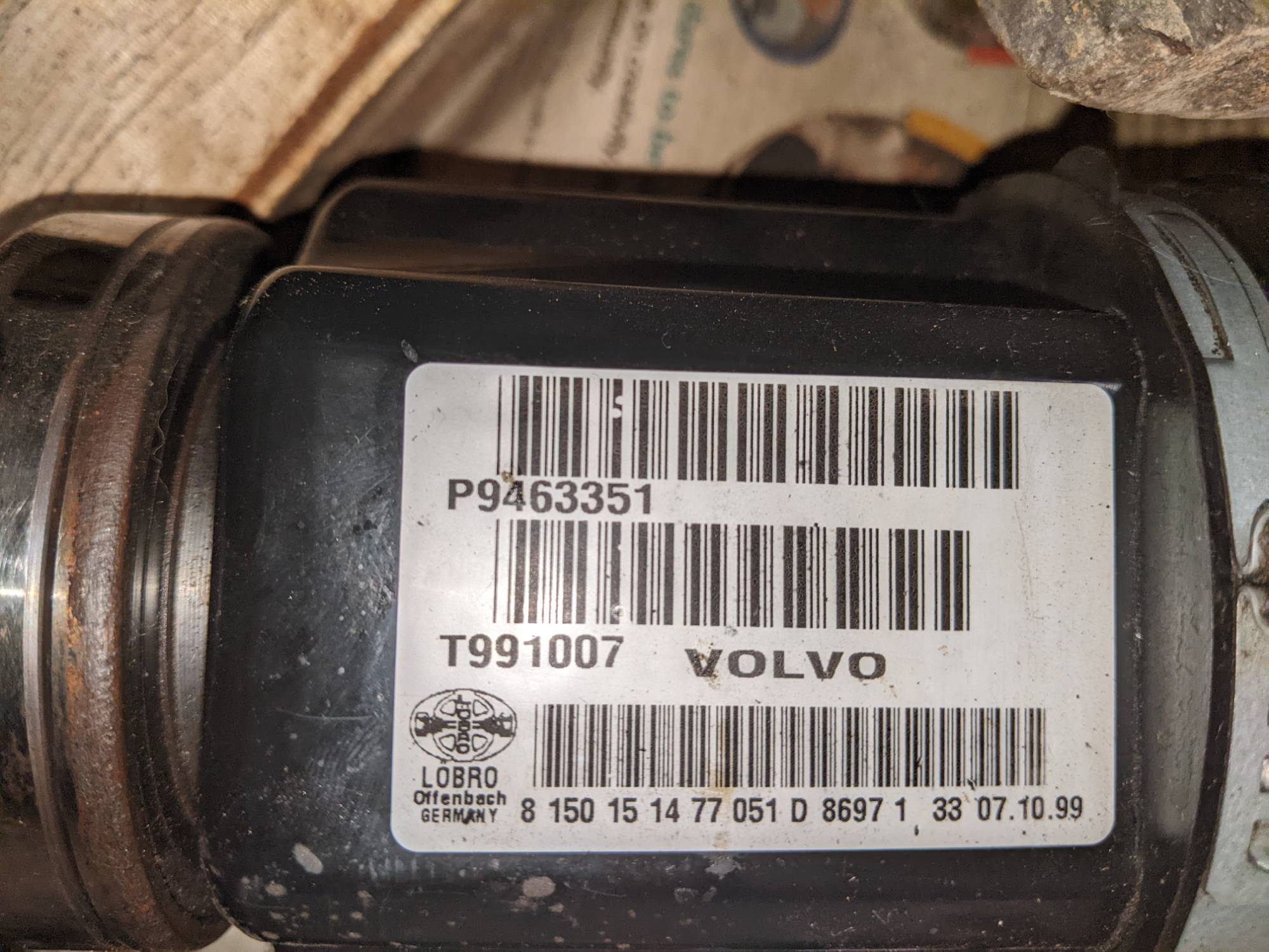

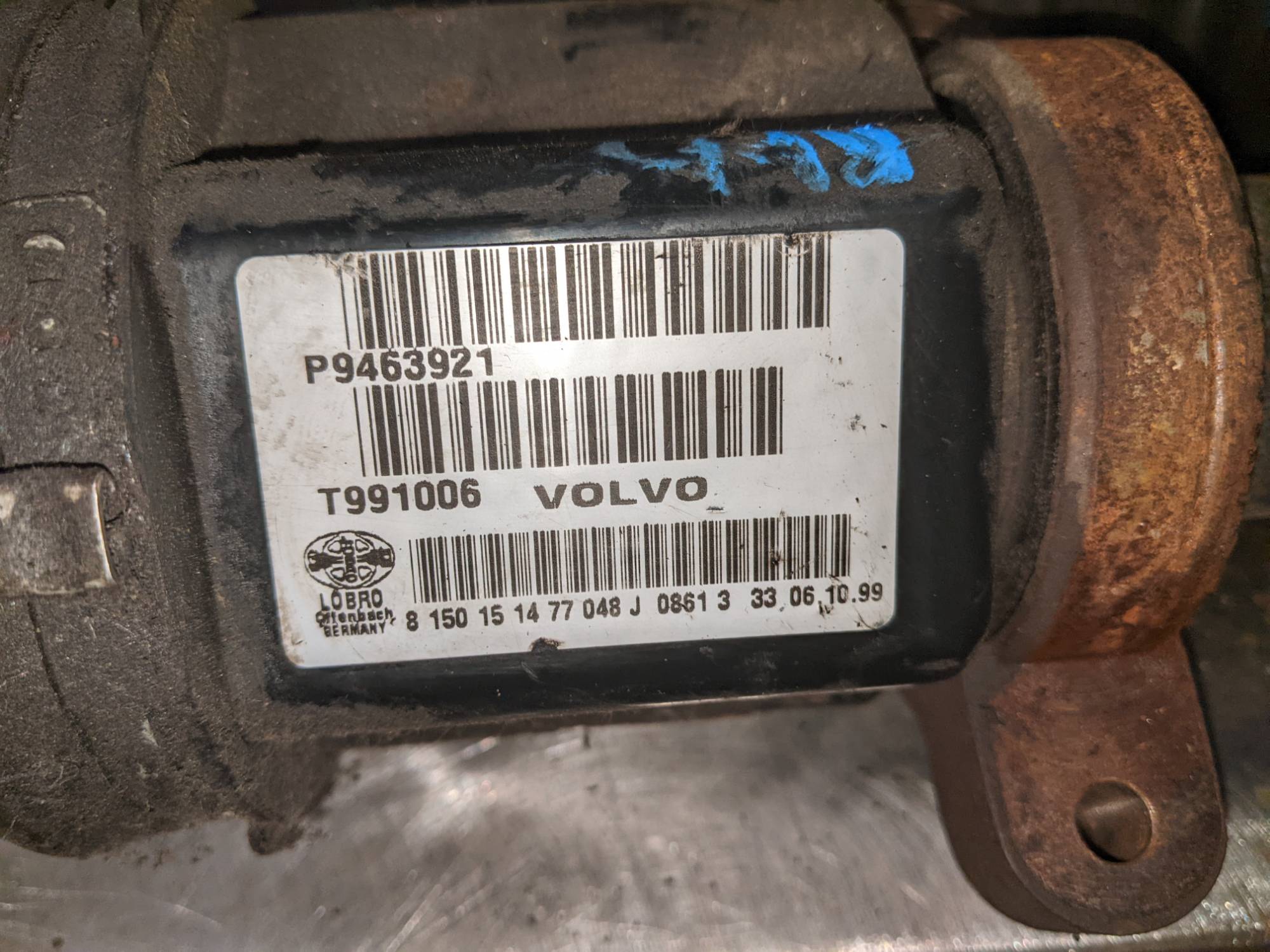

I have had a really nice pair of front axles from a 2000 V70XC on my workbench for a while. I cleaned them and am building storage for the various axles I have. I was told (can't remember by whom) that all turbo axles fit all turbo engines, especially the LH one. As these were so nice I pulled them and would have been quite happy, until I may have needed them for my 2000 V70R AWD.
When I was tempted to the junkyard last week by 2 x 2000 V70R's in one yard, I saw one of them had nice what looked like fairly recent axles, and even though some idiot had dropped the subframe without disconnecting the suspension and managed to pull the inner CV boot off, I decided to take them as is as this yard was only charging $60 CDN ($45 US) for a pair of axles!
Glad I did as I had some time just to look at them and had them on the bench with the other 2 and discovered they are both different!!
Part numbers are one give away, but also I discovered the ends are different, and the long RH axle, the support bearing is in a different position and the section that goes into the automatic transmission. I'm thinking the slight length differences may be down to the V70XC sitting higher than the regular AWD cars? The other shoe dropped as I realized that the V70XC had a 4 speed auto for the P80 run, but the 2000 V70R has a 5 speed auto. I think the 2000 V/S70 base models were the only other model fitted with the 5 speed auto!

2000 V70R RH front axle part number
2000 V70 XC RH front axle part number
2000 V70R LH front axle part number
2000 V70 XC LH front axle part number
Sorry, I see 2 of the pictures are flipped. I realized that the labels were the opposite direction before I took the pictures so turned the camera 180 to take the pictures. When they uploaded to my photo file they were upside down so I flipped them in my photo file before uploading to MVS. For some reason it flipped them upside down again??
So I reckon I now have a good pair of 2000 V70 XC axles, which may fit a 99 as well as they used the same transmission, a 98 would need some checking!

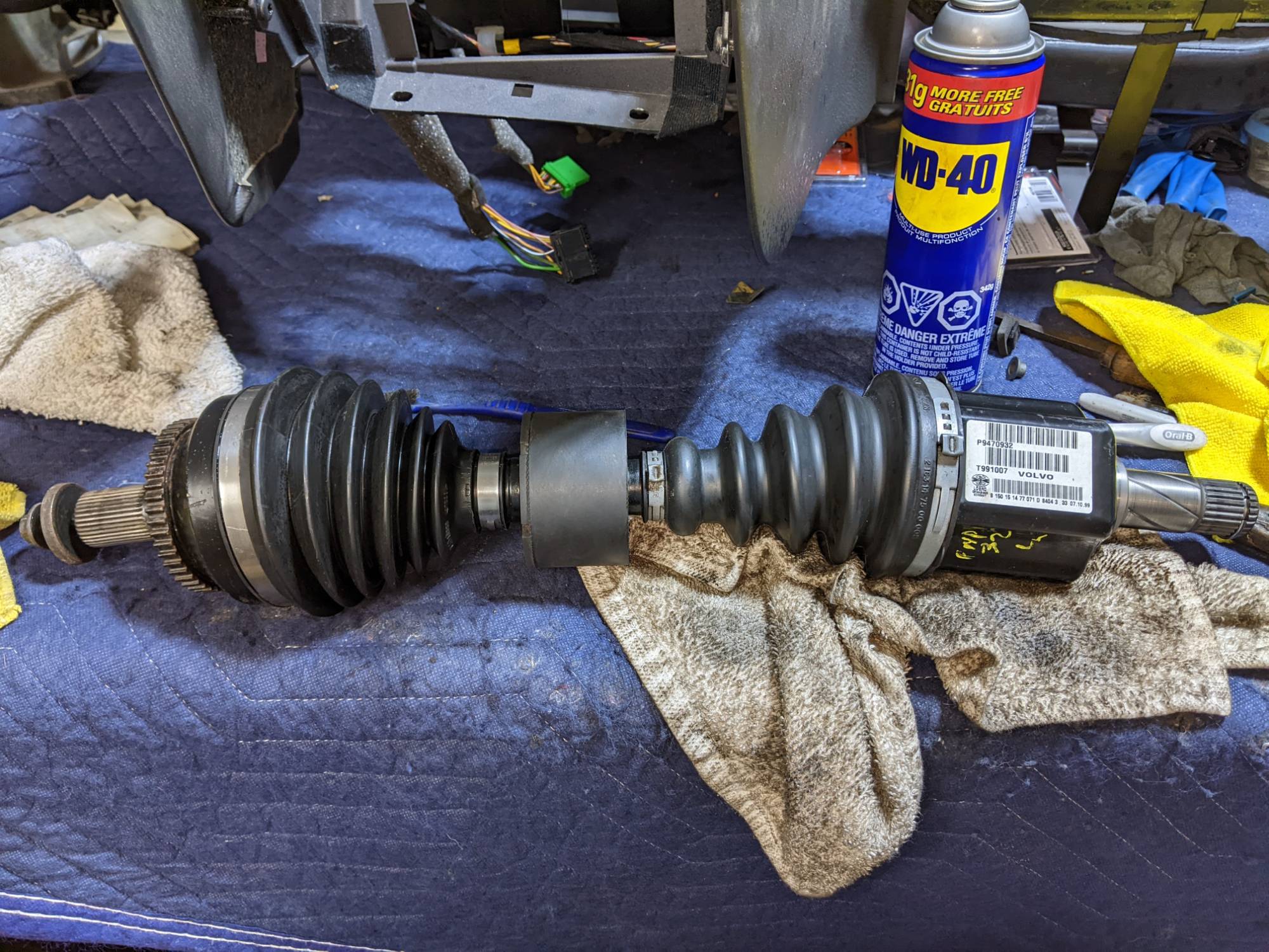

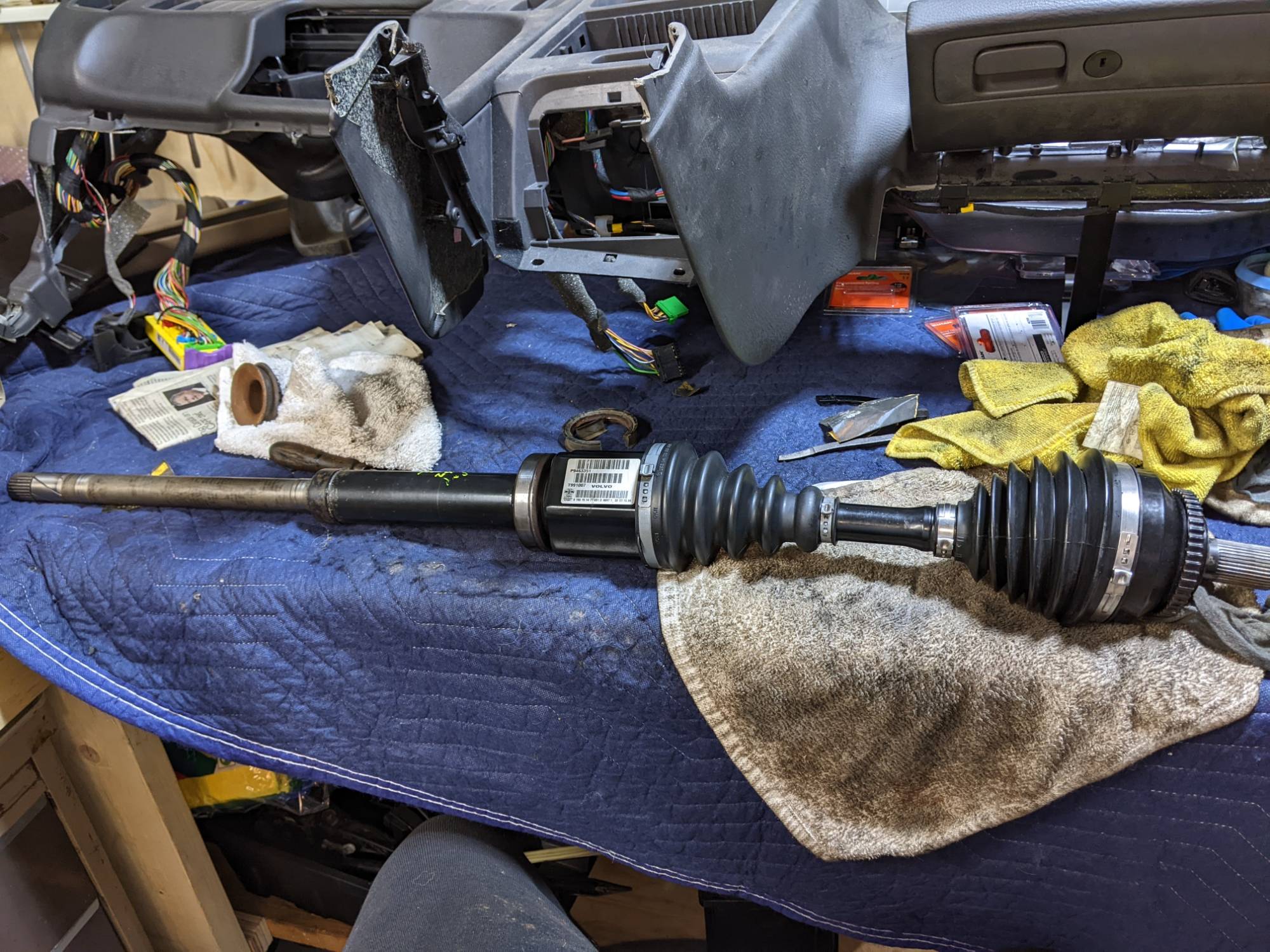

These are older photos before they had a coat of automotive rubber protectant. They now look even cleaner and shiny! :D

Bookmark to punch those part numbers into text for search …..
2000 V70 R
P 946321
P 946351
2000 Xc70
P 9470934
P 9470932
Separating the P as I don’t think that shows up in parts engines, conjecture

You are correct on that. I believe the P is to signify the P(art) number.
