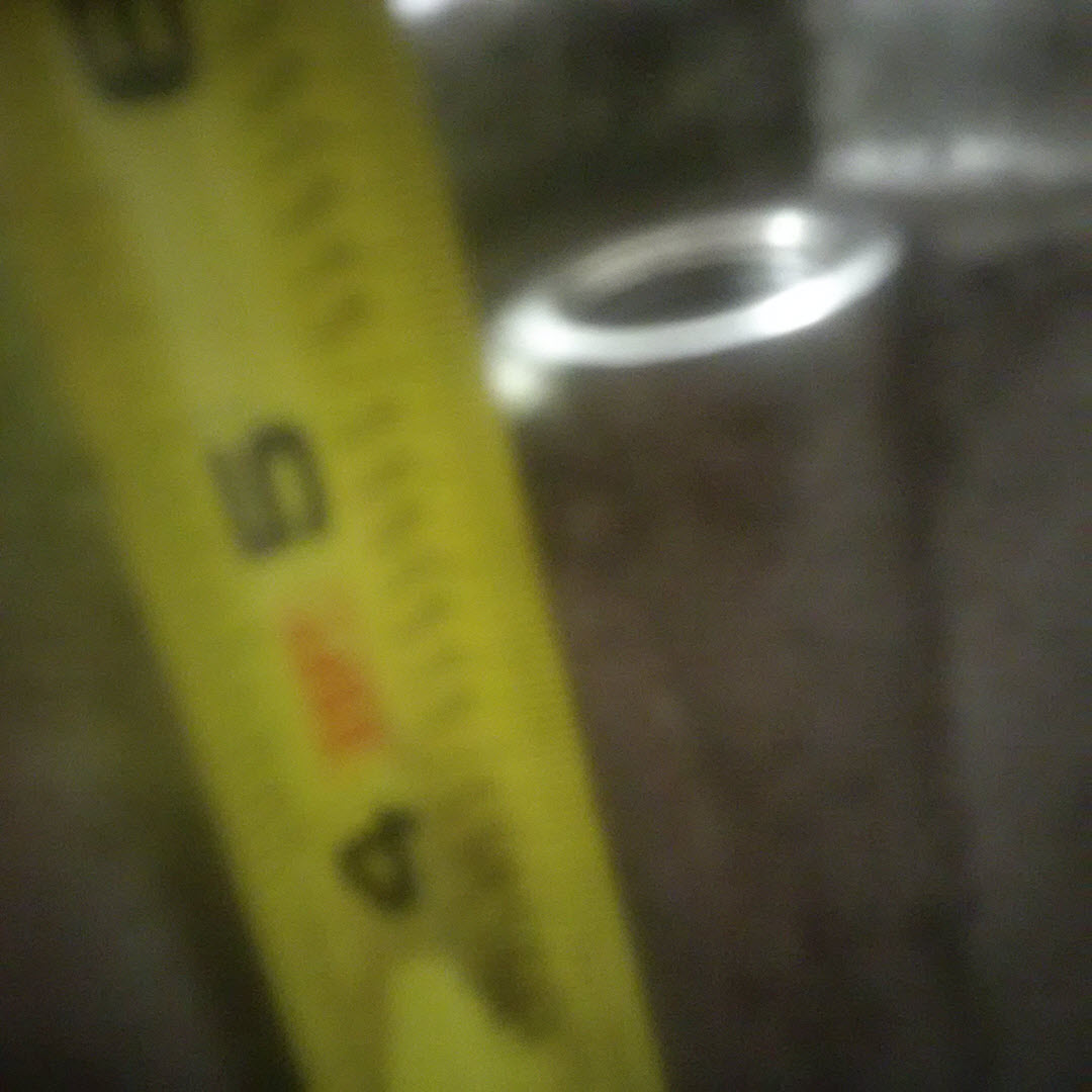

Later today I will snake a camera into the drain hole of the one I have on the bench to see where the screen is and what it looks like. Should be black. Car did not move.

Tried camera
. Could not really identify anything. I will stick a coat hanger wire in there and see if I can feel the screen.

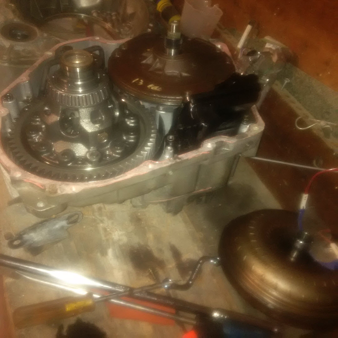

Great news. I was able to open the bell cover on my bad trans that I have on the bench. Took filter out and I cut a hole in it. I did not make a big enough hole in the plastic filter yet. I cut about a half in by 1 inch. I agree, at first look it seems like nylon. I actually used a small drill to cut the plastic open using small holes next to each other. I mention this because the bit penetrated the screen effortlessly. I need to cut it open bigger.

Some Pics. But need to get a piece of filter fabric to see what chemical can dissolve it too. Let me know what you think I should do next??

Pics. 2004 C70 Automatic Transmission. Car would get hot and not move due to this problematic transmission. I swapped in a low milege one and a new valve body and sold the car. Phone does not take great pics. Sorry.
Drain plug top to bottom is 5" but figure about 1/2 extra space from the separation of the two sections (so it is really about 4.5 inch from top of drain plug to base.)
