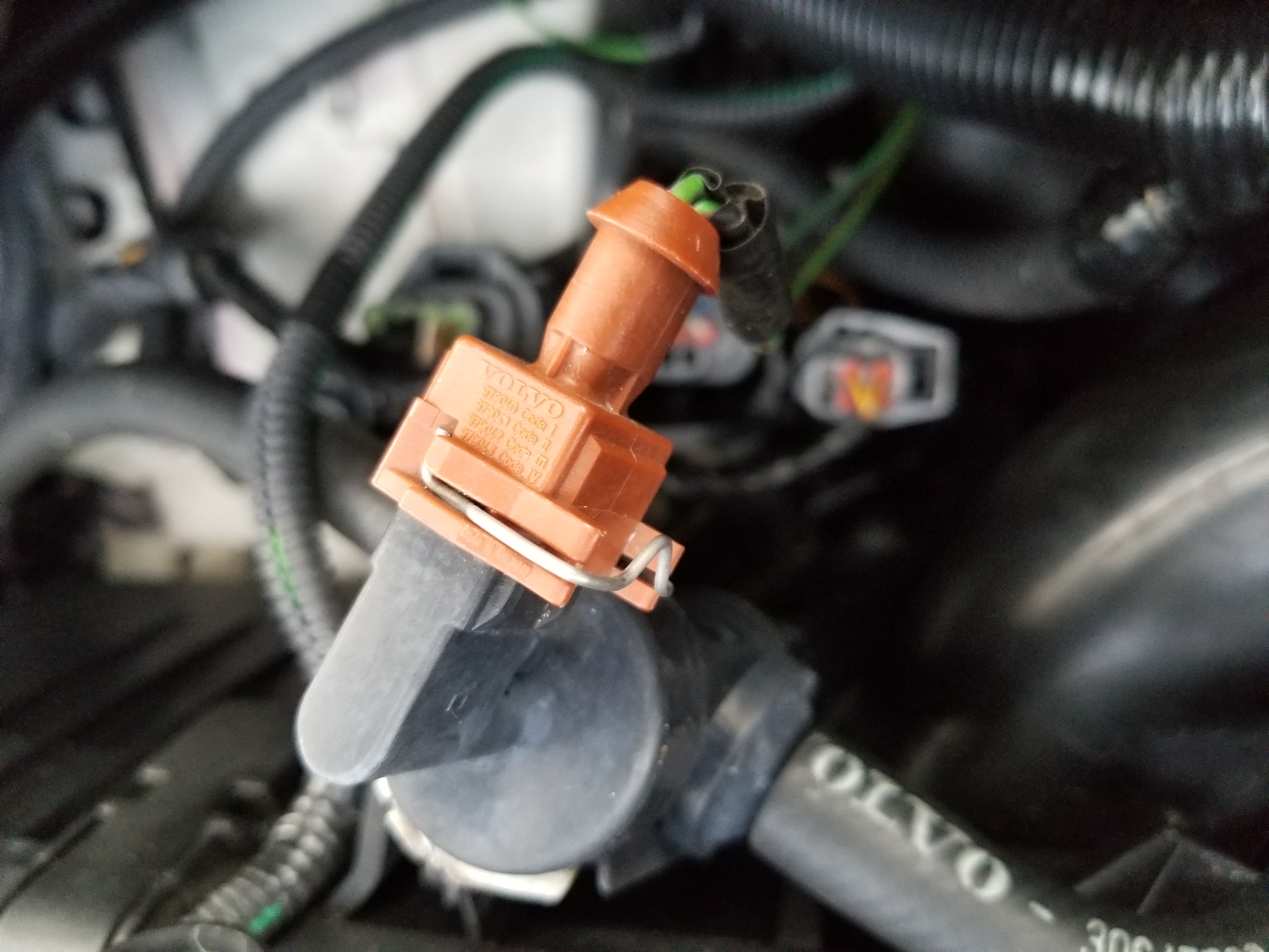

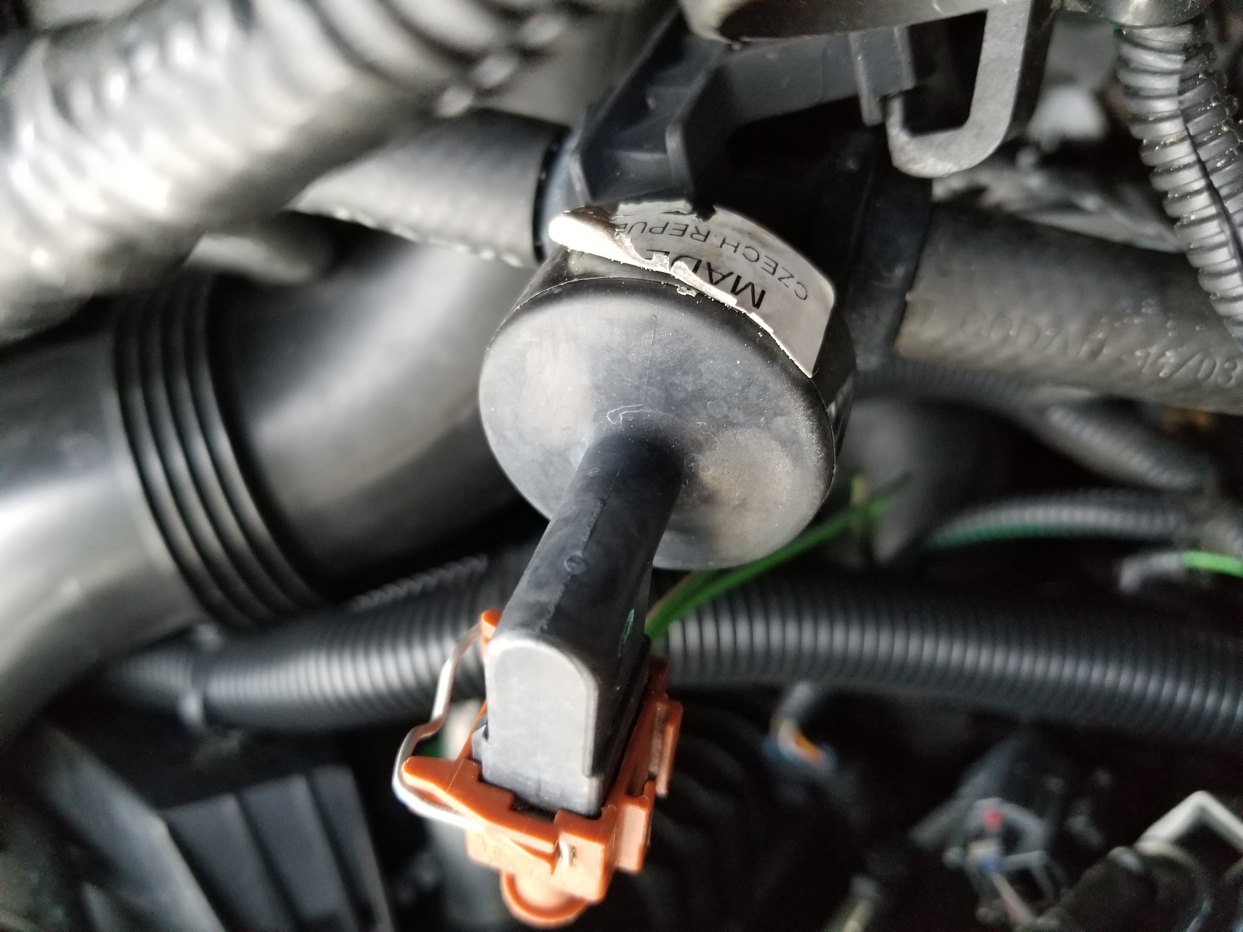

Definitely a vacuum leak. Primary suspect the sensor valve in front of the air cleaner box, known to fail.

This pumps goes bad when there is a vacuum leak at the brake booster. As the booster vacuum drops below a certain level, the pump kicks in to bring the vacuum back to the level. However, because of the leak, the pump runs way too much and wears out (the brushed wear). Usually, the pump will run after shutting the engine off (will run intermittently for 5-10 times), or when the car is started in the morning, or when the car has just been parked and the brake pedal is depressed. Sometimes the pump can be heard running even while driving the car.
Check first the pump switch, the top plastic can break loose. Make sure the connector is fully engaged as well.
Before suspecting the diaphragm inside the booster, there are two or three places where the leak this happens: under the grey bellow inside the car, at the vacuum hose from the pump where it gets into the booster (a rubber seal), or at the diaphragm position switch seal (the sensor right near the master cylinder).
But the most common is the seal under the grey below, it gets dry then gets torn. It better to lubricate this seal before this happens with the Volvo grease #1161688 only.
