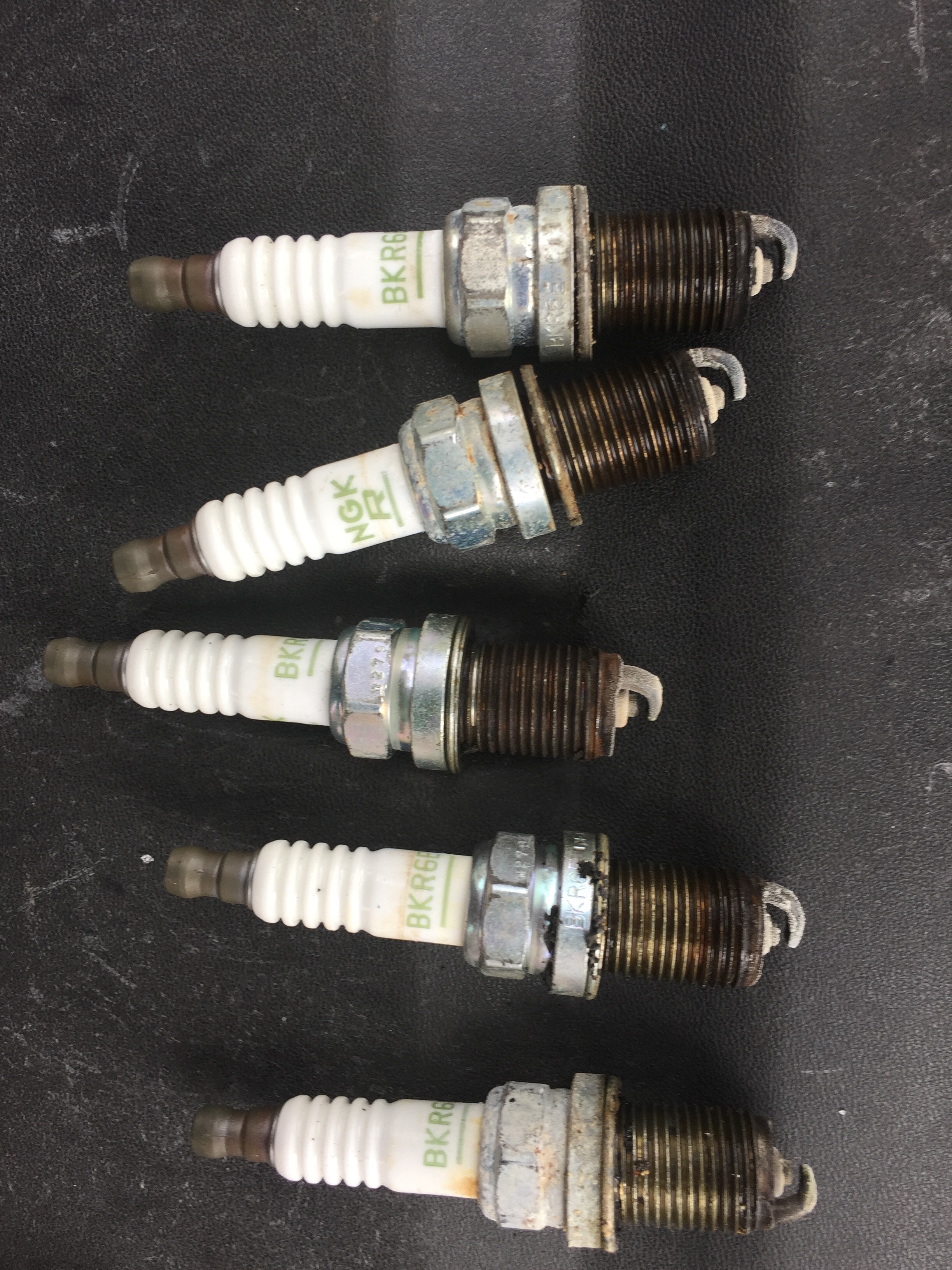

Not to turn MVS into the j-dawg Diagnostic Adventure Notebook, but I popped the plugs on my Tee Five M to check compression and checked the gap while I was at it. They were all down to like .035-.040. It's probably been 10,000-15,000 miles since I gapped 'em.
Does that seem reasonable? I've never owned a car long enough to remove the spark plugs twice, so I have no experience in this.

Sounds a bit faster than my wear but did you gap them when you put them in or install from box? ( no judging)

I never changed 'em. I think they were changed like 50k ago, can't find my maintenance notebook. I pulled, regapped, and reinstalled them about a year ago.

Updated on my NGK which had 47000 on them, were regapped at 27000, now reading 035-040
Replaced with new Bosch Cu single electrodes

Turbo cars, pre '01 I use 0.028.... '01 and later, 0.030. All cars run great on Volvo plugs. I've not had any good experiences with any other. The Bosch plats are fine but they tend to have to be changed sooner so the money saved up front is lost on the tail end when you have to replace them. I've had good luck buying Volvo plugs on eBay of all places. Better than FCP or Eeuroparts... Most of our Volvo's use the same plugs- I keep an extra set handy and I never clean and re-use or re-gap any of them. Just gap them up front and never trust that they are all gapped correctly out of the package.
