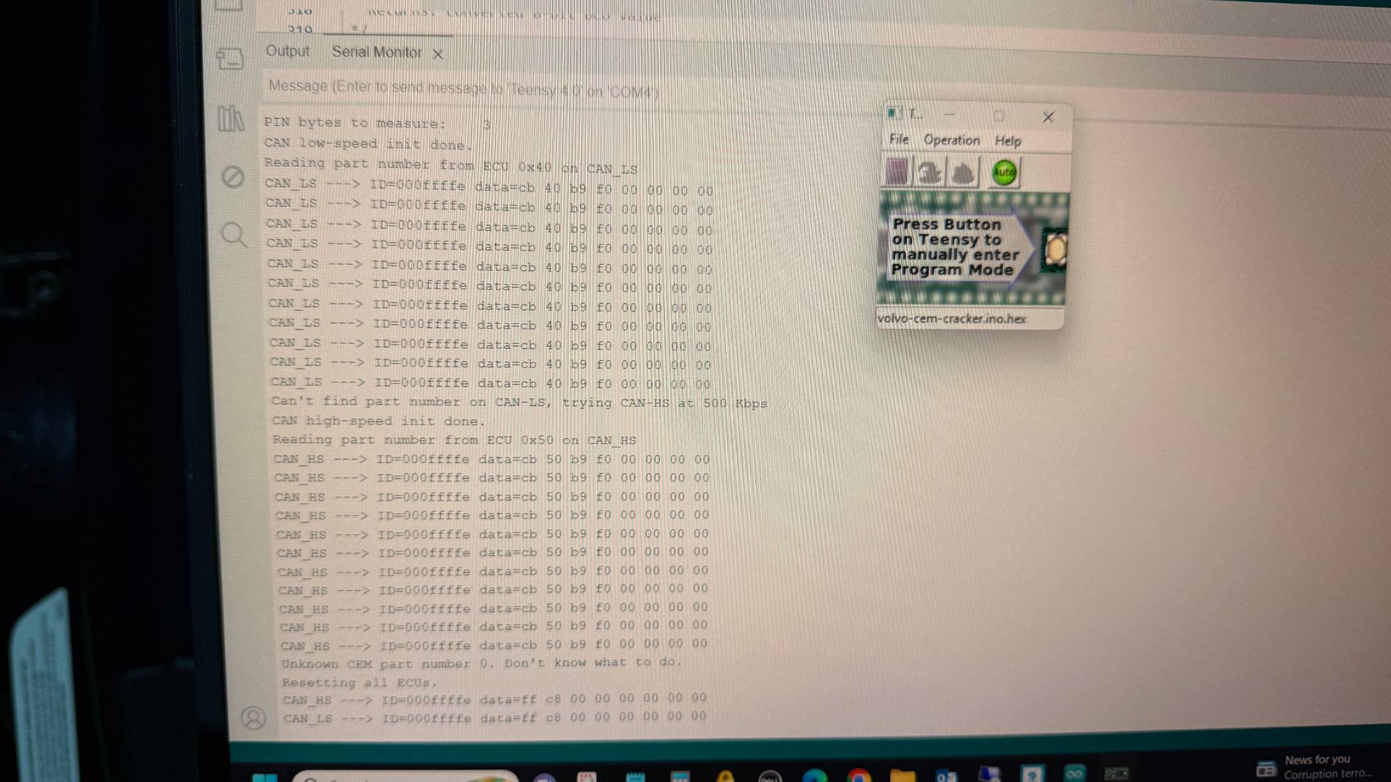

danthe88
Posts: 7
Joined: 27 November 2024
Year and Model: 2006 XC90
Location: MNE
Post by danthe88 »
Hello everyone, I’m having trouble extracting the CEM PIN.
Today, I received all the components and assembled them, but I’m encountering an issue when trying to extract the PIN. I’m getting the following error:
Code: Select all
 Unknown CEM part number 0. Don't know what to do.
CEM part number: 30765643
Does anyone know what might be causing this?
I read somewhere that the CEM PIN can’t be extracted using a Teensy 4 if the K-Line is not present on the OBD (which is the case for me). Can anyone offer advice on how to make this work?

Post by Treur »
dikidera wrote: 27 Nov 2024, 13:55 It will take me a while as I familiarize myself with the M16C/M32C architecture and memory layout. There is certainly fairly readable code and what IDA disassembled as a chain of BRK instructions, which don't seem legit(though could be for one reason or another or could just be encrypted code or some form of data).
As far as I know, the M32 processor itself does not have built-in cryptographic functions, so encryption is only possible through custom user code.
Treur
Posts: 126
Joined: 16 November 2024
Year and Model: 2007 V70
Location: Estonia
Has thanked: 3 times
Been thanked: 6 times
Post by Treur »
danthe88 wrote: 27 Nov 2024, 14:00 Hello everyone, I’m having trouble extracting the CEM PIN.
Code: Select all
Your CEM don't need K-line. Check connections/transceivers. In my case working with 5v transceivers with no problem.
danthe88
Posts: 7
Location: MNE
Post by danthe88 »
Thank you for your response. I’ve thoroughly checked the connections multiple times, and everything appears to be in order.
Regarding the transceivers, I’m not completely sure how to test them, but since they’re brand new, I would expect them to work correctly.
Just to clarify, are we certain this is strictly a hardware issue? Could there be any other factors contributing to the problem?
Treur
Posts: 126
Location: Estonia
Post by Treur »
Replace the transceivers, I had new ones too. New does not mean working. Chinese 3v transceivers are 99% garbage.
