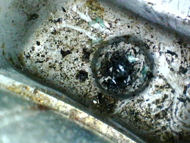

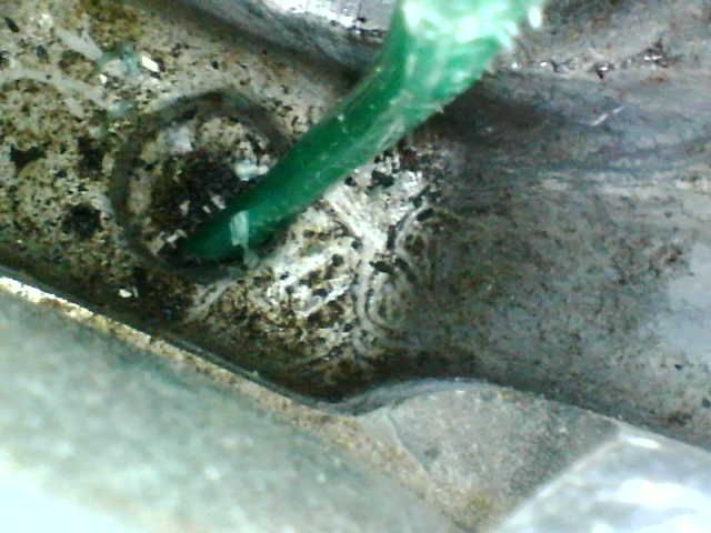

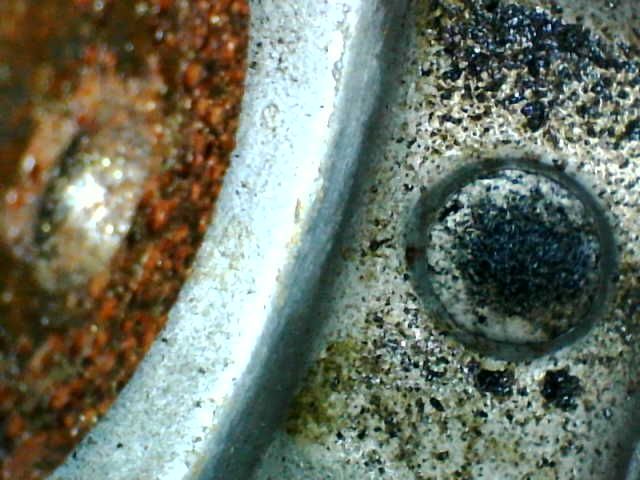

Interestingly enough, someone on Swedespeed did a scope on his engine and in my saying it was not possible, I learned that indeed it is. Perfect chance to use the cheap $40 semi-rigid wifi scope that I bought on a whim.
It's important to note that I thought the hole was there and plugged with debris, why I put the wire down.
As I ran that wire (aluminum end was expose 3/8") all around, I made a point of catching as much of the bottom as I could. At one point the wire is resting against the edge so that I could keep things stable to get get a photo.
The shiny marks are aluminum, there is no hole.
My 08 (0748) Sport V8 SN 32604 V8 (PN 6906091) has no weep hole. It has a casting impression that would like have been for a hole but a hole was never drilled. This is my original engine.
See image for general orientation of the CB valley

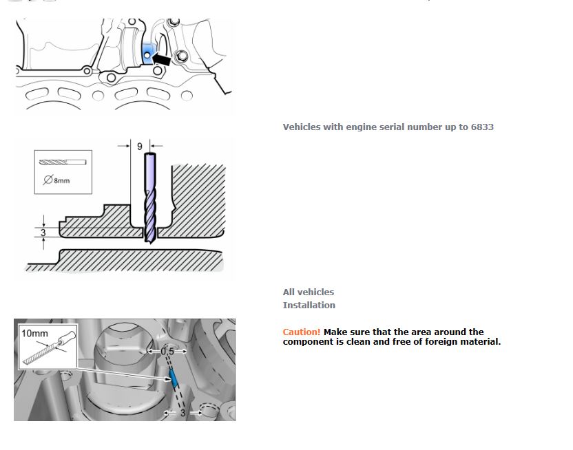

Adding re-work diagram for reference
CB Shaft Rework Snapshot.JPG (57.55 KiB) Viewed 2926 times
edit 090319- add additional images
