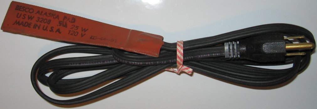

And just to keep things on topic, here are some heat pad pics:
Pad side sm.jpg (35.08 KiB) Viewed 1919 times
Heat Pad - 25 watt.jpg (45.57 KiB) Viewed 1919 times
This is just a 25 watt pad, but you get the idea.
A good, clean surface, some orange high heat silicone
adhesive and you are heating vital engine fluids. 8)

Thanks for the details, BEJinFbk. Didn't even know these pads existed at all. I was able to locate some 120V-rated on ebay. As I need 230V versions, I still have to search a little bit. Or I could just get 2 of them and wire them in series...
