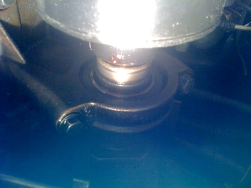

Turbo Oil Leak *pic*
I've been trying to find this leak that I am having. So far I had changed the transmission filter, and thought the leak might be coming from there. The power steering reservoir was my next guess so I tighten the hose, still keep dripping... so I assumed it must be the steering rack. So I decided to put the car on a lift again and patiently wait for the leak to drip. I surely didn't come from the steering rack but from the transmission shaft where the bearing was. I said to myself I'll get a mechanic to look at it, and he said that it is coming from the turbo oil line. So far all my fluids are right on the mark, and the car is running fine with no codes. This leak is just annoying me. Is it really from the turbo? Or could it be from the transmission? How hard is it to fix these? Anybody here have had these issues before? I have been using this site as a great source, thanks so much for all the helpful information.

That looks like red fluid to me. If it is red, it's not from the turbo line because the oil would be black or brown - it would have to be transmission or power steering fluid. Could it be leaking out of the seal at the transmission and migrating down the shaft to where it drips off? If it's a bad transmision seal, you have to remove the shaft, pull the seal out and tap a new one in, then put the shaft back in.
That's exactly what I thought. How hard is it to remove the shaft and change the seal? The leak is coming from exactly where that drop is. Do you have any illustrations on the parts (seal) that are on here? Thanks

This page shows how to remove the shaft on the left side: https://www.matthewsvolvosite.com/forums ... hp?t=15872
The right side is the same, except you have to remove the two bolts holding the intermediate bearing. You can skip some of the steps if you are just pulling the shaft out. Once you get the axle out, you need a special tool (available at your local auto parts store) to pull out the old seal. You can tap the new one in with a large socket or a special tool. Make sure you don't deform it. If I were going to do all that work, I'd install a new shaft and hub while I had it apart, but that's just me.

I will try that and hopefully that will solve it. BTW do you happen to know a good Volvo shop around here, just incase this happen to be out of my league. Thanks for sharing the knowledge.

I used Volvo of Las Vegas, the dealership on West Sahara. Their work was OK, but the prices are high, as they are with any Volvo dealership. They seemed to be honest. As a matter of fact, I paid them to fix a turbo oil return line leak that I had. It was a real turbo oil line leak and the oil was brown, not red. The part is cheap (just a seal) - the cost is in the labor to take the line apart and put the new seal in. It hasn't leaked since. This was before I started doing my own work, of course.eM3RgE wrote:BTW do you happen to know a good Volvo shop around here, just incase this happen to be out of my league.
