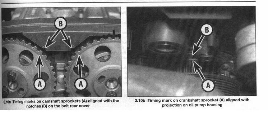

Hi folks. I sold my Immaculate 850 turbo wagon to a guy on ebay. It's a 1994 with 56k original miles-like new condition. He buys it-flies in and I spend an hour going over the car with him-he then drives it for 3 hours-pulls over and the engine is cooked. I give him all his money back and reclaim the car. Turns out a heater hose split and engine lost all cooling while he continued to drive it at 75 -completely smoked the motor. Obviously he wasn't paying attention( or high) but now my friend-a very good mechanic-is rebuilding it for me and he has never worked on the Volvo 5 cylinder before. He has the following questions:
1. Setting the cams-there are slots on the back-when properly aligned are the smaller 1/2 circles on the bottom or top?
If cams set correctly-firing order start on #2 piston?
2. No timing marks on Cam pulley's-just W or M letters as mark-use these? Cannot see a slot or line mark
3. Will overheating the motor destroy the knock sensors? Should we replace or re-use?
We are still baffled by the fact that no codes were stored from the engine melt down-any thoughts on that? Thanks for your assistance! Should be a sweet motor when done.

First thing is to check the head for flatness, I'm sure your mechanic will do that as a matter of course. Timing marks I've included a picture showing both top and bottom timing mark line up locations.
Timing marks Cam.JPG (56.43 KiB) Viewed 951 times
Both Cam sprockets have a slot marks on them to line up cut out arrows on the rear of the plastic cam cover.
I would imagine you stand more chance of warping the head before destroying knock sensors I don't know the test procedure for testing knock sensors I would rebuild the motor then see if it returns codes for knock sensors.
