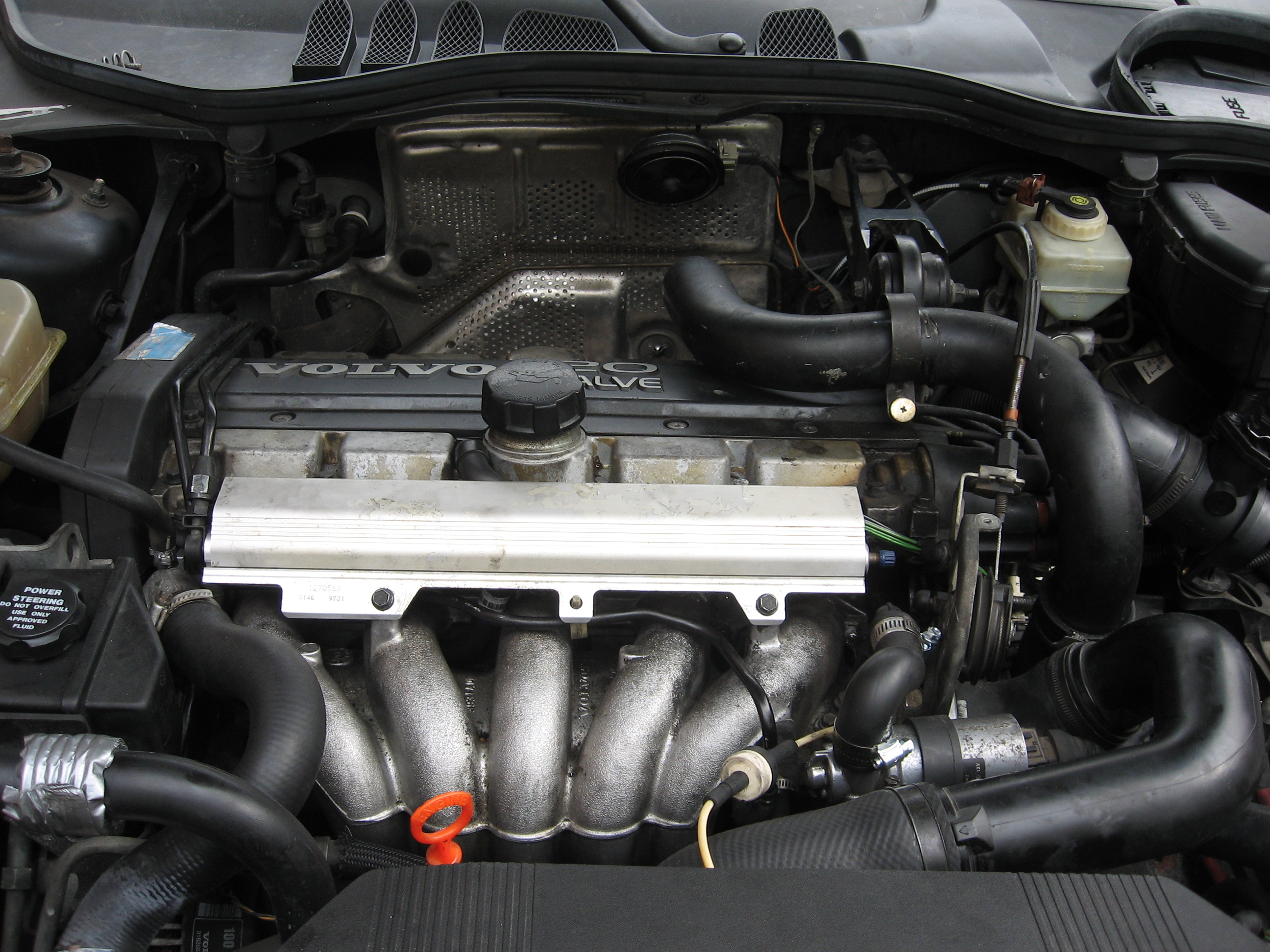

Step 1: Drive your car up on ramps (I highly recommend ramps rather than jack stands). You'll need the front to be elevated to reach the lower manifold bolts.

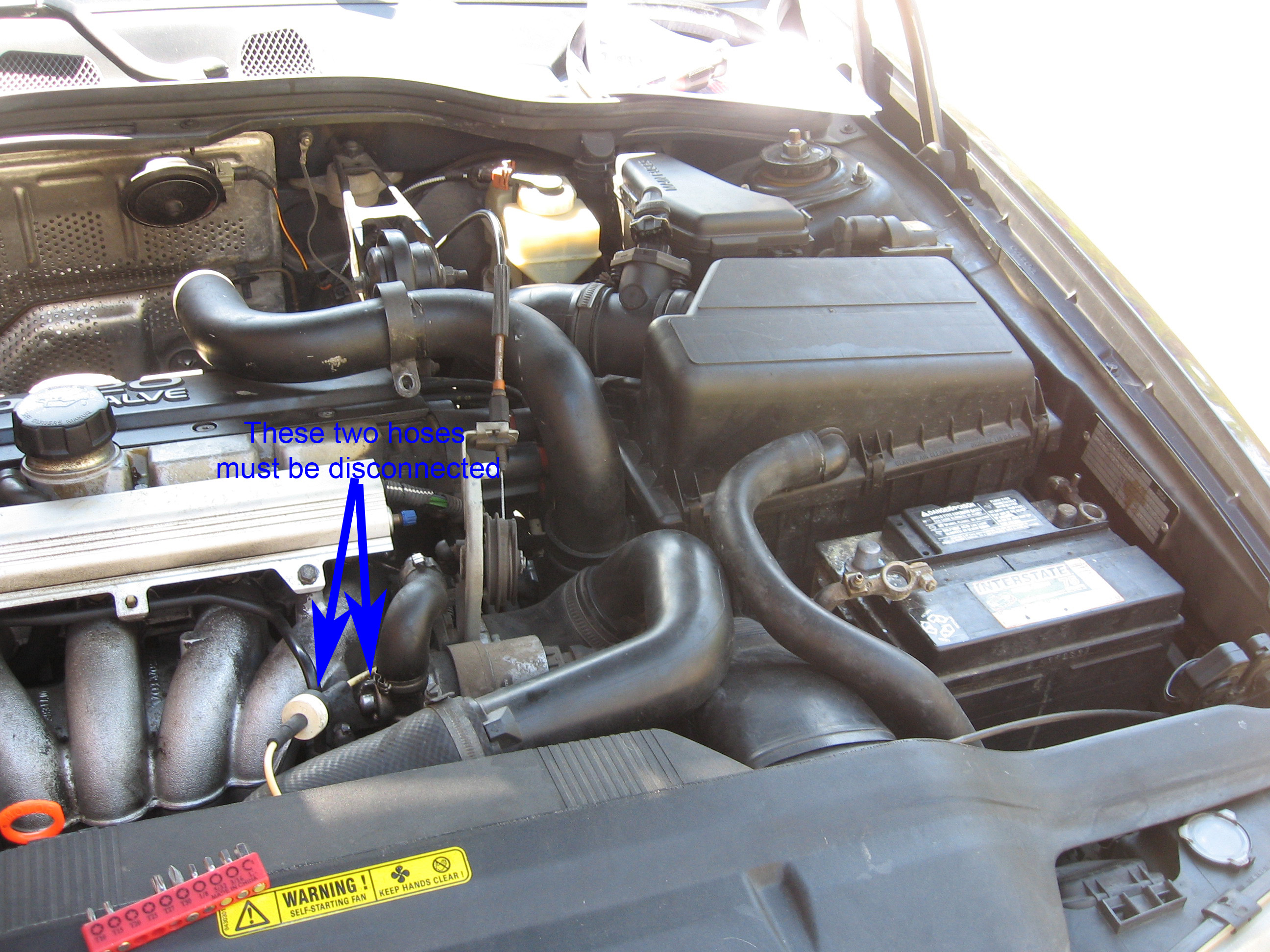

Step 2: Start removing components. I disconnected my battery and removed it from the car for extra space (negative cable first), then the 3 hoses and electrical connector from the back of my air box. Your car may be different here, I have a SAS injection pump, and on non-turbo models, there are two vacuum hoses on the back of the air box. Make note of the orientation of these, they control the air box thermostat flap. If you have never removed the air box before, just disconnect the hoses (two torx screws hold the MAF sensor to the box, the other two pop right off), grab the airbox and shove it towards the engine. This will let go of the clamp holding it to the fender, and then you can lift it right out.

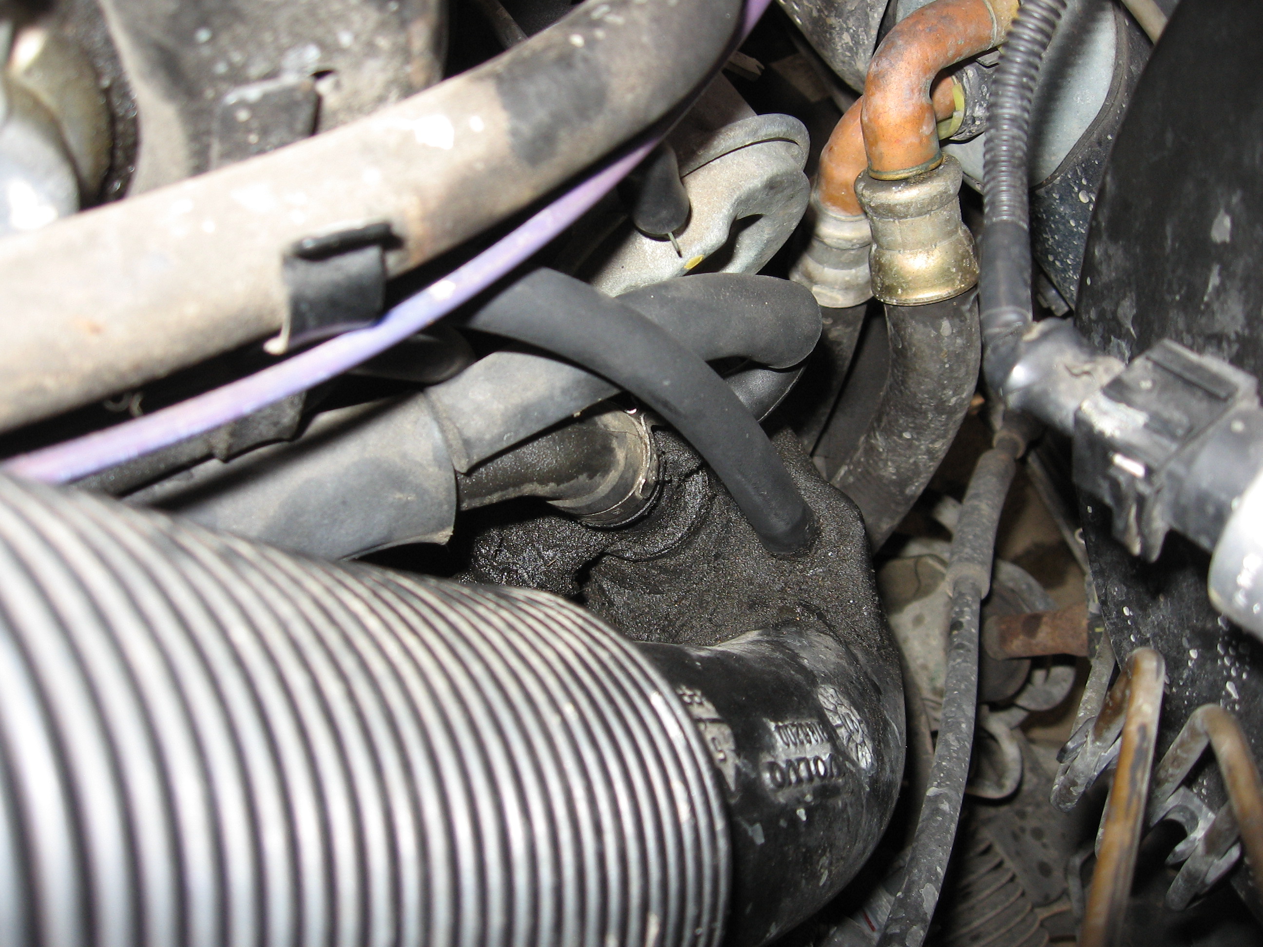

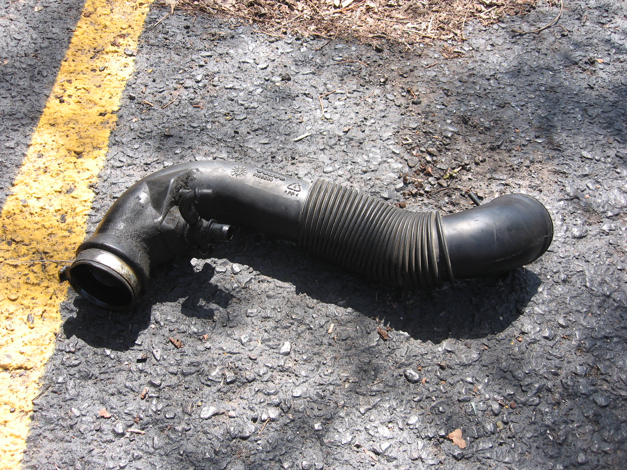

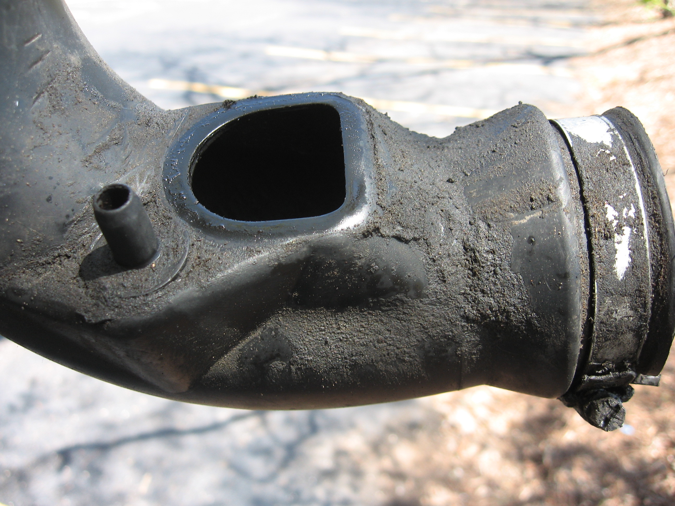

You'll also need to remove these two turbo hoses if your car is a turbo model. The front one connects to the underside of the idle control valve (silver cylinder). I removed this hose and the idle control valve to clean it as well - you can spray carb cleaner straight through it and it will do a good job. The original Volvo hoses have 7 mm clamps on them, most of which can be gotten to with the small socket wrench. I find it easiest just to remove the hoses and leave the clamps on the ends so you know where they go later. I had to take a small 7 mm wrench to the back one by the turbo, because there is no room for anything else.
Removed turbo hoses & air filter box

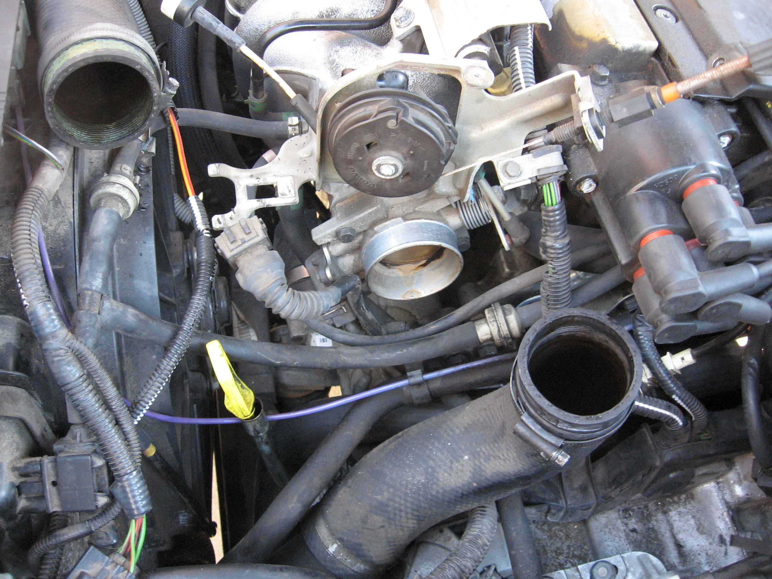

Now would be an excellent time to remove the throttle body and clean it if you have a throttle body gasket. There are several 10mm bolts holding it in. If you don't have one, just hold open the throttle and douse the inside with some carb cleaner and let it run back out.

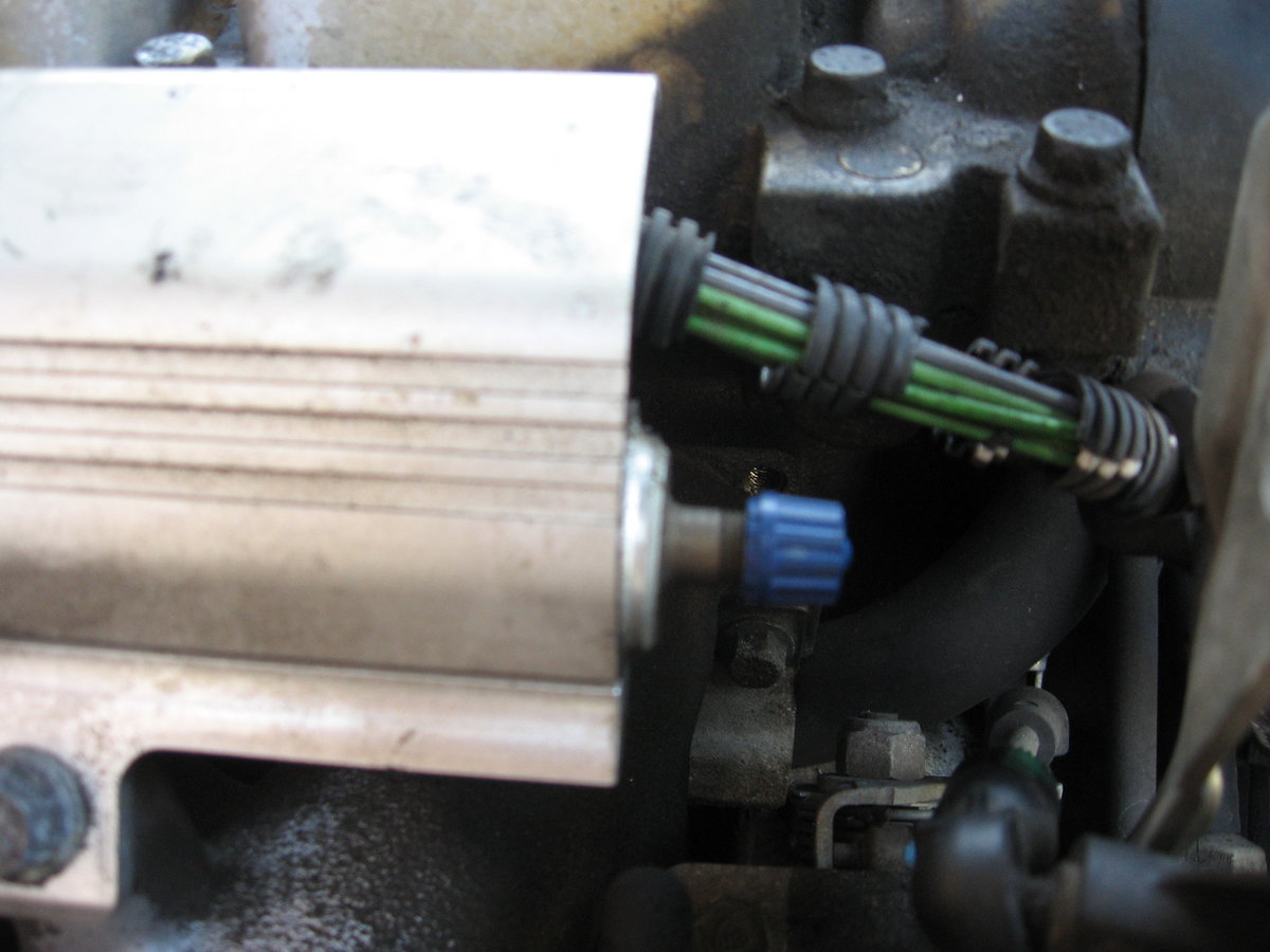

Step 3: Next, remove the idle control valve and electrical connector. The valve is held into place by the clips on the hoses and a rubber grommet on the bottom that simply clips into the mounting bracket. Be careful with the top hose - I broke mine in half because it was so brittle. The clips will come off with a good twist around the middle part of the clip. There is probably a better way to do it without ruining the clip, but I hate those kind of clamps. You can replace them later with the screw-type.
Here is everything out of the way

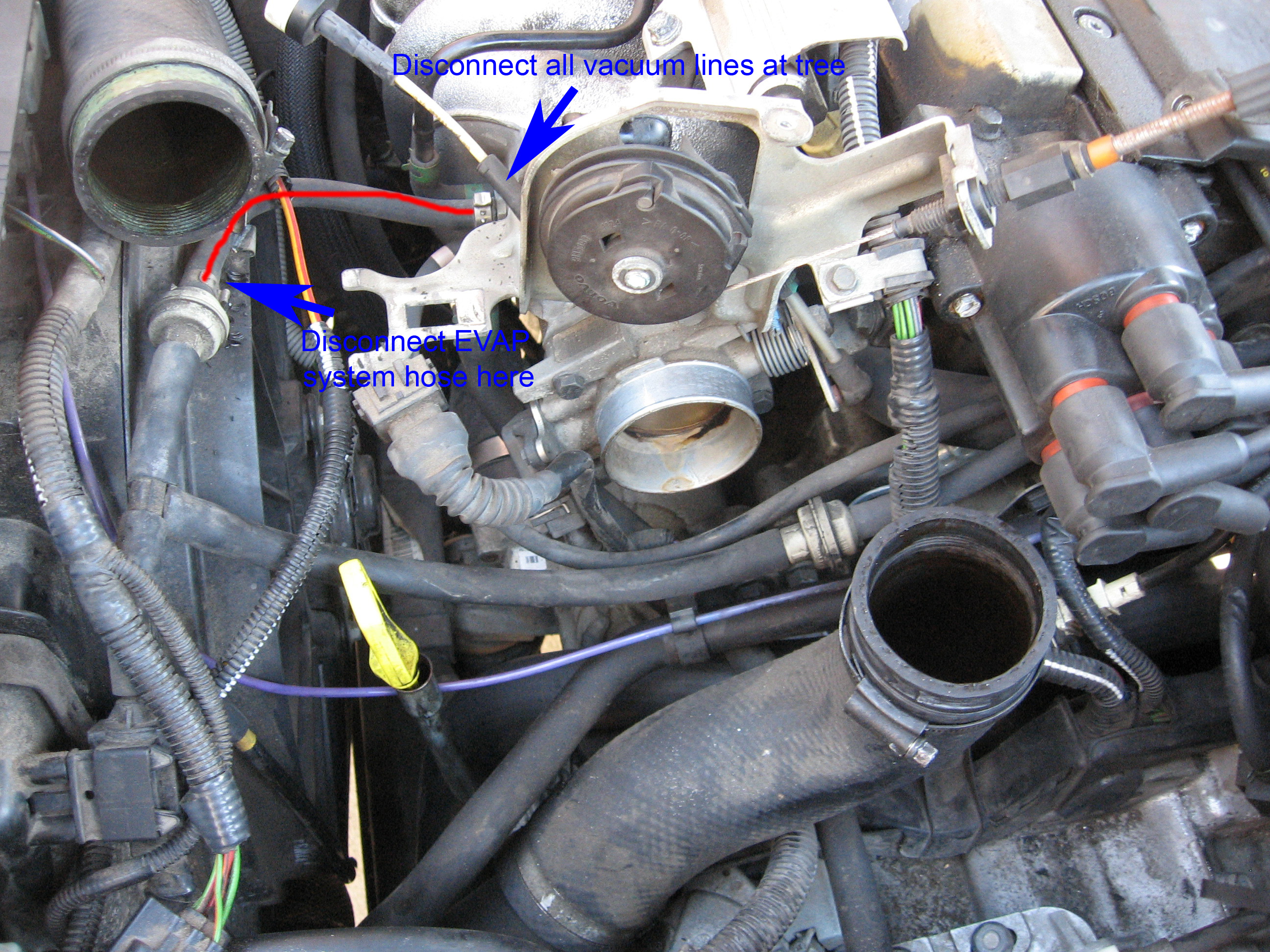

Next, disconnect the EVAP hose running into the engine block. After the white one-way valve will do just fine; the rest can stay connected. The vacuum tree hoses should be disconnected as well - my S70 only has one; those of you with 850's may have 2 or 3 here depending on the year of your car.
Schraeder valve at fuel rail

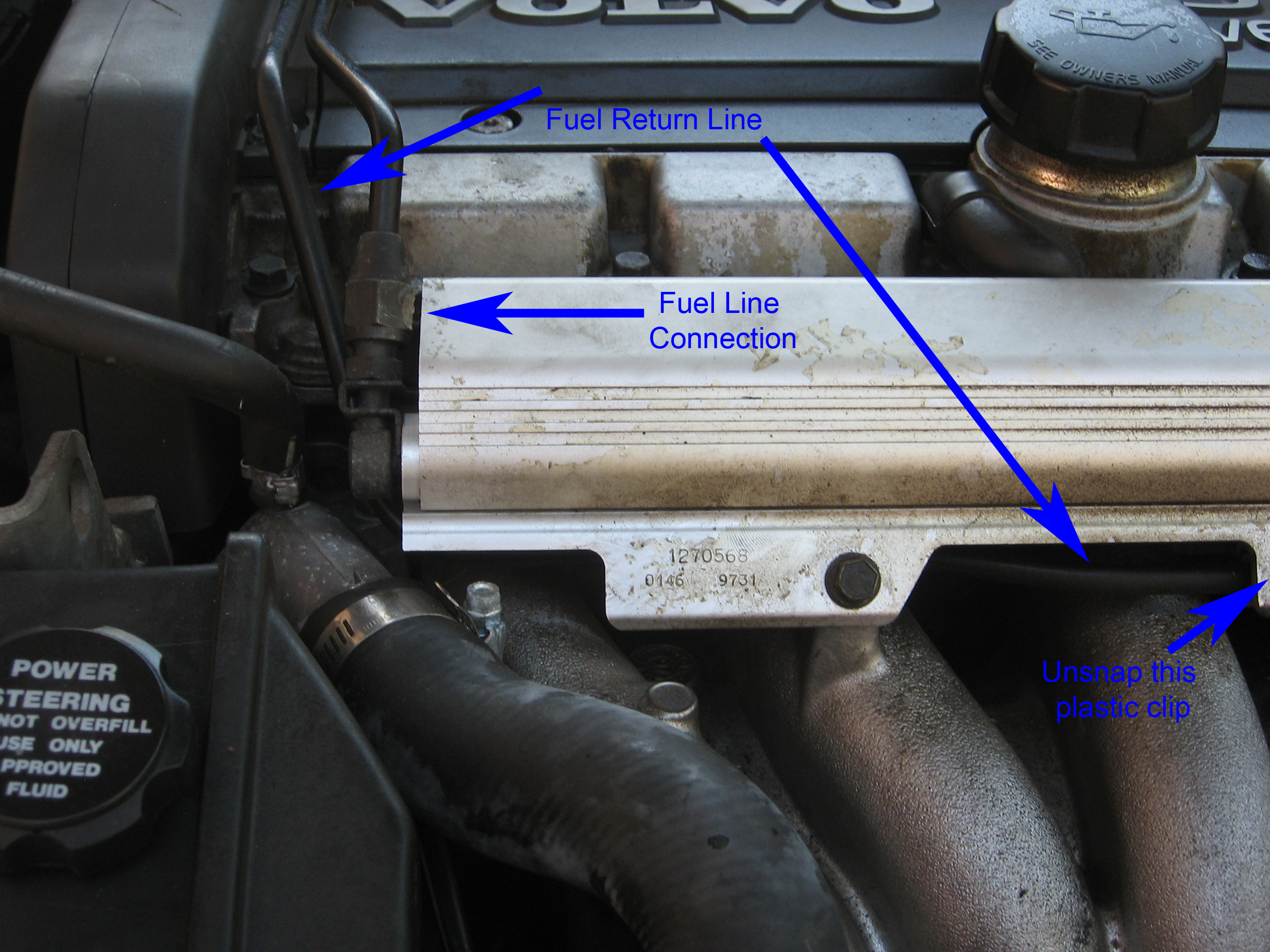

Step 4: Now, it's time to relieve the fuel pressure. If your car has been off for a while since driving it onto the ramps, you won't have much fuel pressure, just a couple spurts and some dribbles. I use a small bathroom Dixie cup and the end of a flathead screwdriver. Undo the blue cap at the end of the fuel rail, and press on the valve until all fuel flow stops. Then replace the blue cap so you don't lose it.
At this point, you can unbolt the fuel rail (I believe it was a 17mm open-end wrench, but an adjustable will work just fine. The top portion of the silver cover across the fuel rail simply unsnaps and can be set aside.
Bend the fuel line slightly up and out of the way so you can remove the manifold. You will also need to remove the fuel return line from its connection at the engine. Unscrew the left fuel rail bolt (10 mm) and bend the fuel return line up and out of your way. Replace the 10mm bolt.

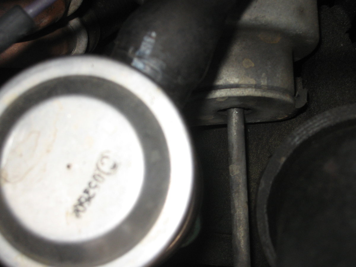

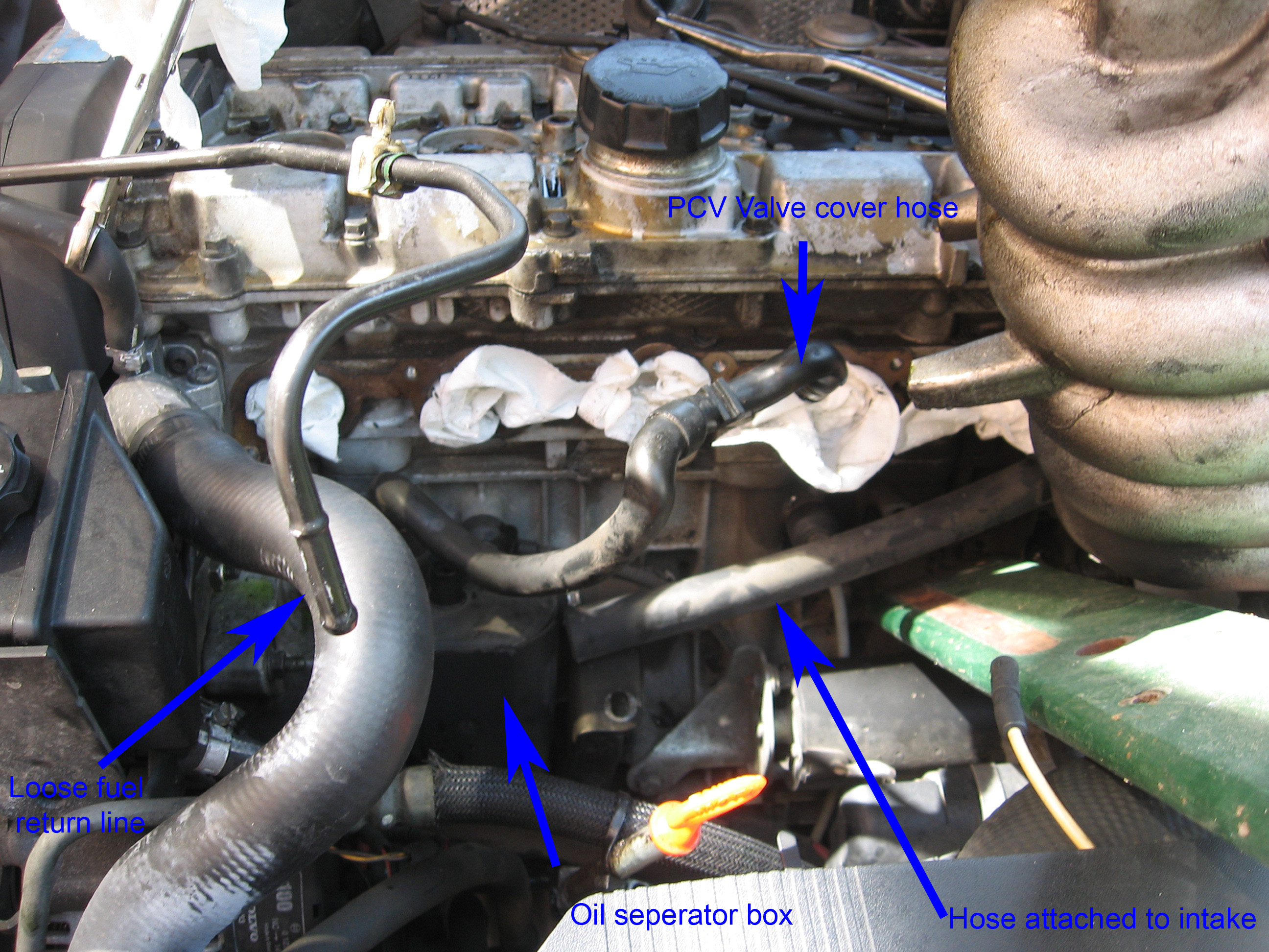

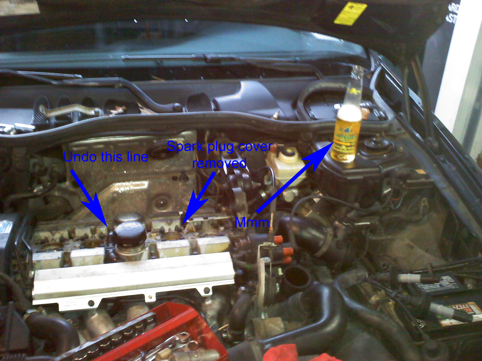

You can now remove the spark plug cover from the top of the engine and set it aside (7 T-25 Torx screws).
Remove the PCV hose from the top of the engine (twist the clamp off, then pull the hose straight up).

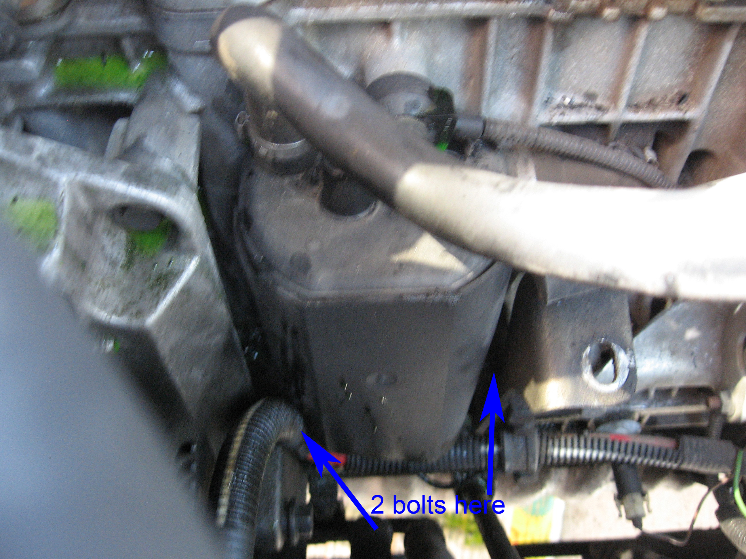

Step 5: You can now start un-bolting the intake manifold. There are two 12mm bolts under the car supporting the intake manifold. One is attached to the dip-stick, and fairly easy to get to with a 3/8" wrench, 12mm socket, 1 u-joint, and an extension. Crawl under the car, insert the wrench, and work it up into the engine bay. I found a piece of duct tape around the U-joint to be quite helpful for keeping it from flopping around trying to access the bolt.
The other one is quite hard. I had to use 2 U-joints, 2 extensions, and the socket wrench to get to this one. It took me about 30 minutes to work this bolt out. People claim that it is much easier to get to these if you remove the fan assembly from the radiator. I didn't try this myself, but it is deifnately worth it if it makes getting to these bolts easier for you. Look behind the steering rack and peer up into the depths of the engine, and you should see the bolt that comes out. Sorry, no pictures, couldn't get a good shot of either of these from under the car. Feel around with your hands up top, and you will be able to feel them under it. A better way would be to get a 12mm actual wrench, and take the closed end to it under the manifold. Coincidentally, this happened to be one of the few missing from my toolbox, so I had to have at it the hard way.
This will keep you from feeling like an idiot and doing this when you can't figure out why it's not coming out :mrgreen:

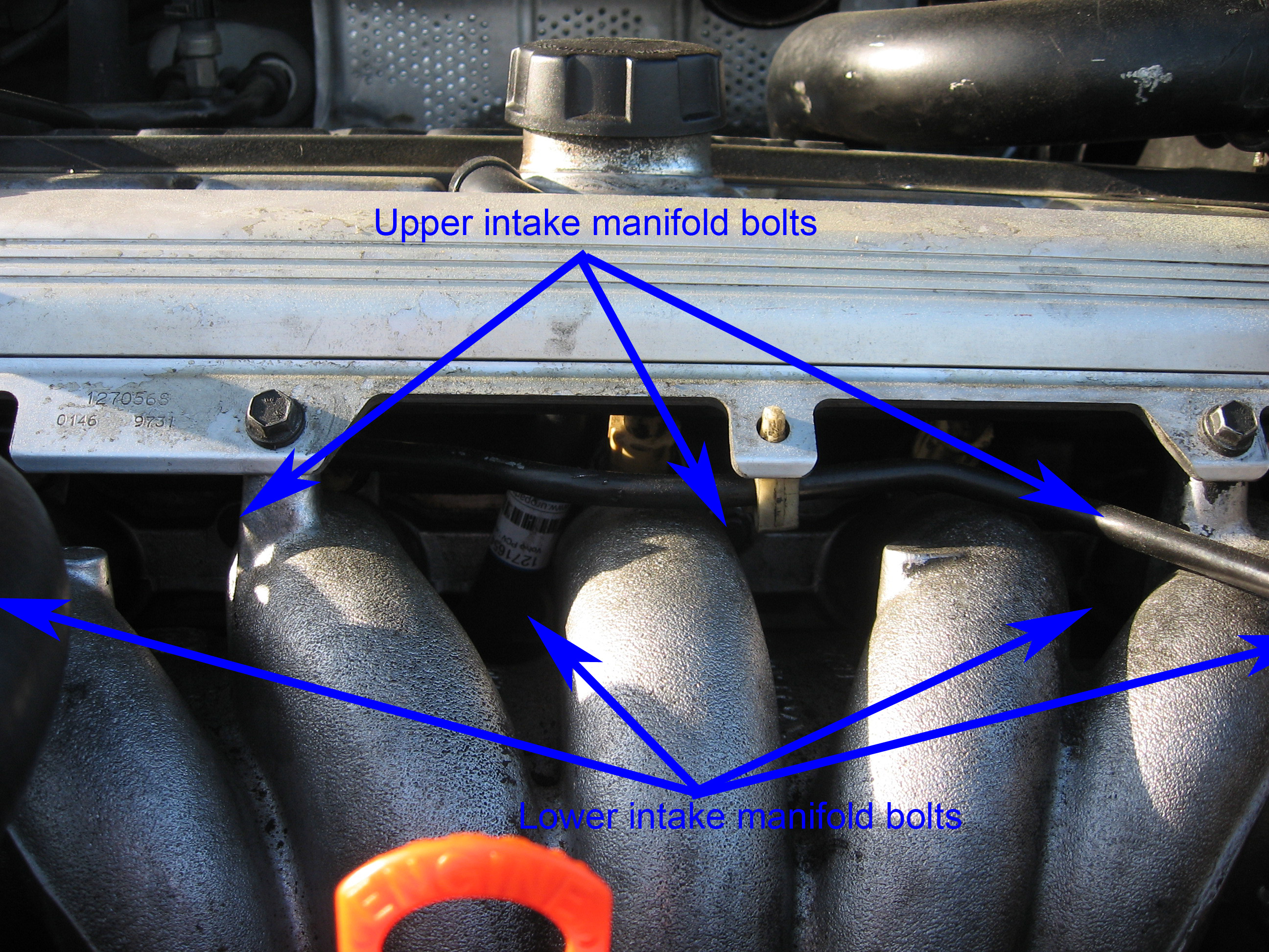

Now, you can start un-doing the 10mm intake bolts. Start with the lower 4 first, but do NOT remove them. Simply loosen them a couple turns - you will need the U-joint for the left-most and right-most bolts. I found removing the upper radiator hose and pinching off the expansion tank line with some locking pliers made this much easier, as well as unbolting the throttle assembly from the right side (re-attach the throttle assembly before moving the manifold). Stick a bucket or drain pan under the car to catch the antifreeze. After you get the lower left bolt loose, you can replace the radiator hose to avoid more spillage, just don't clamp it down again.
Locations of bolts
Locations of bolts
You will be able to reach the top 3 bolts with simply the socket and 10mm extension - grab the bolts as they come loose with pliers from the top to avoid dropping them into the bowels of the engine like I did.

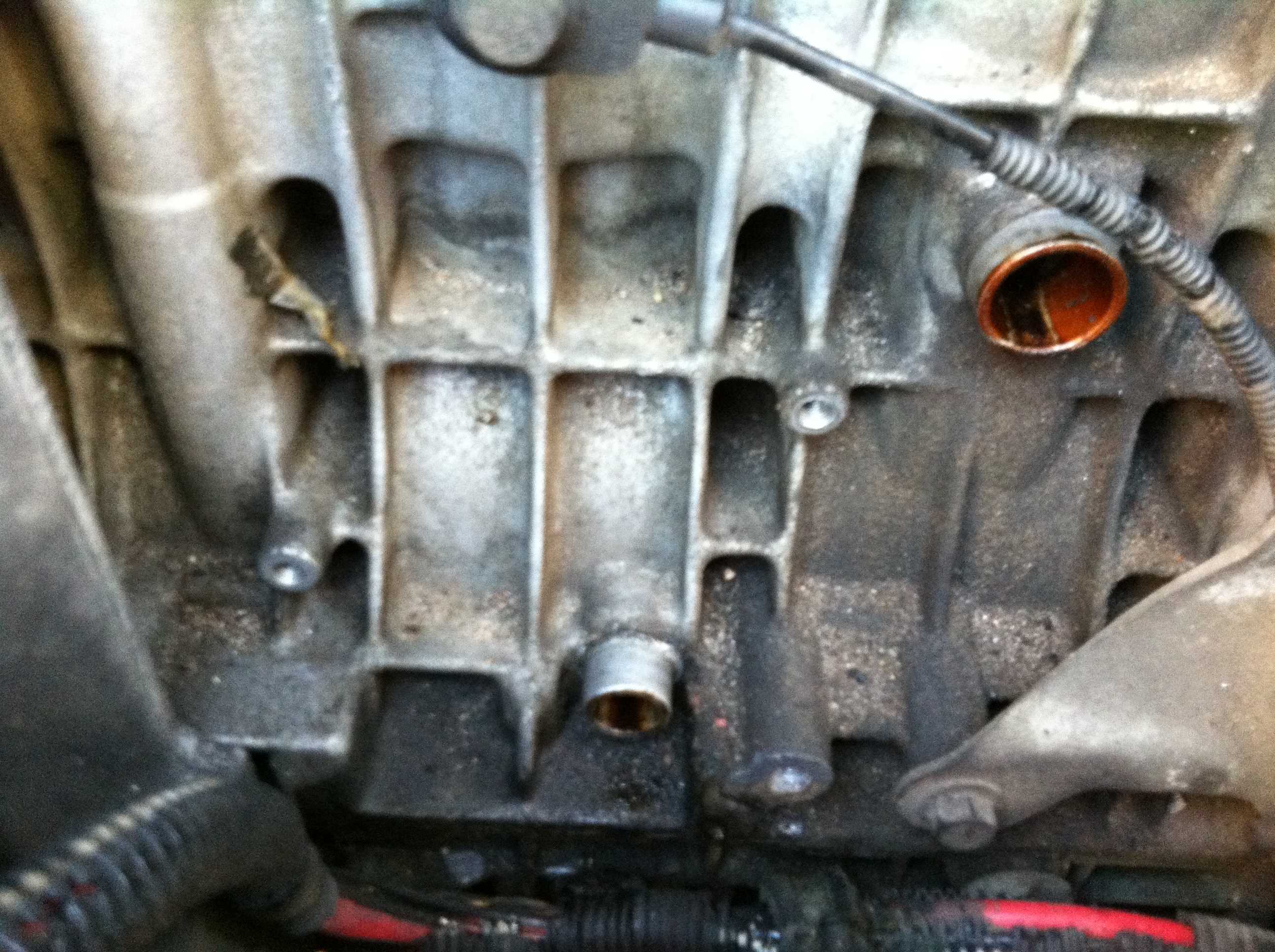

At this point, you should thoroughly scrape out both of the lower passages from the oil separator box into the engine - they wil probably be full of crud. I used a small screwdriver and some pipe cleaners to scrape away at them. The bottom one makes a sharp right-angle turn into the oil pan, so be sure to clean out that small turn in the pipe. Next, pull off all old hoses from the oil seperator, install the new lower fitting, crankcase hose to the right side (clip it to the right side first, then the box). At this point, I screwed the box into the engine. Then I reconnected the top two hoses. The big curvey one that you've got with the kit runs back to the PTC nipple at the turbo - pull out the old one entirely, and then try to work the new one in where it was. It's very hard - don't worry if you tear the rubber along the way, it's just a protector. Make sure you are able to connect it at both ends.
Make sure you clean and scrape out these two ports thoroughly

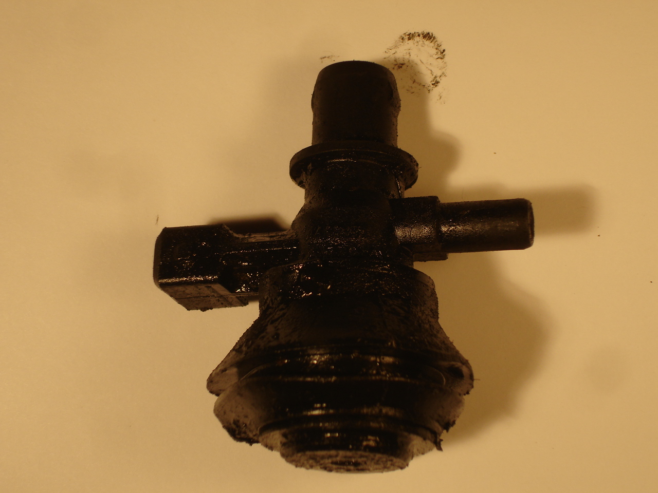

Once you get that undone, undo the hoses at the PTC connection and the electrical connector. Work the hose out, and you can now see how clogged it is. My camera died at this point into the procedure. You can pull straight up on the PTC nipple, and it will pop out of the hose. Don't apply too much pressure, or you'll break the O-ring or the plastic hose itself.
Turbo hose removed
Turbo hose removed
PTC Nipple removed
PTC Nipple removed

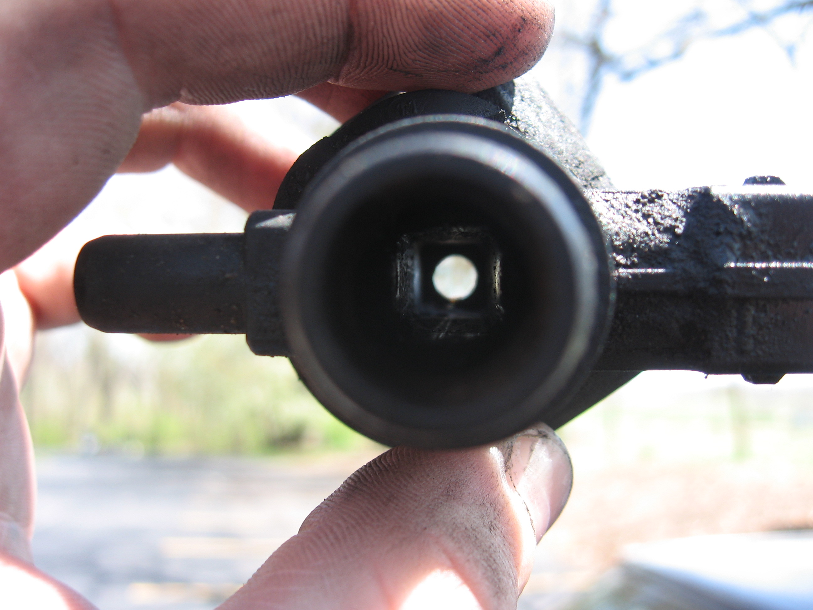

Clean out the passages of the PTC nipple thoroughly
Attack the gunk on the PTC nipple with brake or carburetor cleaner, or a can of Seafoam works wonders. I then used a small screwdriver or drill bit to ream out the crud in the passages. The smallest size drill bit in my kit will fit through the vacuum hose passage. Keep at it until you can see clear through both ports, and there is no crud sticking to the inside. I used about 1/2 a can of carb cleaner on mine - it really wasn't as clogged as I've seen pictures of some of them.
Coincidentally, pouring a small bit of Seafoam down the tubes into the PTC nipple every 20,000 miles or so would not be a bad thing at all to help keep the passages clear.
At this point, you can replace the PTC nipple back into the hose. I used a small flathead screwdriver to push down the rubber seal into the hose - go around the entire thing and you shouldn't have problems getting it back in and getting a good seal.
PTC hose fitting
PTC hose fitting

- Else-web-where, people say not to take the PTC off the intake pipe. But I did (by mistake, in removing the hoses from it), and like you I had no problem re-installing it. I used tiny tools to poke the under-side of the grommet back in. You don't want a vacuum leak there, so if it looks sketchy (as well it might if there has been oil around it) consider using some silicone sealant or creative zip-tie solution to pull the PTC against the pipe.

A friend and I had previously cleaned the PTC ports (with hose still in the car) and replaced the hose from the top of the engine down to the oil separator, which had blown a hole in it and was shooting out oil everywhere. In doing that (it was really cold), we snapped the plastic line to the left side of the intake manifold clean off, and had to jury-rig an extension for it. Turns out I'll be using this extension again, as that same hose has blown off again.
Aside from that, nothing in the PCV system in this car had ever been replaced before I owned it. Everything was messy and brittle as all heck - the fat hose snapped into several pieces as I was trying to pull it out.
I don't have a picture of the holes in the block (I coulda sworn I did, but it's not on the camera card). They actually weren't too clogged, I shoved a wire brush through all of them and reamed out what junk I could, but there wasn't really anything clogging the holes. To be honest, the oil separator didn't seem too clogged.
My pressure WAS completely gone (I think) until I blew off the vacuum hose to the PTC again. Now it's back again, but in much less volume. You could clean the MAF if you wanted to; I set mine inside the house to keep all the ridiculous amounts of pollen from destroying it.
I could instantly tell that my car felt happier to drive and accelerate. It felt like it's not being held back by much anymore.

One last question. Did you tighten the intake manifold bolts to torque specifications? Just wondering
about the bolts in the hard to get to places. These sound like they are difficult to tighten.
