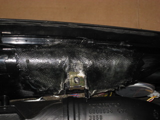

When I did mine I ordered the "A/C Evaporator Update Kit" from DW volvo ($300) which came with all the o-rings. http://www.eeuroparts.com/Main/PartDeta ... id=9171791850FLA wrote:I have a 98 V70. The evaporator is shot. I have ordered the evaporator, drier/receiver and all of the o rings for the conncections.
A few thing you might want to consider in addition to evaporator:
1. replace the Oriface Tube (expansion valve) as well, if the line is in good condition; http://www.eeuroparts.com/Main/PartDeta ... id=3545086
2. Prepare to repair your dash mount, https://www.matthewsvolvosite.com/forums ... hp?t=15115
If yours are not totally broken off, you can try to use fiberglass cloth to clue back on. A few more references:
http://www.kodakgallery.com/gallery/cre ... 3:95279552
http://volvoforums.com/forum/showthread.php?t=1697
http://www.volvoforums.com/forum/showthread.php?t=11832
