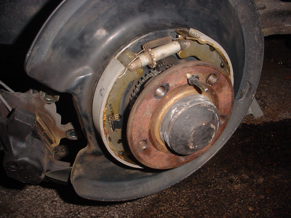

What cleaner should I use to clean the sensors? Also, what are the reluctance rings?
Thanks again,
Curtis
Thanks again,
Curtis
Ozark Lee
- Posts: 14798
- Joined: 07 Sep 2006, 08:24
- Year and Model: Many Volvos
- Location: USA Midwest
- Been thanked: 76 times
I use whatever I have on the shelf which is usually brake cleaner or carb cleaner. The reluctance rings are the sprocket shaped magnets that send the pulses to the ABS module to tell it what each wheel is doing so that it can try to figure out which brake to apply the pulsating brake pressure to. The are mounted on the hubs on the rear and on the half shafts on the front.What cleaner should I use to clean the sensors? Also, what are the reluctance rings?
