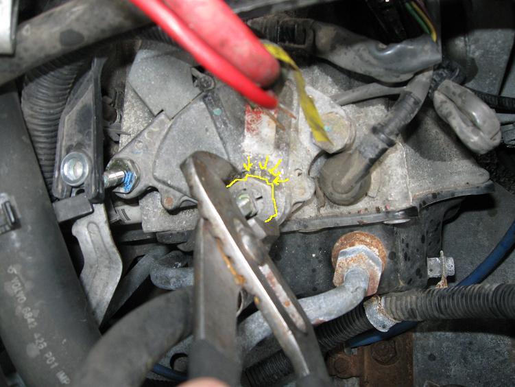

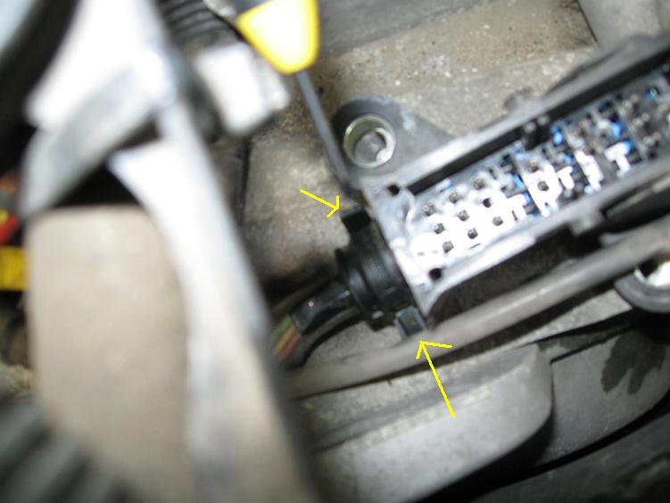

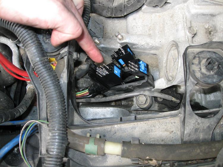

With the plastic connector exposed, use a small screw driver to break off the plastic tabs.

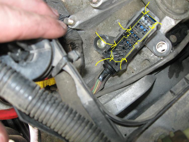

Spray the inside of the connection box with WD-40 as shown by the arrows and outline.

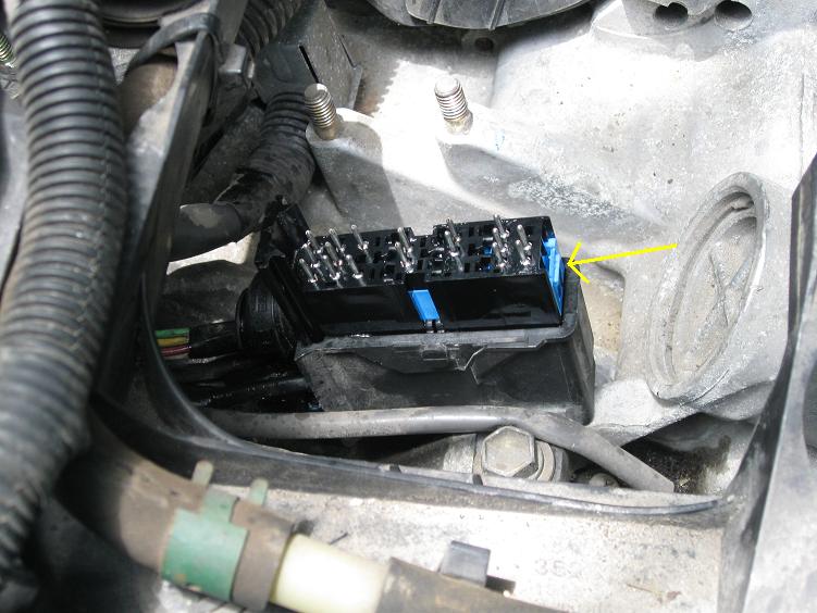

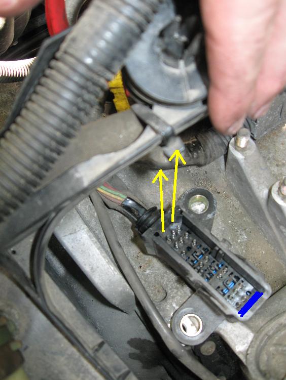

Use the small pocket knife and stick it into the very back of the connector box. There is a blue
which must be pressed forwards (towards the front of the car) while at the same time using
channel locks and pulling the front of the box straight up. The blue line designates where to
place the pocket knife while the arrow designates where to put the channel locks and which
way to pull.
Partially up
This picture shows a great view of the blue tab that needs to be pushed towards the front of
the car. The arrow is pointing to it.

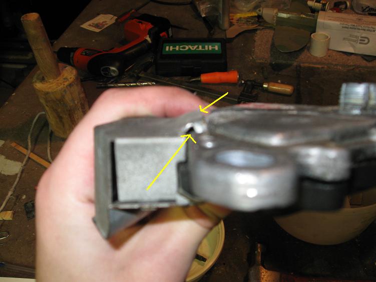

With the connectors out of the box, you can break them into 3 separate pieces. The largest
piece, the one I am pointing to, is connected to our PNP switch.

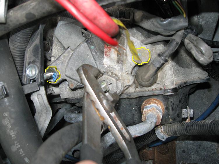

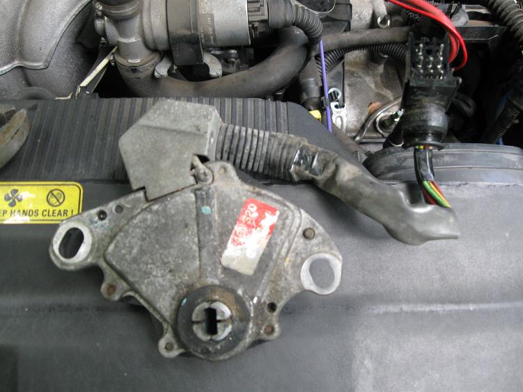

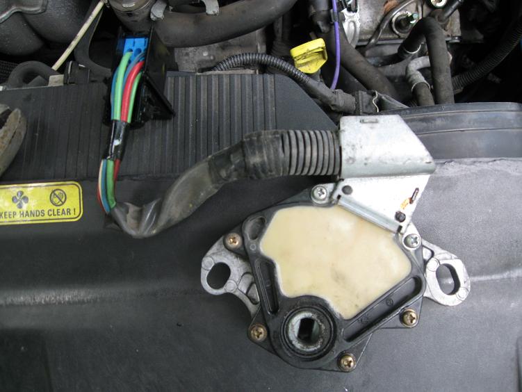

Using your channel locks, un-screw the center bolt on the PNP switch. It is bolted on lightly so
don’t over tighten it when putting everything back together.
The last 2 bolts to be undone are the 17mm bolts on the left and right of the PNP switch. The
left one requires a deep socket while the right one is easy to get to.

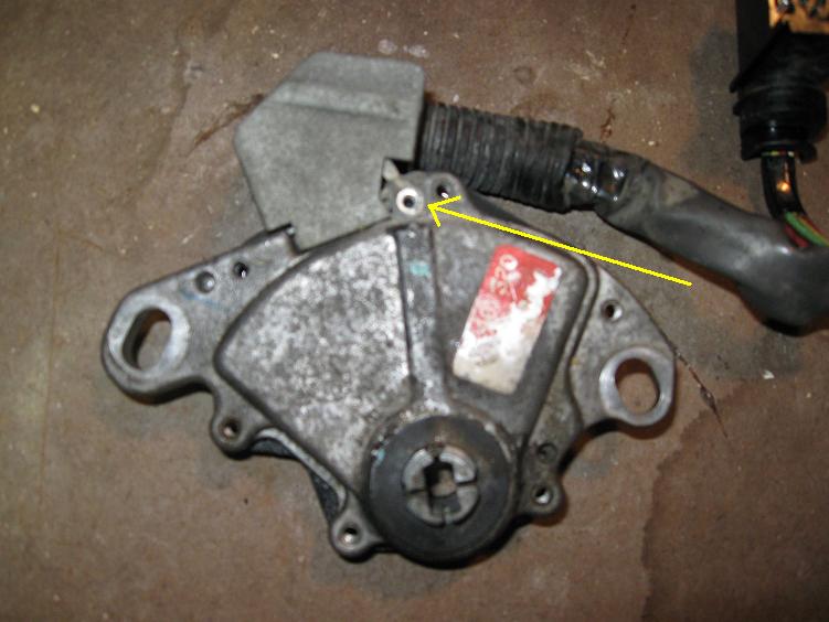

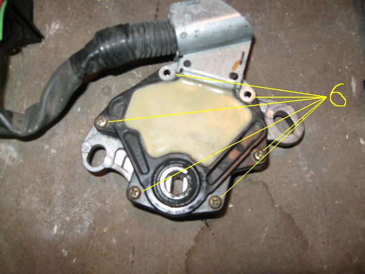

PNP Switch Cleaning:
Top of PNP
Bottom of PNP
Remove the 6 Phillips head screws on the bottom of the PNP
Turn over and remove one screw from the top.
Pry off metal cover carefully.
VERY CAREFULLY PULL THE SWITCH APART!

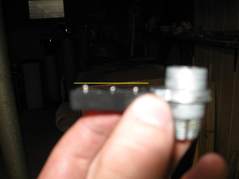

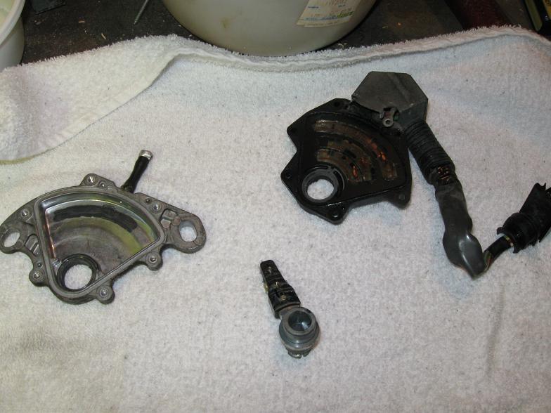

If you are not careful you may lose the 3 copper contacts or springs.

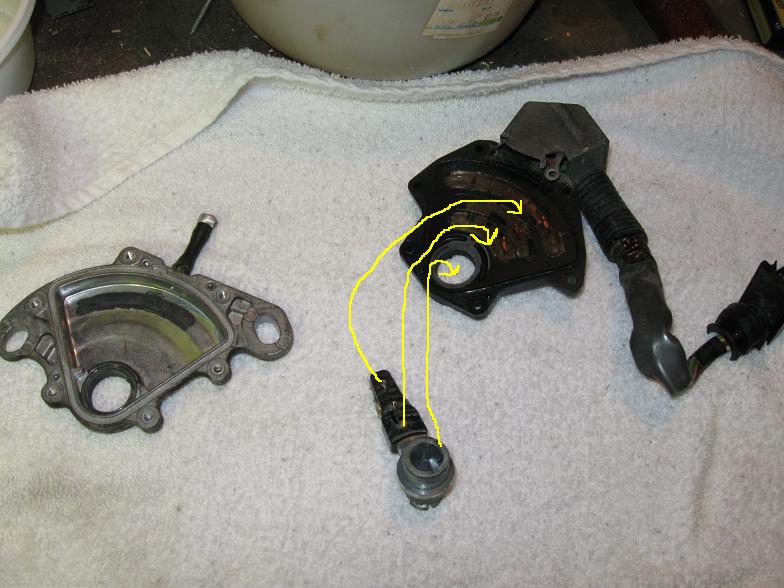

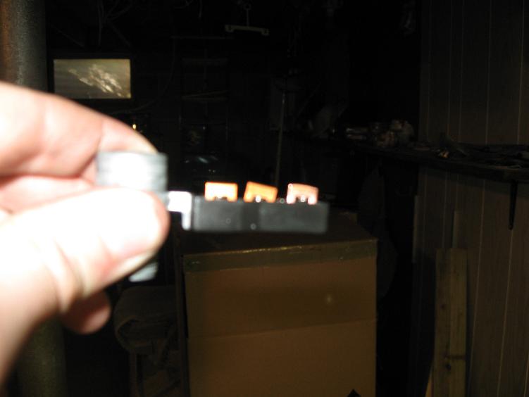

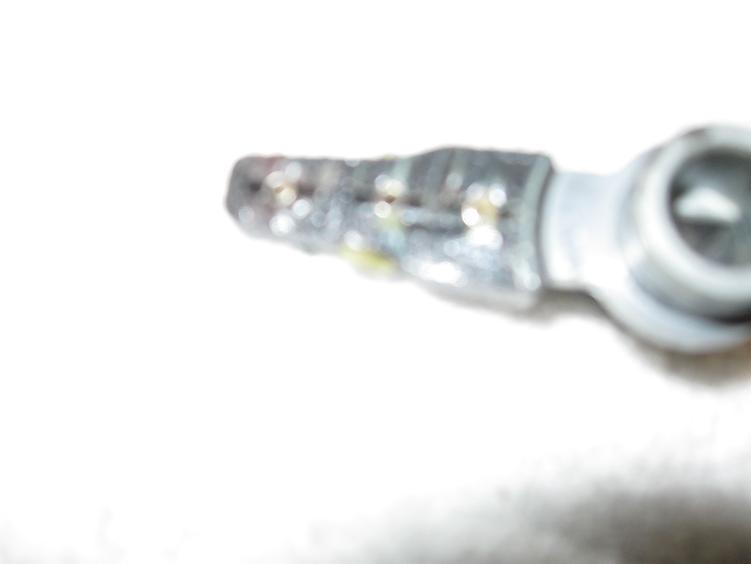

Remove the copper contacts from the arm.
Copper contacts:
I outlined the first contact b/c it didn't show up on the camera

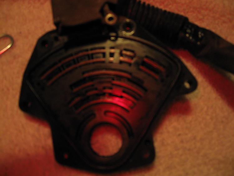

Arm:

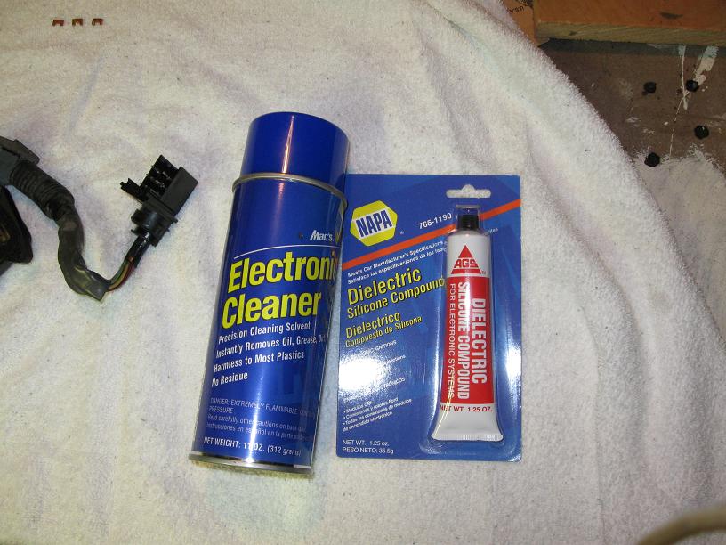

Wipe excess grease from all components. Spray all components with contact cleaner. Once all
parts have been cleaned thoroughly, apply dielectric grease to back of arm. Reassemble
everything carefully. If one or more copper contacts are worn, you may want to grind them
down. Before reassembly make sure to stretch the springs a little bit.

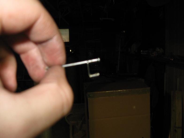

Stretching springs on a small nail:
The best method I found for stretching the little springs is to slide a small nail through the spring
and to use your nails at both ends and stretch the spring along the nail. I found that the nail
helps to prevent the spring from becoming deformed and flattened.

So what to do. Put the shifter in Neutral. Align the PNP switch as shown, and screw the
shifter cable down into place. Then bolt the cable arm to the central bolt of the PNP. You
have just aligned and overhauled your PNP switch.
As far as reinstallation goes, remember not to over tighten anything and to make sure the shift
cable bolts are screwed into the same spot they came out of. Otherwise you will need to adjust
shift cable.
