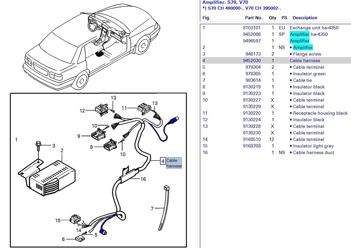

There are two common amps, a 4 x 40w that mounts on the tunnel behind the HU :

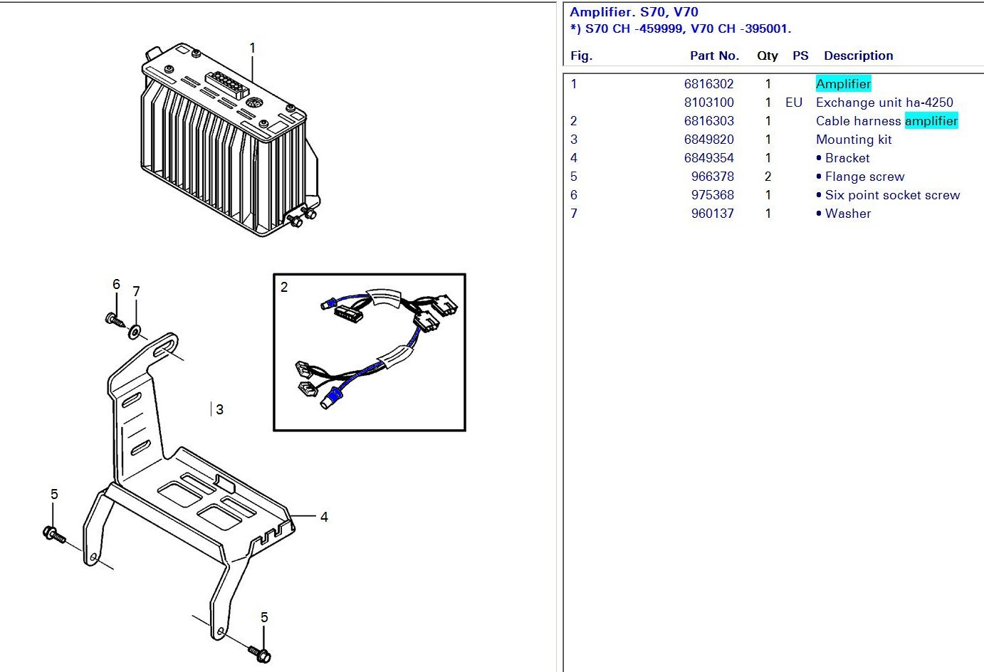

And a 4 x 50w that gets installed under the passenger seat:
If you’ve got an SC-900 or the newer SC-901, you’ll have the 4 x 50 (I’m NOT going into C70’s here…)

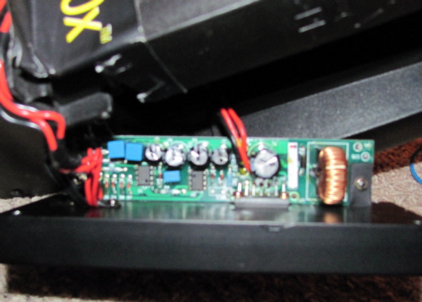

I think I might just bag this whole OEM sub and go traditional amp/sub set up. I pulled the amp section off the V70 sub and it looks like this:
As a reference point the copper circular wiring has the diameter of about a quarter. Again I don't know a tone about electronics but this looks like it pumps out about 6 watts per channel...

You've got some sort of amp and coil (low pass crossover) there... Might be more than 10 watts... Try and google the amp ic part number, you should be able to find a data sheet.
Don't forget you also only have a 6" sub so you are limited in SPL in that respect. I have a 6" subwoofer and a 20 watt amp for my home theater setup and it is plenty for the large room it is in. This setup with 10 watts won't rock the house but you will notice it.
