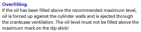

Cold max fill is about 1/4 of way BELOW the hot max fill mark on dipstick (or 3/4 way up from low mark). If you overfill it comes bubbling up the oil trap into the intake manifold and can foul plugs or even cause a software fault with ETM. See VADIS warning below.
VADIS snapshot
VADIS snapshot
