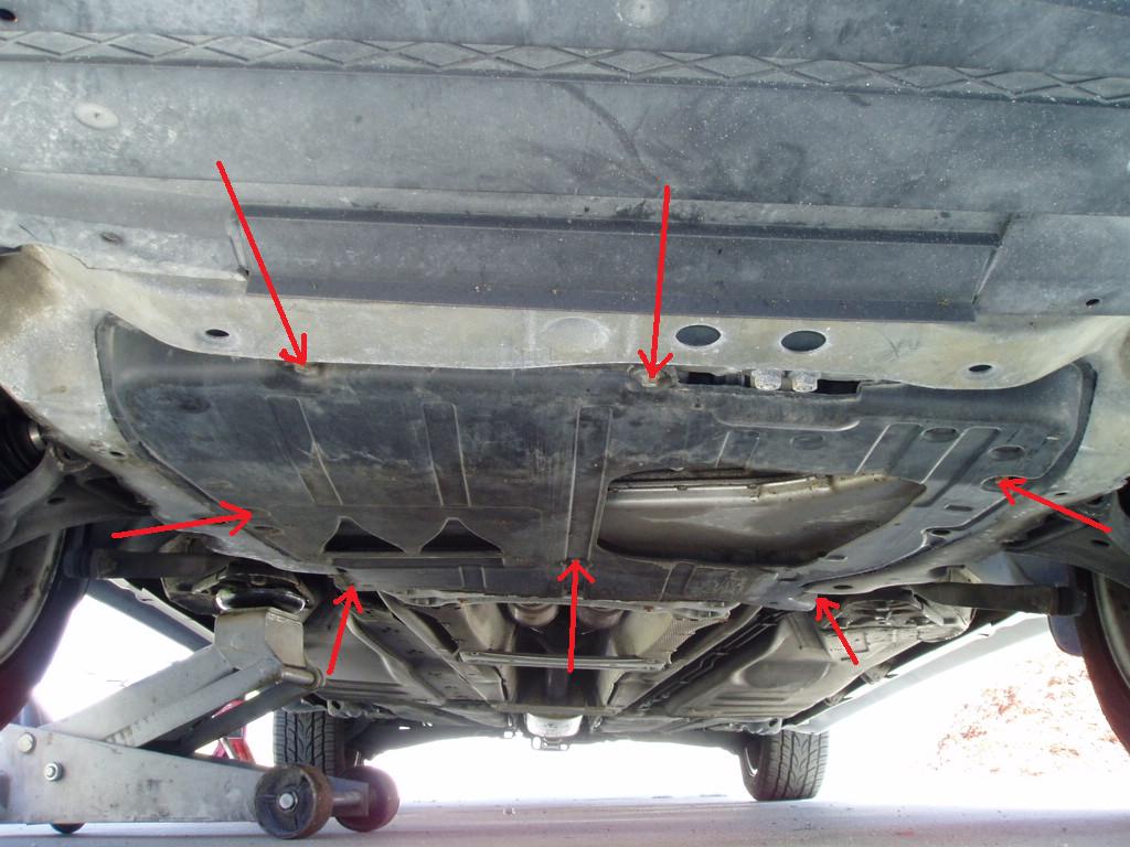

  • Now use the 12mm socket and ratchet to remove the 7 bolts holding the undertray to the bottom of the car:
  • (5)-1.jpg Drop the tray down and slide it out of the way.

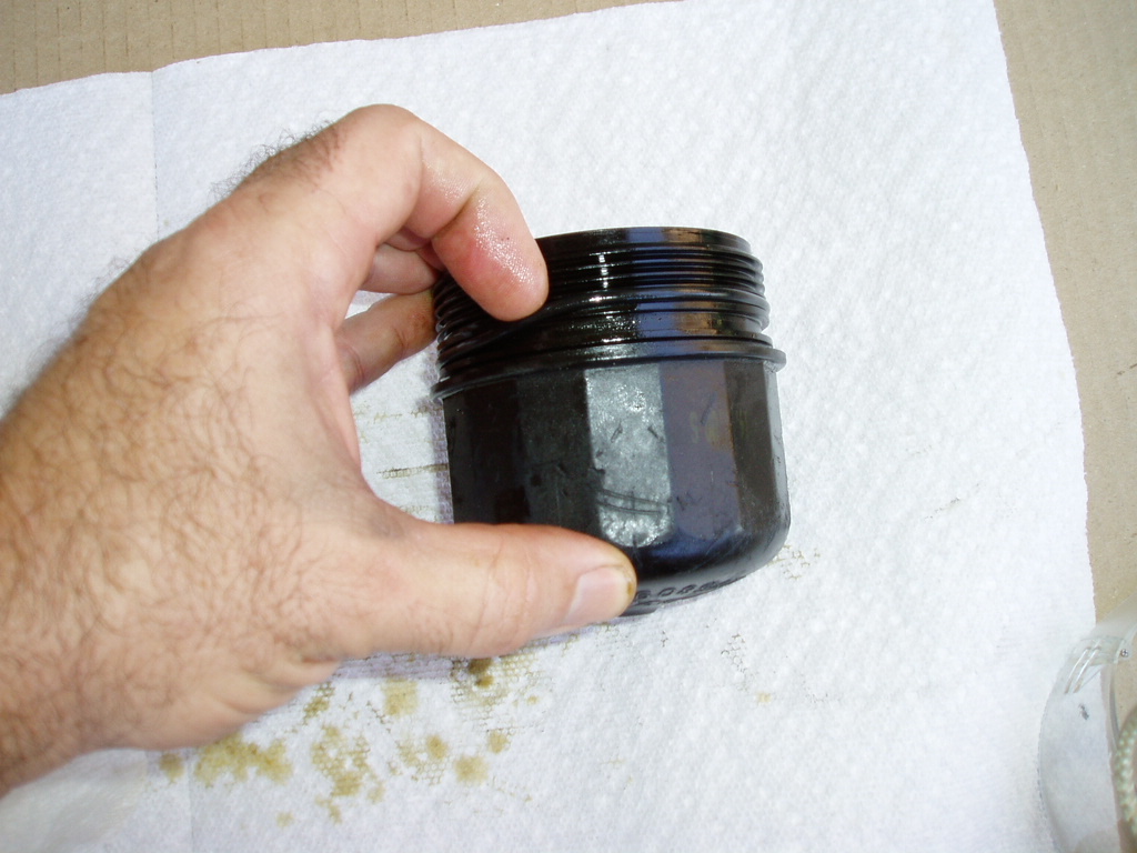

  • The next pic shows the oil filter cover and the dished-out area in the subframe that allows you to use a conventional spin-on filter wrench:
  • Oil Filter Cover and Subframe Dish Locations.jpg Oil Filter Cover and Subframe Dish Locations. Use the oil filter wrench to loosen the cover by turning counterclockwise:
  • Use the Filter Wrench to Loosen the Cover by Turning it Counterclockwise.jpg Use the Filter Wrench to Loosen the Cover by Turning it Counterclockwise. NOTE: If you can’t loosen the cover with the conventional wrench, buy the special Volvo tool, available here: http://www.fcpgroton.com/product-exec/p … ory_id/136

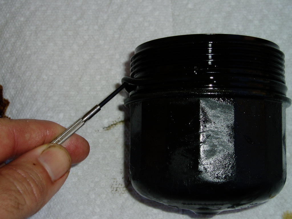

  • Old vs. New Filter Comparison.jpg Now use the small screwdriver to pry the old o-ring up and out of its groove:
  • (24).JPG Roll the o-ring up and off of the cover and remove it:

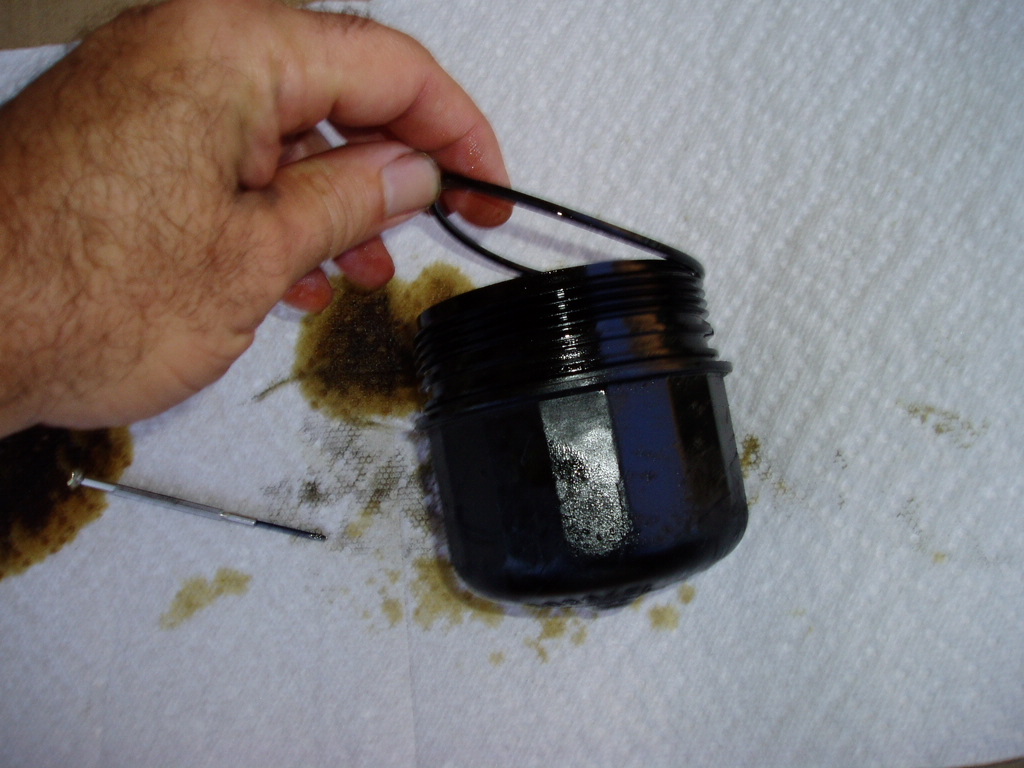

  • (27).JPG Roll the new o-ring onto the cover and down into its groove:

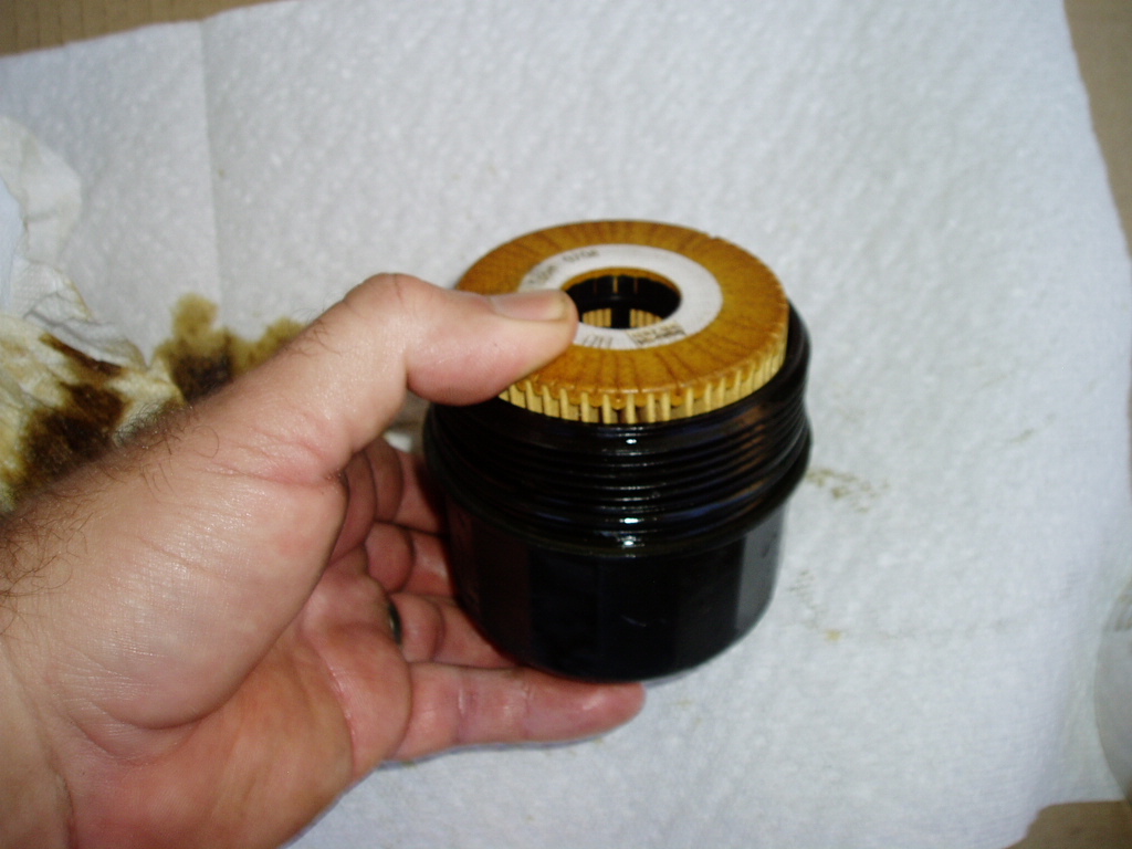

  • (28).JPG Use the paper towels or rags to wipe out the inside of the cover. Make sure you remove any gunk that may have accumulated at the bottom. Now take the new filter and place it into the cover. Push it down until it slides over the center post in the bottom of the cover:
  • (31).JPG If you worry about having oil pressure the maximum amount of the time, pour some oil into the cover while holding it upright. Now slide back under the car and screw the cover back into place. The cover says to torque it to 25 N-m (19 ft-lb), which is fine if you have a torque wrench, but if not just tighten it with the wrench until it is screwed in as far as it will go. The o-ring makes the seal, so you only need enough torque to keep the cover from unscrewing. Also, it takes some torque to force the filter over the center post up in the engine. Make sure you get it in far enough that the o-ring is engaged in the housing or you will have a major league leak.

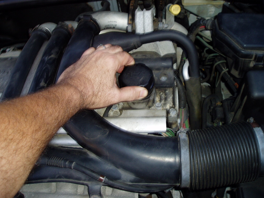

  • Open the hood and remove the oil filler cap:

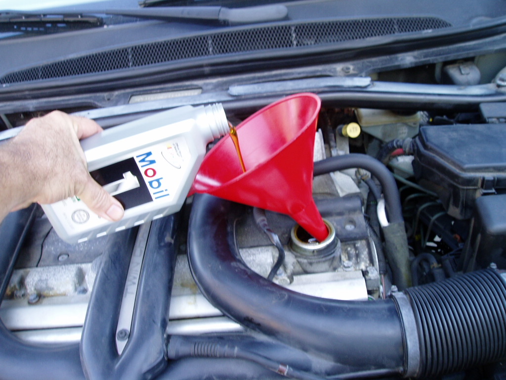

  • (35).JPG Insert the funnel and add the appropriate amount of high-quality oil (I like the full-synthetics like Mobil 1 and Castrol Edge) per your owner’s manual (for my T6, 7 quarts). If you added oil to the filter cover before you put it on, make sure you account for that. I usually add about 1/2 quart less than specified, then check the level after I run the engine and top-up as needed.

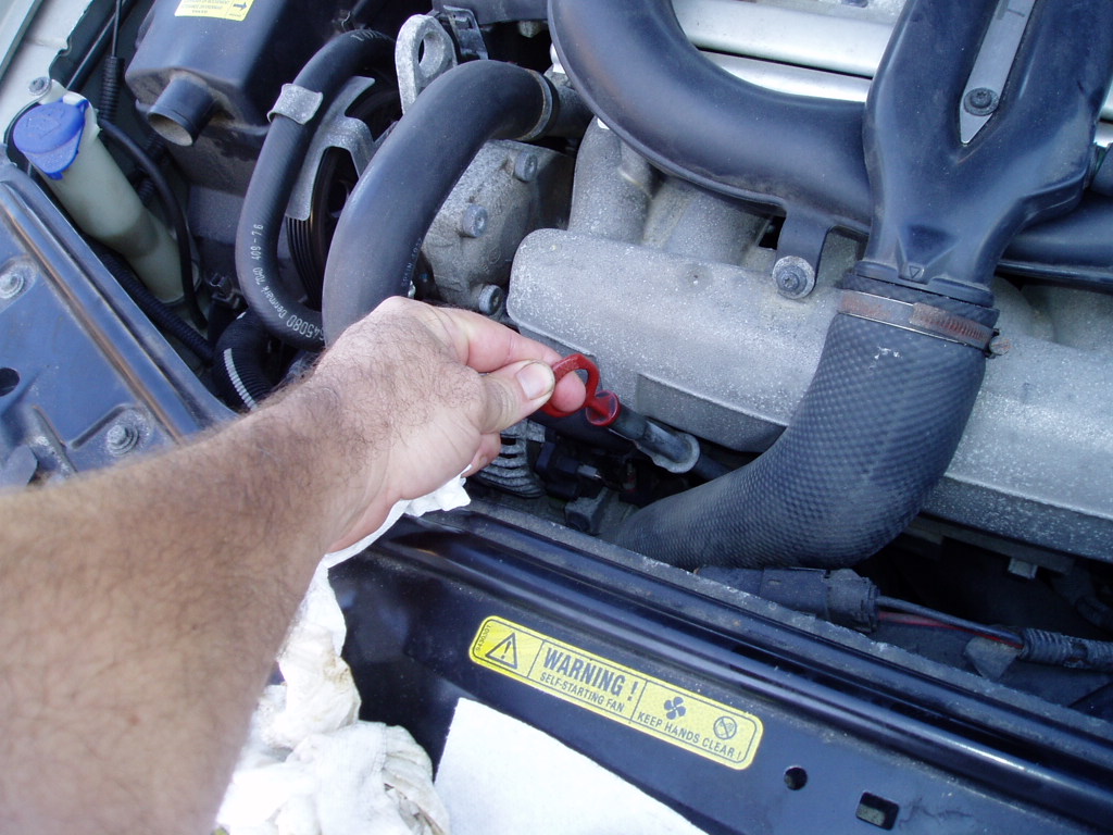

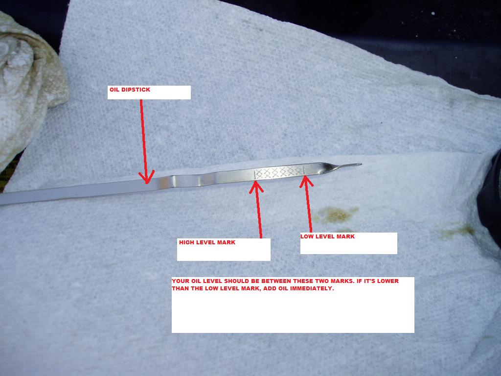

  • (36).JPG Pull the oil dipstick out to check the level. Wipe the end of the dipstick off, then reinsert it into the tube and pull it back out to get an accurate reading.
  • (48).JPG The oil level should be between the two lines on the end of the dipstick:
  • Oil Dipstick Level Marks.jpg Oil Dipstick Level Marks.jpg (98.23 KiB) Viewed 27268 times Replace the oil filler cap and start the car. Make sure the oil pressure light goes out within 30 seconds – if it doesn’t, shut off the engine and investigate what is wrong.
