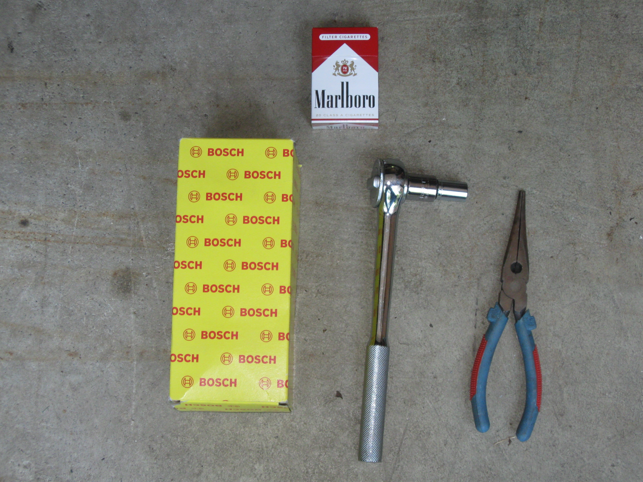

Tools required:
12mm Socket
Socket Wrench
Needle Nose Pliers
New Filter

Great write-up as always!
However...
I think your pack of cigarettes might not go too well when dealing with maintenance in your car's fuel supply.
However...

Hahahha....nah...I don't see any problems there.ecbsykes wrote:I think your pack of cigarettes might not go too well when dealing with maintenance in your car's fuel supply.
