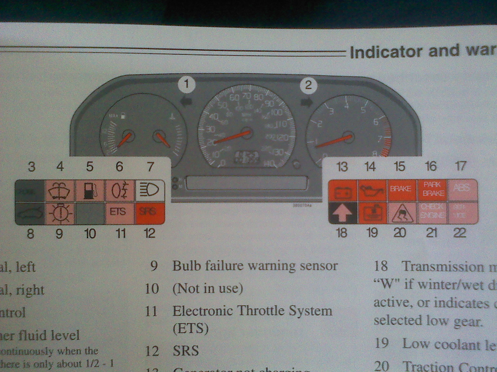

Welcome to MVS!
The check engine light is not a "yellow light showing a picture of an engine" though, the Check Engine light simply says "Check Engine".
Which did you have?
Which one of these was on?
PS. Don't worry about what fuel you put in, that has nothing to do with it. Higher octane will not hurt, and in fact it's better for your turbo car. :mrgreen:

My 1999 v70xc check engine light is a picture of an engine.
Retired MVS Contributor
Post by Retired MVS Contributor »
Since Ginger999 mentioned putting petrol in the tank, it is my guess that she (he?) is in GB and perhaps their instument panel legends are different than this side of the pond???

hi, yes i am in england, and yes my light has a picture of an engine. i checked my petrol cap which was on ok, i disconected my battery and the light now goes off when i start the engine and stays off. i guess i have just reset the managment system, and the problem is still there, but i gather if the problem is still there the light will come on again in the near future. many thanks for all of your inputs, and will be interested if there are any more comments about this broblem
