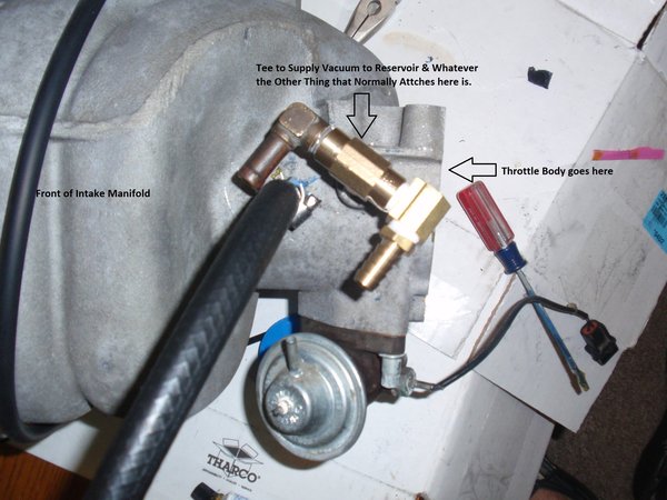

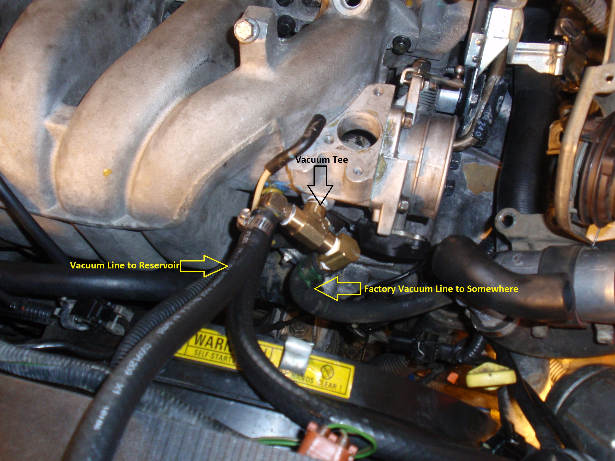

I had to have a vacuum source, so I T'd the 1/4" factory vacuum port.
Here's a good look of the Tee with the manifold back on the engine, that's 3/8" ID hose.
With everything back where it's supposed to be, the vacuum T is hidden behind the Idle Air Control.

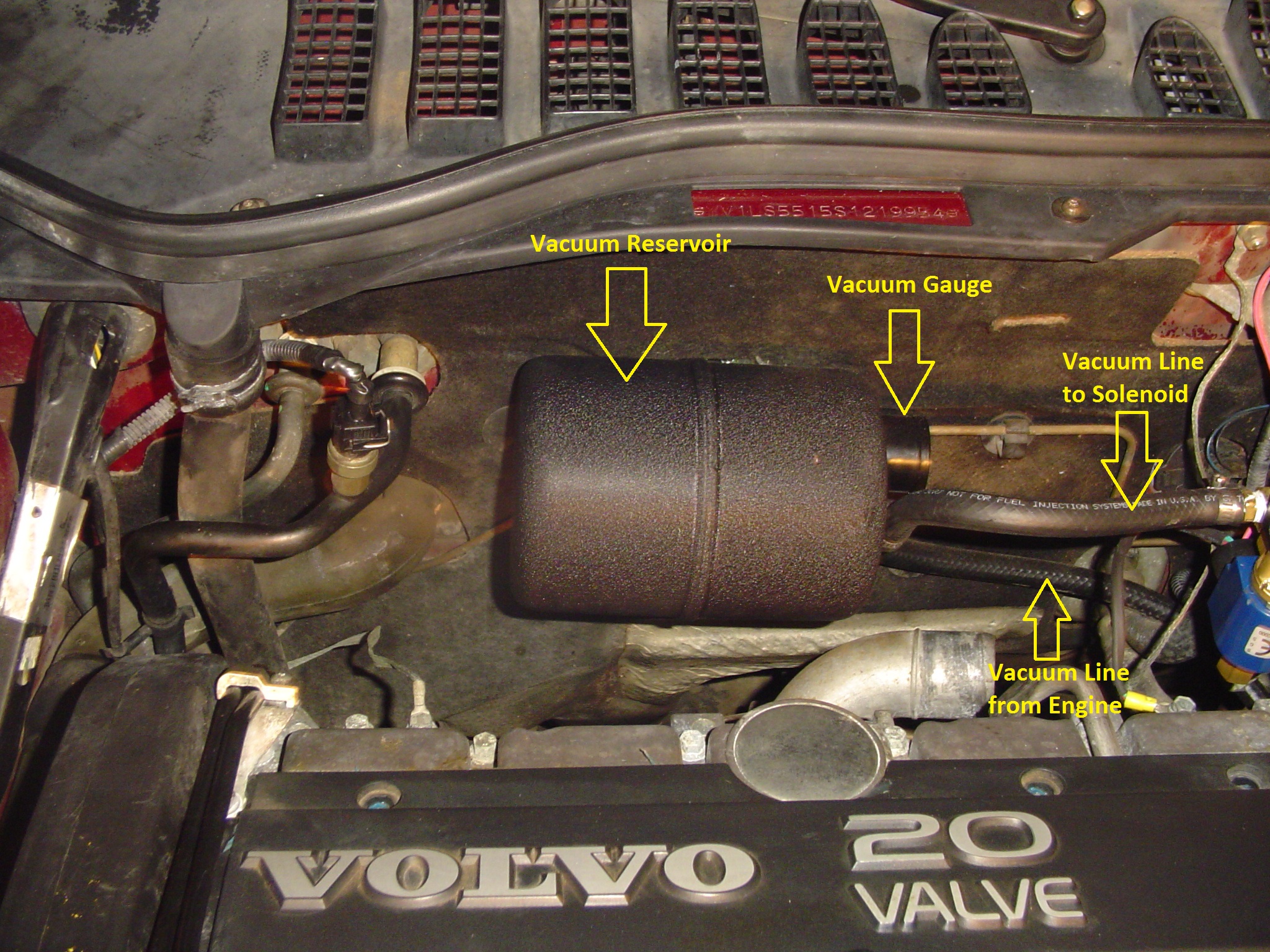

The vacuum reservoir is obviously mounted on the firewall; I cut a little rectangle out of the insulation to fit the mounting bracket directly against the firewall. I also had to remove the little gay sounding car alarm. I put a cheap Summit vacuum gauge in the reservoir, it's a real POS, reads 15 in/Hg with no vacuum applied, so I just consider 15 in/Hg to be 0 and count up from there. There is a one way check valve in the reservoir for the vacuum line from the intake manifold. So when the solenoid valve de-energizes or you turn the engine off, it keeps a "reservoir" of vacuum, who'd-a-thunk-it?

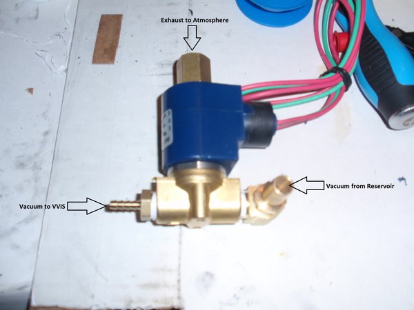

Here's the solenoid valve ready to be plumbed.
The solenoid valve plumbed/wired/mounted. I mounted it to the engine torque arm, and used a modified base for a clamp on desk lamp as a mounting bracket. I ran the ground wire from the solenoid to the same bolt that the braided ground wire on the engine head attaches to.

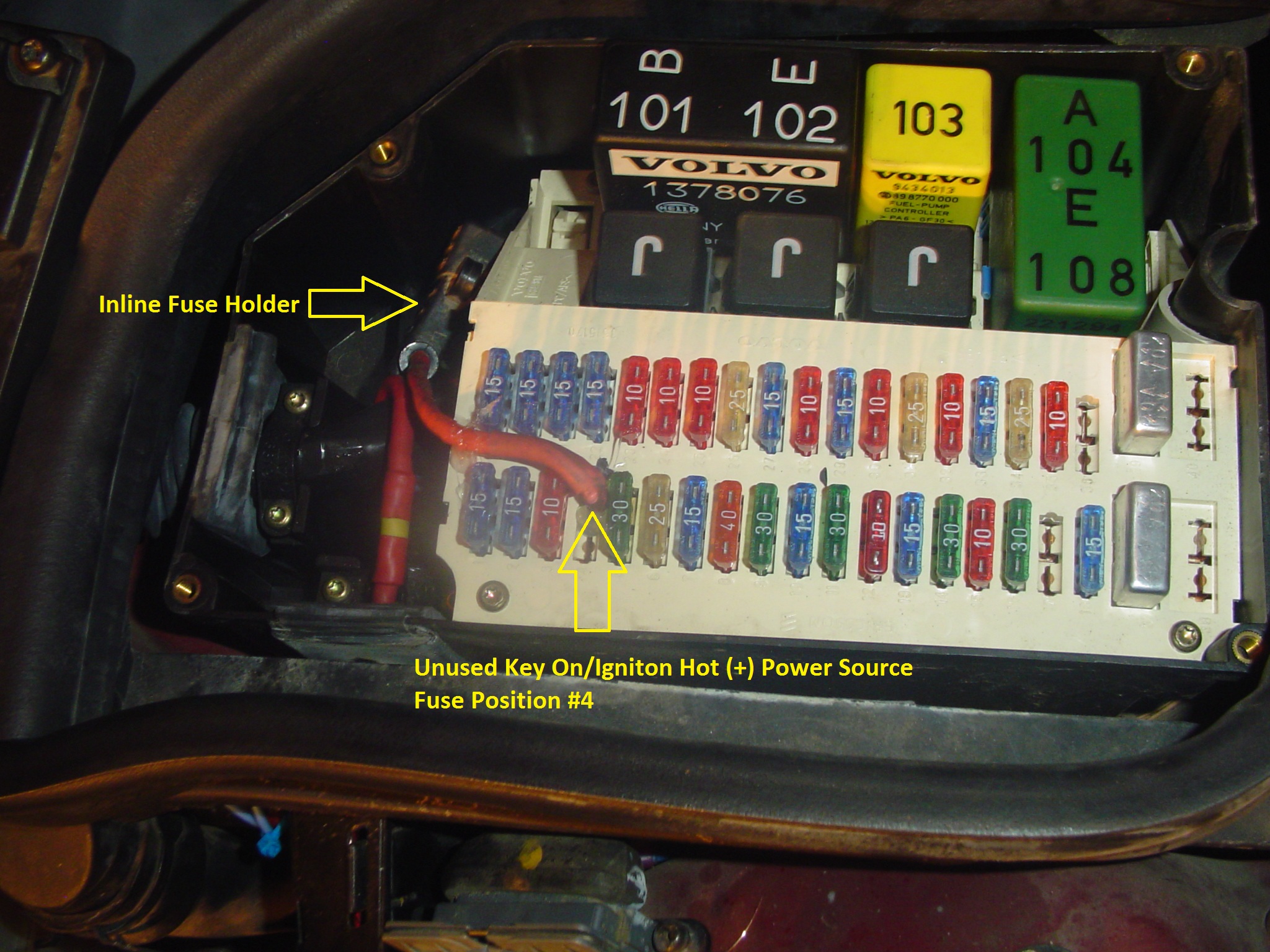

I tapped into an unused/empty key-on/ignition hot fuse in the factory fuse block. Fuse position #4 is empty and unlabeled in my car, but still powered when the key is on. I used an inline fuse as well.

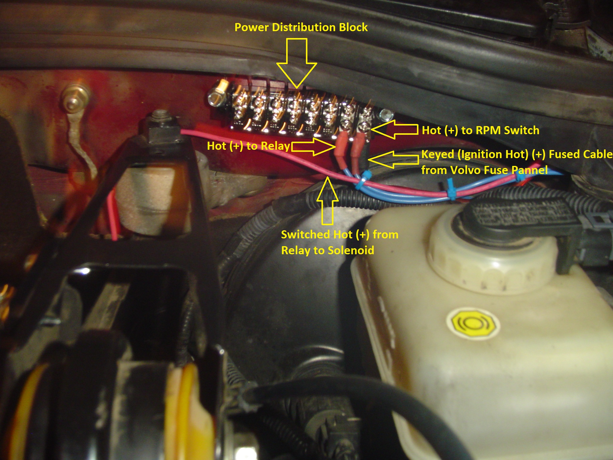

I bought a terminal block to use as a power distribution block. I was trying to keep this a clean install, instead of wires running all over the engine bay, and having any more wires coming off of the batter (+) terminal.

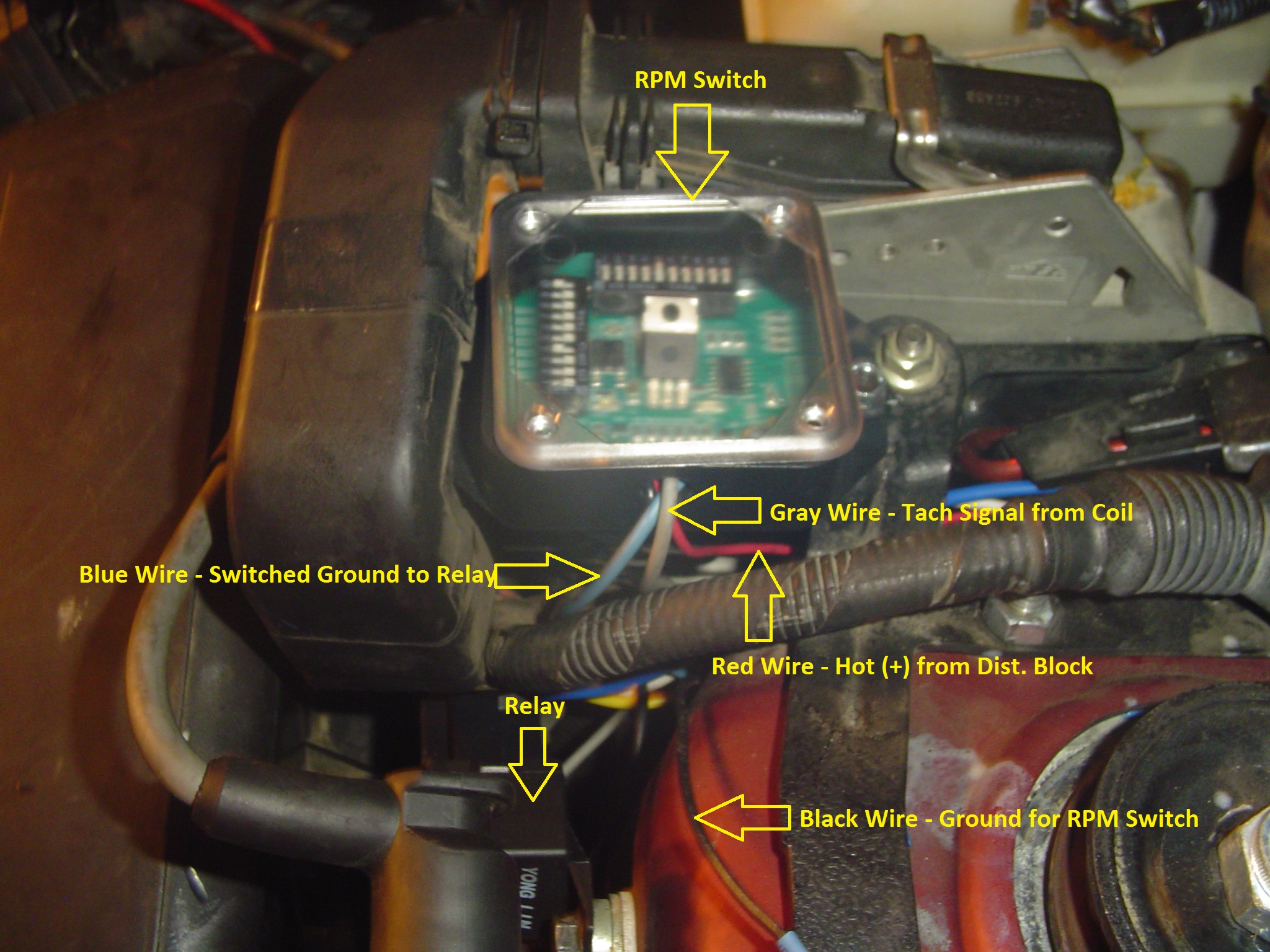

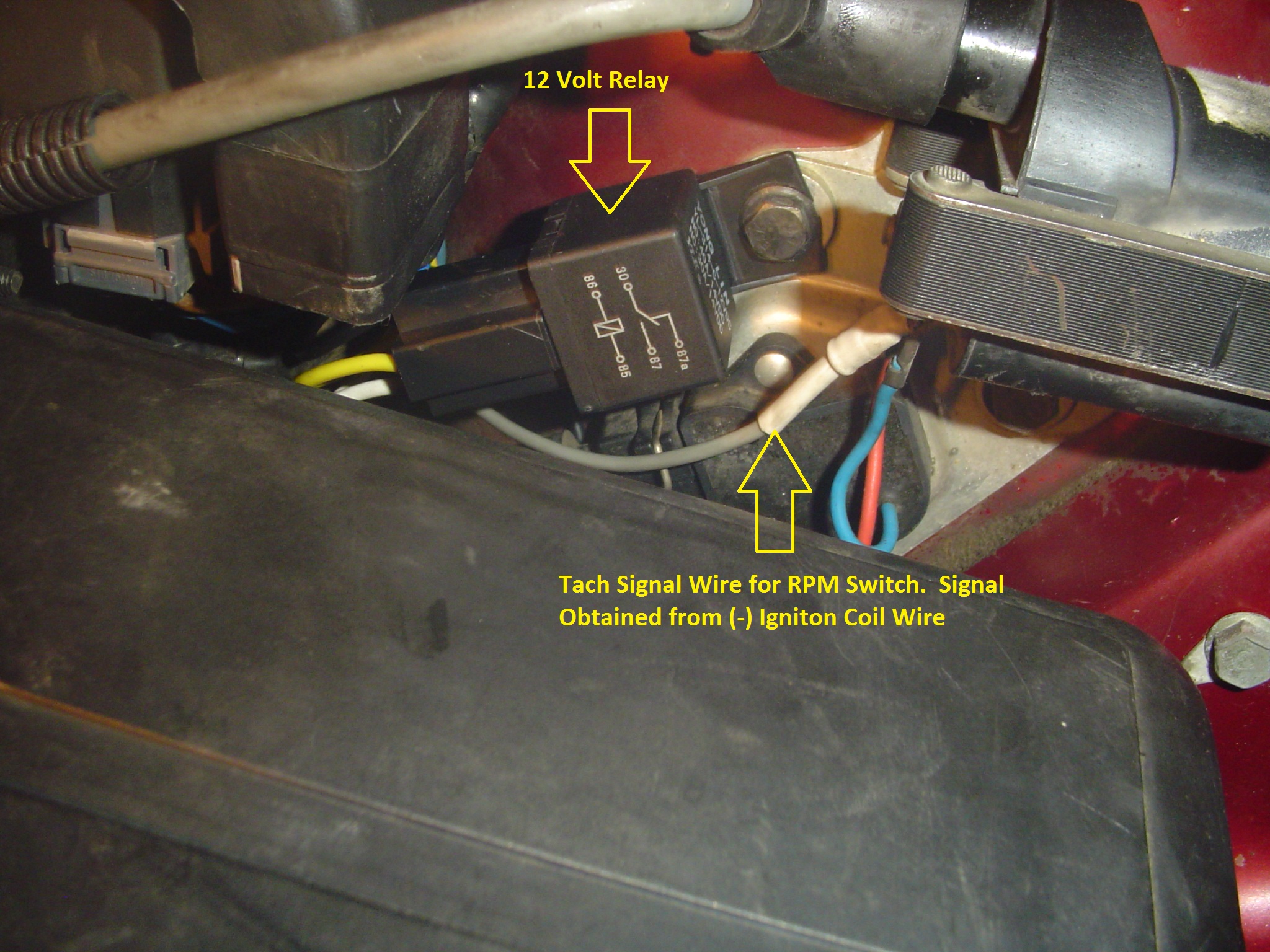

Here's the cheap eBay 12v relay that is switched off by the RPM switch. It's mounted tucked away behind the air filter box, attached to one of the bolts for the ignition coil mount.

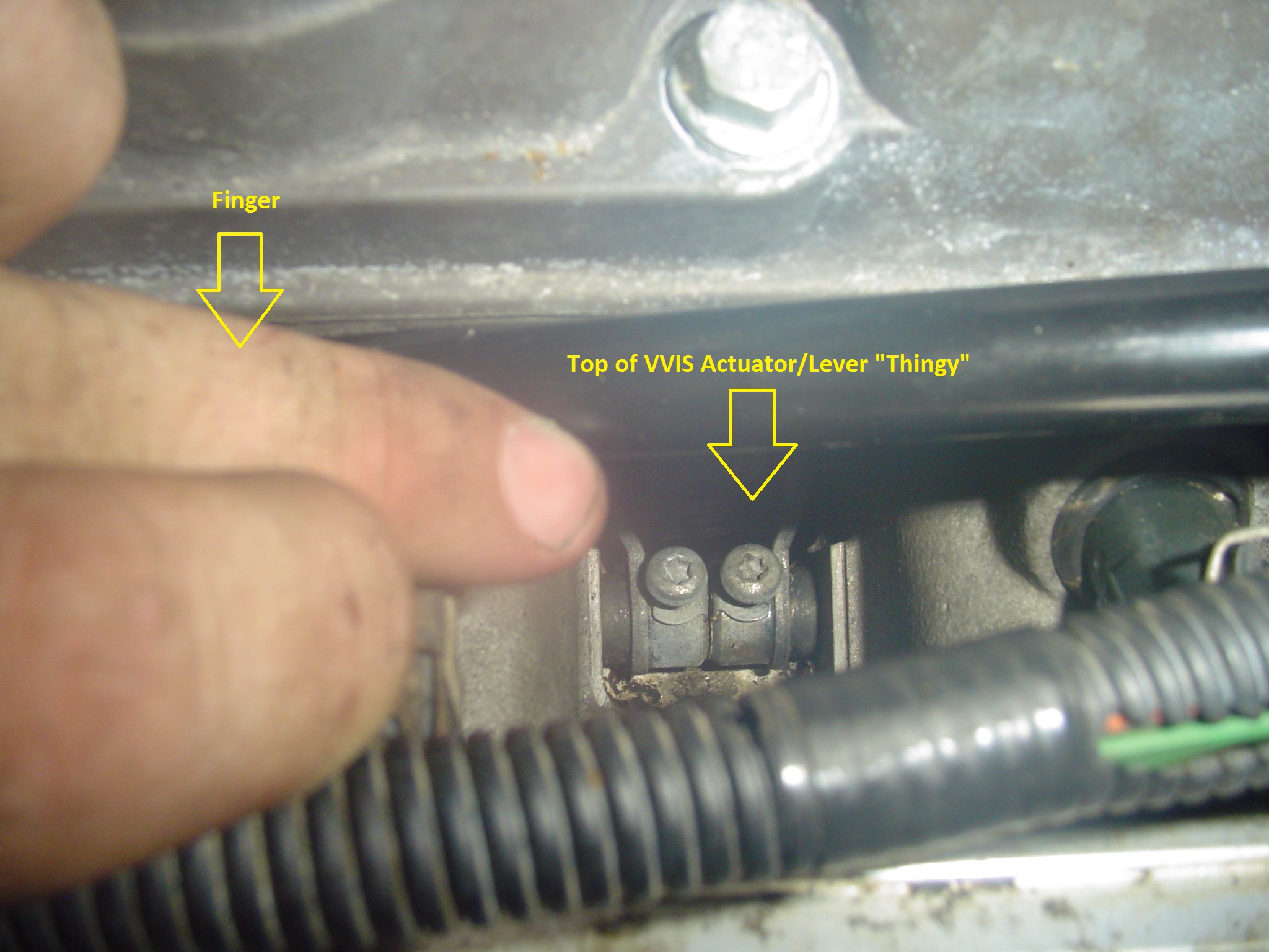

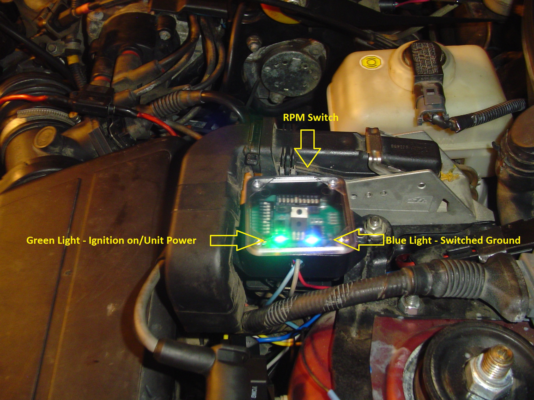

The Pièce de résistance, with out this little guy, none of this would work. The RPM switch. I mounted it up out of the way on the bracketry that the ABS computer mounts to, driver side strut tower, well driver side for those who drive on the correct side of the road :wink:.
This is a pretty neat apparatus. It's adjustable for a pretty broad range of RPMs and can be set to either turn something on or off at a determined RPM. I of course have it set to turn off at 3700 RPM, this RPM was determined based on my finely tuned "seat-of-the-pants" dyno :lol:. The RPM switch is calibrated for use on 4, 6, 8, and 10 cylinder engines, the Volvo 5 cylinder gets no love. I originally thought I'd set it for a 10 cylinder and multiply by 2, but my theory wasn't panning out. I wound up setting it for a 4 cylinder and began trial & error testing. Turns out that set as a 4 cylinder and to turn off @ 5600 RPM is about 3700-3800 RPM according to my car's factory tachometer. I know there's some error/variability in both the switch and factory tach reading, but at least I've got a base line to go off of. The green LED comes on to show that the switch is receiving power, and the blue LED let's you know if the switched ground for what ever you're controlling is open or closed, i.e. blue LED on the switch is closed/on, blue LED off the switch is open/off.
When all is said and done, and working, the only thing you can actually see happen, is the very top of the VVIS actuator lever arm moving in and out down in between the intake runners for cylinder 3 and 4. Boy when it moves though, and does so when and how you want it to, it's a good feeling 8).

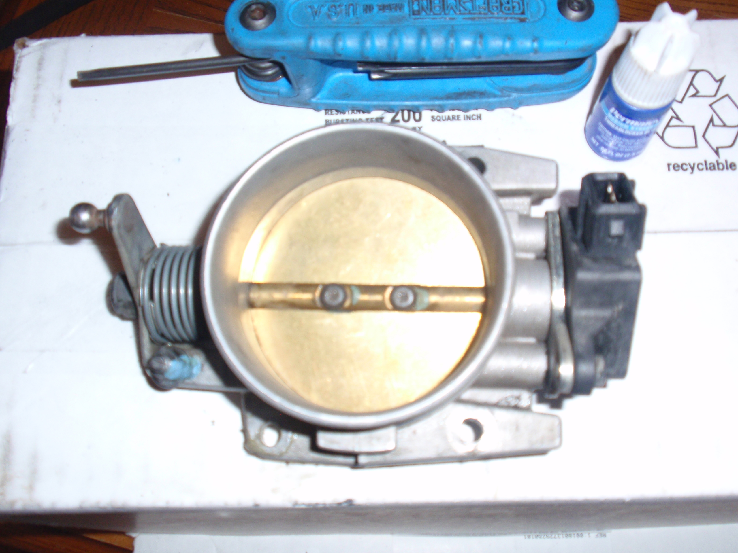

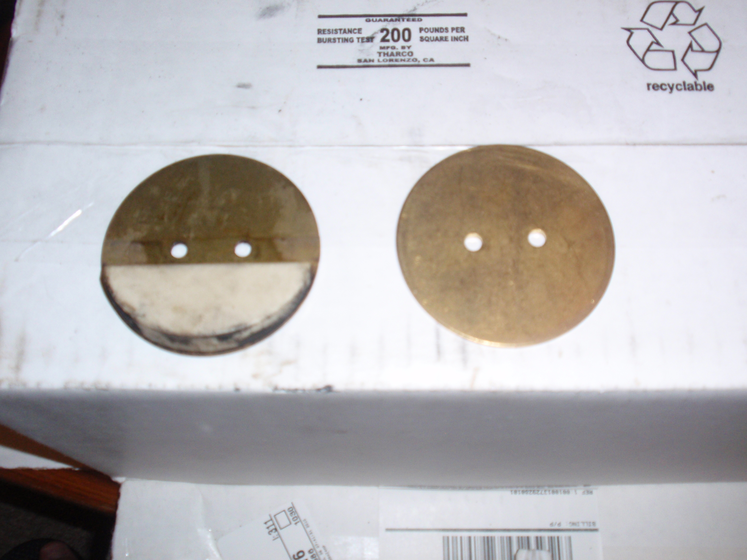

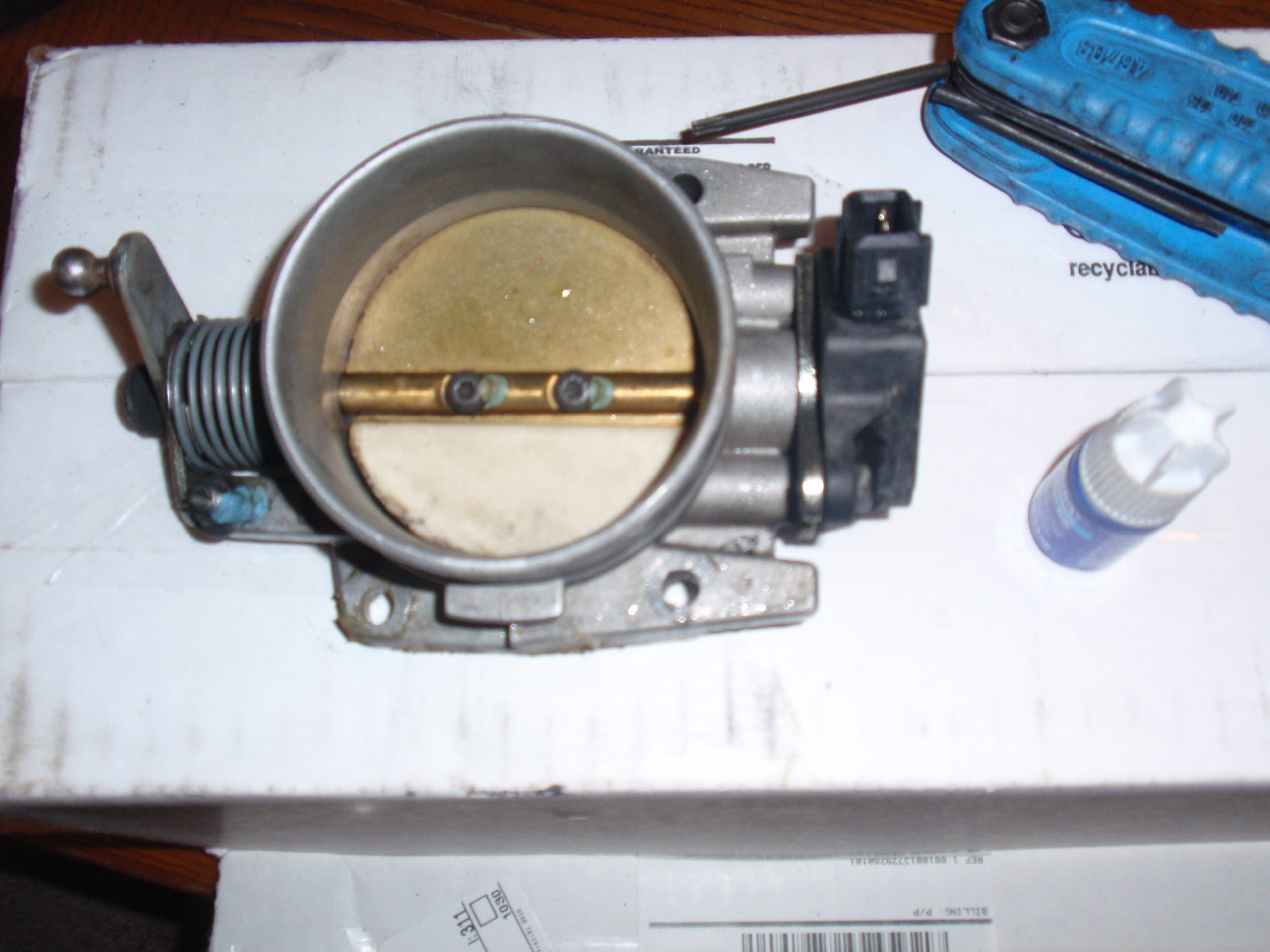

I should also add that not only did I get my VVIS working, but I did this too:
So, I don't know if I benefit more from the VVIS, the 960 throttle plate, or a pretty even combo of both, but I do know that gunning it in a right turn from a dead stop at a light, with the trans in "sport" the tires let out a little chirp, never had them break loose on dry pavement before. I tried to recreate it a couple of times in straight aways between stop lights, but no dice.
