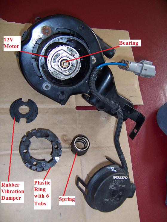

This issue of bad Air Pump has been discussed hundreds of times here. Usually the Air Valve fails, allowing exhaust gas to enter the Air Pump causing damage to it. In the early phase of failing Air Valve, water from exhaust damages the bearings, so change the bearings (x2) ASAP.

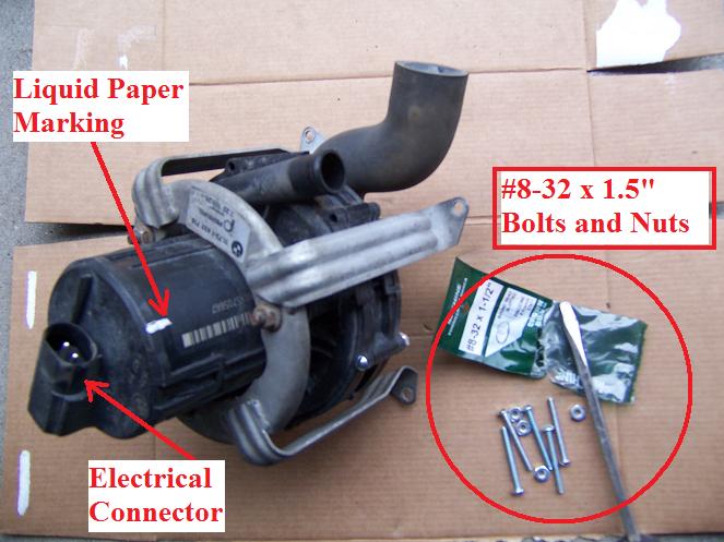

- Nuts and bolts to replace the rivets that you drill out: #8-32 x 1.5 inches long nuts and bolts. You need a total of Six (6); hardware store sells this package for $0.99.

2. Once you have the Air Pump out, Take your time to go through all the steps in the pictures below.

- Use white out paint to mark alignment of Air Pump housing to make re-installation easier (don't you want your life easier?...)

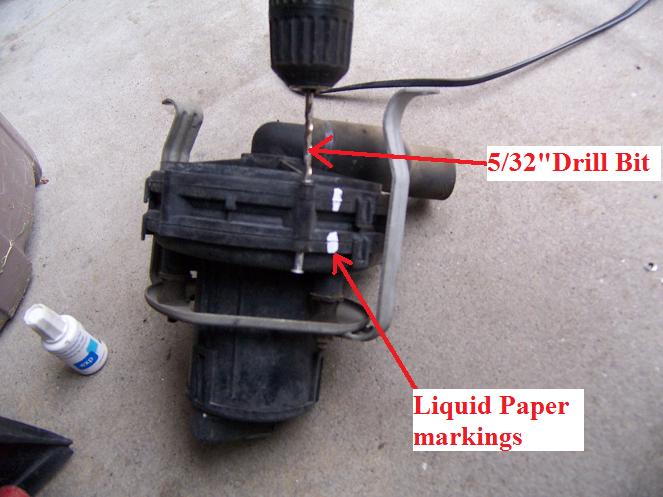

- To drill out the Six (6) rivets holding the Air Pump, use a 5/32" drill bit, the rivets will come out nicely.
(The pics show drilling comes from my 1998 BMW 528i, which also uses a similar Pierburg Air Pump. Shown here for illustrative purposes).
- To re-install, use #8-32 x 1.5 inches long nuts and bolts as mentioned above.
- Use Loctite. After the nut is tightened (don't over-tighten the nut), I use a pair of vice-grips and crimp the protruding threads on the bolts to prevent the nuts from working loose; kind of locking the nuts in (I did trick on my Volvo one year ago and the nuts hold tight).

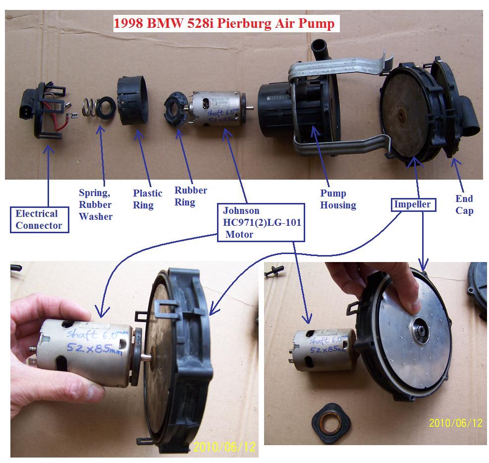

- I opened the Pierburg Air Pump and did an autopsy on it.
The Electrical Motor is Johnson HC971(2)LG-101.
I contacted Johnson Motor and they only sell this motor to Pierburg and not to the public:
http://www.johnsonelectric.com/mediando ... roduct=604
Spec for Johnson HC971(2)LG-101 is:
Size: Diameter 52 mm x Length 85 mm: shaft Ø 6.005 mm[/b]

For those of you who want to see the anatomy of a typical Pierburg Air Pump, here it is from my 1998 BMW 528i, other European cars similar. I just took the picture today. You can see that the motor shaft is 6-mm and is press-fit into the impeller. So with some WD-40 the day before, vice-grip on the stub of impeller and a 5-mm drift, you can tap the motor out:
