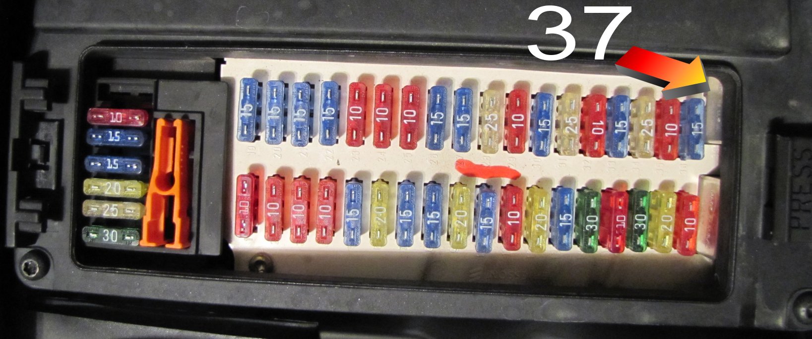

At this point, you'll be able to reach the plug-in circuit breaker in "Location 37".
See that metal can next to the 15 amp fuse in # 36?
There ya go! :mrgreen:
