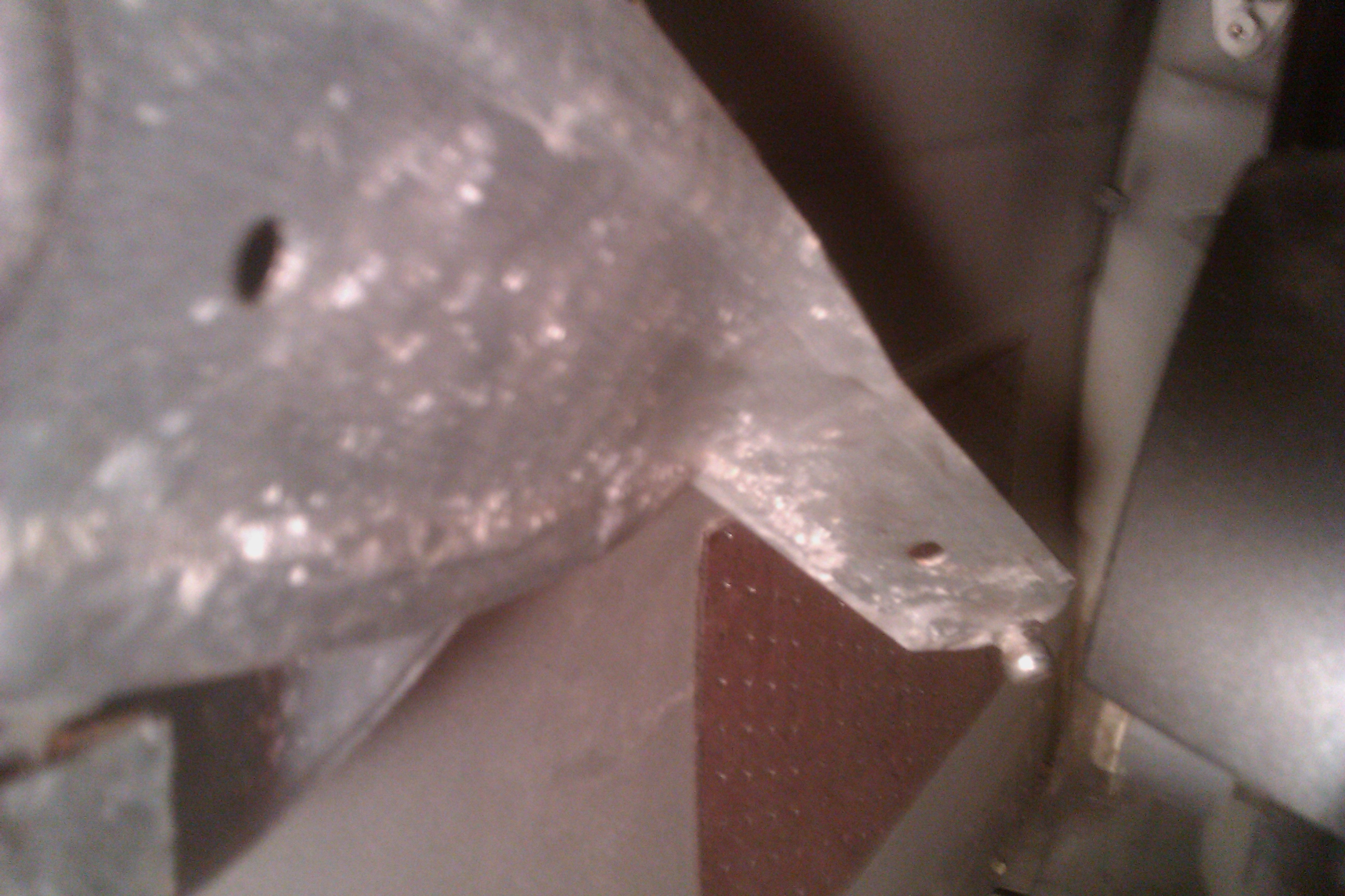

You can either bend it back and install the new slider or replace the whole regulator. You'll need a special longnose riveter to replace the regulator.black01s80 wrote:Glad I found this post! I got the door apart and figured it to be an easy fix as I saw the exact same thing on the rear pin. However, I looked to the front arm and pin and saw this. How does this happen and how can I even replace this?
