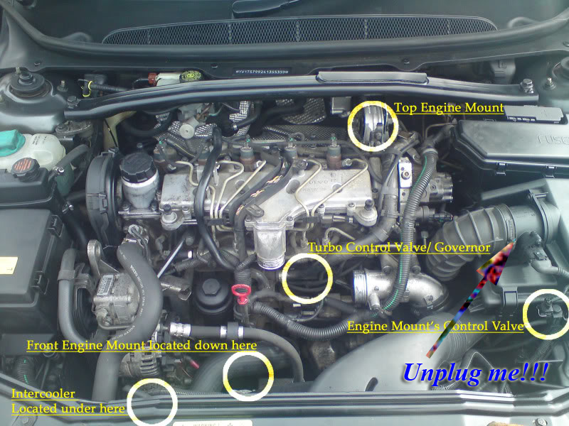

Modern diesels do have some method of metering air - though I don't think they care much about the result of the burned fuel, thus your car not noticing that the exhaust is so rich.
I found this picture online. Here's the mass airflow sensor. Quick test - unplug it and go for a quick drive and see what happens. Your car may not run at all with it unplugged; I don't know how these will react. You will throw a check engine light for sure, but it can easily be reset with an OBD tool (many parts stores here will do it for free).
You may want to head to a VW TDI forum and read about some of their issues. Not many of us have much experience with diesels, as you can tell. Though the new TDI is a fantastic engine. In a couple posts I just read, most suggest either a MAF sensor, old injectors, or a boost leak - you may be on the right track with the turbo hoses ;)
