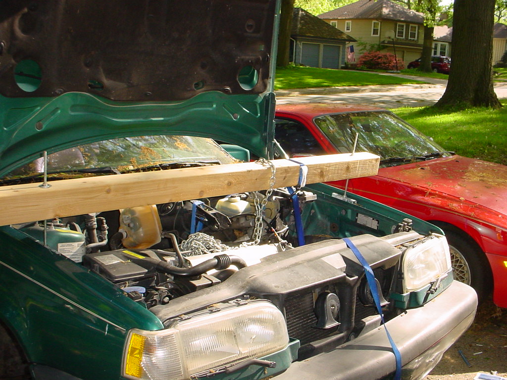

First, have you pulled the codes from port A-1? It could be simpler than a complete swap to get you on the road again.
When I put in my new clutch on the '94 I dropped the transmission out from the bottom. Either way (top or bottom) it is a bearcat of a job.
As far as the special tools go I just made my own. The big one is the support bracket to suspend the engine. I used a 4x4 CCA post and a chain.
Volvo April 29 020.JPG (228.41 KiB) Viewed 838 times
The ratcheting strap helped me to get the transmission out in a controlled manner and it also helped to get the transmission back in and lined up.
...Lee

Your ingenuity is inspiring!
So would there be any advantage to using pressure treated wood! :lol:

Thanks ozark! That gives me a good feeling about dropping it from the bottom. I have a cherry picker, so I can use that along with the wood brace hopefully.
