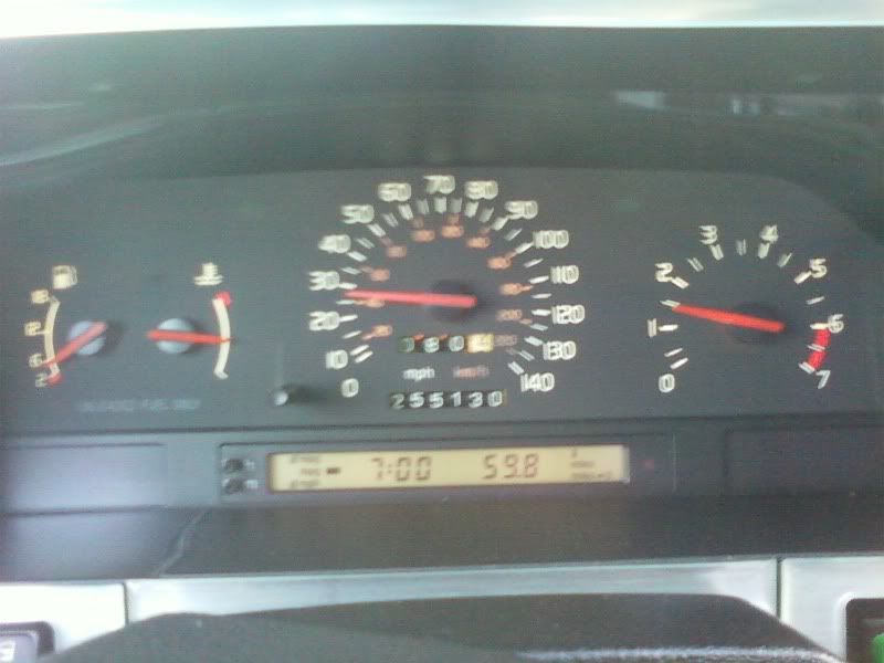

:D you can do it yourself or you can save yourself the hassle and just buy from mattymoo!
Who after installing the one he sent me, I will be recommending to anyone who is asking about them.
now my dash looks very weird/sexy/not a sight im ust to...
:D no lights on!!!!!! and my speedo/odom is working again.
haha now off to get an o2 sensor and fix the broken dash clips... and the car will be perfect.
