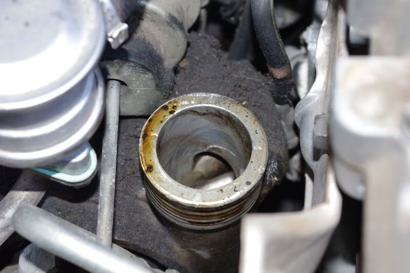

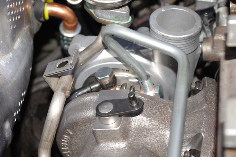

Yes, yes there is. I would say fairly simple, but not incredibly simple. I cleaned mine and started to reassemble it, but then decided to take it to a turbo shop for final reassembly. I watched the guy put the compressor housing back together. The first thing he says is "You bent this piston ring here. If it gets bent even a little bit... not good." Someone putting together their first turbo is not going to realize that they may have bent the tiny piston ring inside oil deflector/flinger assembly, which is inside the compressor. We're not talking majorly bent here. If the two sides are off at all it can be a problem.boosted5cyl wrote:Theres a lot of BS talked about turbos. They are incredibly simple devices. They have tight tolerances yes, but are very simple.
Yeah you can, but they're garbage. I looked there, ended up buying some at Sears. Those were barely useable as well. The pros use the good Knipex style ones... two different sizes, small and extra large. In any event, I'd say a proper rebuild of the turbocharger system is going to cost a lot more than $50 and a lot less than $1,800. Of that I am certain.boosted5cyl wrote:You can get a set of circlip pliers needed for <$20 at harbour freight.
If you want to go from this
to this....
it's a lot of work.
