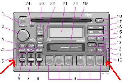

Hello,
How do I remove the radio from my 2000 s40?
I need to check the serial number to obtain the access code to enable it. The code provided by the dealer does not work.

If you have the SC-813 or SC-816 press in and release the two parts arrowed in the attached. They will pop out far enough for you to pull on them and the radio will follow. When you replace the radio push the two buttons in to lock it in place.
