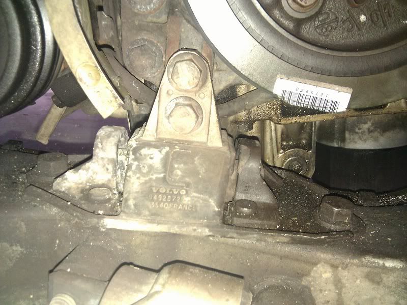

Well after rechecking the passanger side engine mount. I think it might be the cause of the issue. I did a torque shift test and could see that the mount would move a little bit but not alot like my failed upper torque mount.
Here are some pictures of the mount.
I compared them to pictures that I found on this site http://rides.webshots.com/album/575531214sCDurR and from what I can see that the ends of the mount have deteriorated quite a bit.
Do you think that could be the cause of my issue?

Post by RaymanSean »
Yes, it could. No harm in replacing an obviously bad part in hopes it helps/ solves your problem.
