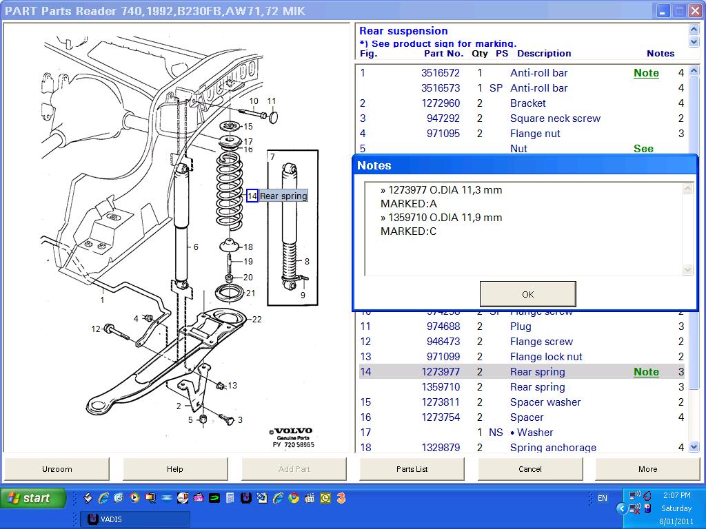

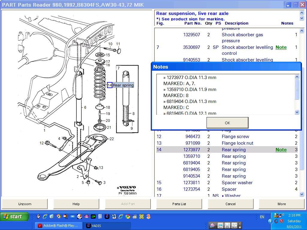

Bill does this look like IRS to you? My own 93 960 wagon is LIVE also
My VADIS v6.7a.2775 shows the wagon as LIVE as in the photo below ( I selected the body as 5DRS S.R):
This should be the case until 95 when all wagons changed to IRS. Vadis also reflects this. Sedans or saloons (isn't a saloon where you buy a drink, play poker, watch a gunfight and drool over frilly can-can girls?? ) had IRS always.
I have read somewhere there were only 43 960 wagons imported into Australia. Does this mean I should consider myself lucky??

To further complicate things two different spring diameters were offered for your model as per the pic:
My VADIS shows the 92-93 960 wagon model live axle uses the first two part numbers as well .
Those springs on eBay are looking more like what you need by the minute.
- 740 92 live axle.JPG (135.61 KiB) Viewed 5280 times
