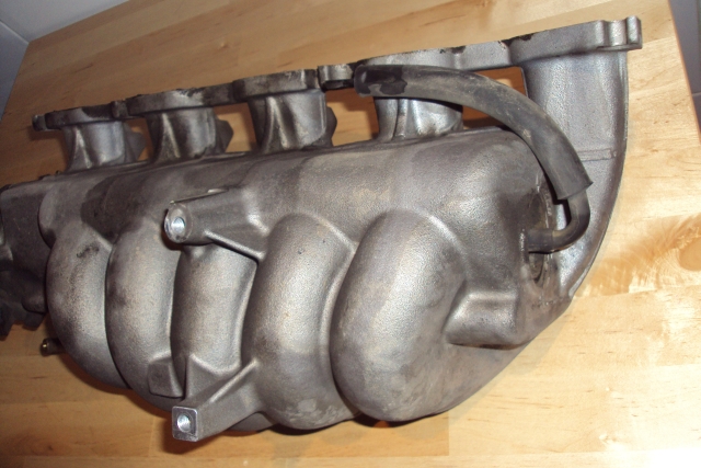

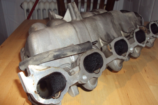

Hi I´m new to this forum and would like to introduce myself. My name is Antonio and I live in El Escorial which is located in Madrid, Spain. I have owned a ´98 V70 which runs +200K km at the moment. I have read some very detailed and interesting tutorials about PCV replacement in this site. My doubt has to do with the vacuum hose that runs from the side of the intake manifold. When I took apart the manifold I noticed that this hose was not connected to any other hose. Is this supposed to be like this? Or is this hose conneted to another hose that runs from the flame trap? I´m not sure if this is what you are talking about. I´m including to pictures of my manifold specifically showing the vacuum hose.
Thank you for your kind attention. I look forward to your reply. Regards, Antonio.

Antonio, that hose connects to the intake air hose down by the turbo.
The small plastic hose becomes brittle with age and breaks easily. It runs under the intake manifold and connects by rubber elbow to the intake air hose nipple down by the turbo. You'll probably find the other broken end when you get to that area.

Thanks a million for your quick reply. My model however is non turbo. Does it make any difference? Thanks, Antonio.
jda2000
Posts: 584
Joined: 1 April 2010
Year and Model: 04 V70 2.5T 01 V70T5
Location: Sarasota, FL
Post by jda2000 »
alphahotel wrote: My model however is non turbo. Does it make any difference? Thanks, Antonio.
I have a '98 V70 turbo, and I don't know where the hook up for the turbo would be. Sorry.
It's at the flame trap near the throttle body. I'm going to split this off from the 2001-on section and move it back to the 93-2000.
