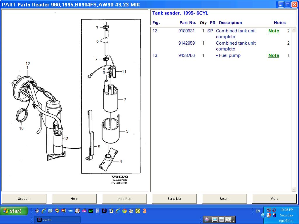

I get part number 9180931 for 95/96 model 960 6 cylinder.
If I enter this number into Volvo Wholesale Parts (one of the site sponsors) Volvo Dallas I get $289.90
This is for a separate sender without the fuel pump.
If it were superceded to include the pump I would have thought this website would show the change.
Give them a call. 1-866-597-3891

- 960 sender.JPG (89.47 KiB) Viewed 2012 times

Thanks a lot for your input so far. I am still amazed that our mechanics (former Volvo dealer mechanics) said I have to replace both the sender and pump even though the pump is fine. It isn't their fault if Volvo forced this change, but want to be sure we cant get a sender without the pump. I will call the number to check sender pricing and availability. Since this is my daughters car now, I dont want to think she has to calculate the fuel level for the next few years with odometer (her last car odometer died but we fixed later thanks to Matthews posts!) but I think the Techron option is a great idea since it could be due to underused and sticky float. I am still open to new ideas. Thanks again!
