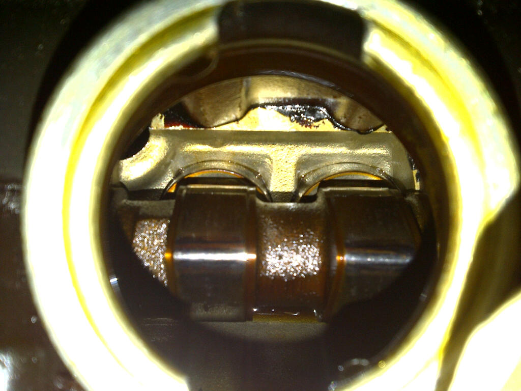

Here are 3 photos: foam on the dip stick, foam up the tobe, and inside the engine (camshaft) from the fill cap.

These photos were taken when the engine was cold. I drove 1/2 hour on the highway, then shot these photos 8 hours later.

It looks like condensation. I say this because I can see some normal unfrothed oil in the cam area.
Is there normal looking oil on the end of the dipstick at the measuring marks?
Was it any better after that drive? Is your temperature guage sitting on the halfway mark and does it stay there during trips?
Incidentally what type of oil did you use?

yes there is normal looking oil at the bottom.
The temperature guage stays in the middle to colder-side after the engine has been running.
The oil was a 10w-30 kendall. Is there an oil you recommend for high mileage engines?
