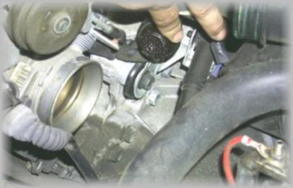

Yes, the flametrap is located in the intake elbow. You should unscrew the cover of the throttle body. I would then pull apart the air intake hose and move the air intake elbow lightly to detach the flametrap component by twisting it I believe clockwise. You can then pull the actual flametrap by using thin tweezers or the like and replace. It is a really cheap component.
Here is an image I found on internet where you can clearly see the flametrap which is the component held by the hand.
However I think your problem might have more to with an oil trap or PCV system in need of replacement. There´s good instruction in this site on how to proceed. Check the repair database.

To expand on the picture, the flame trap is located below the bayonet mount that has the PCV lines. It takes about 1/8th of a turn to release it. Most of us just take the thing out and throw it way.
