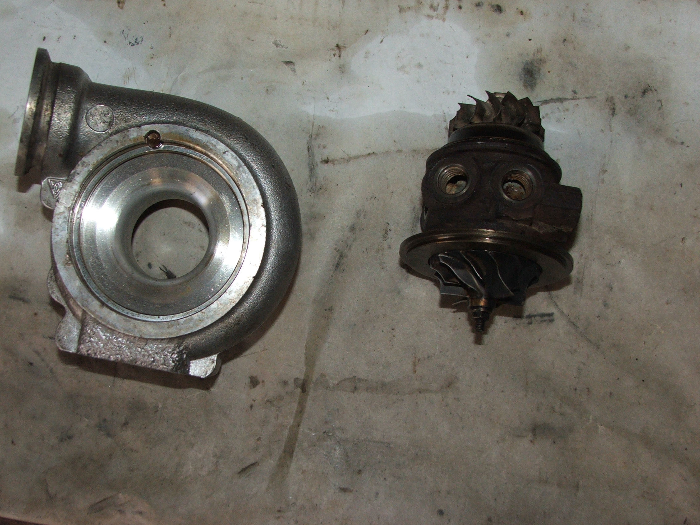

Panic time: Turbo #2 has evidence of the wheel rubbing the compressor housing. ##it!
Turbo #2's CHRA (Center Housing Rotating Assembly) and compressor housing separated for inspection.
Compressor side of turbo #2. When I check the axial and radial free play it all came within spec. Writing on the CHRA and the different type nut on the wheels compared to #1 lead me to believe that it had already been rebuilt and the contact with the housing happened before I owned the car.
